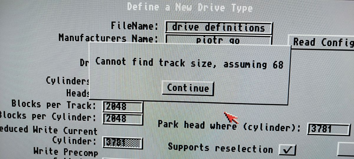

    Pay no attention to the old HDToolbox. It does not support larger disks and displays silly things.
    Preferably create partitions in the new one. Alternatively, in the topic about DIY 1.6 there is an image of the card with DOS. Burn to the card and under DIY you will have a 2GB amiga disk and on it 2 partitions.

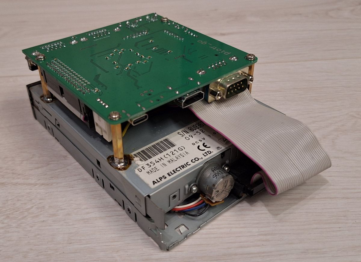

  • #189 21066468
    xangel
    Level 19  
    Posts: 543
    Rate: 147
    piotr_go: with me also helped this SD patch for all problems with Amiga. Bravo!

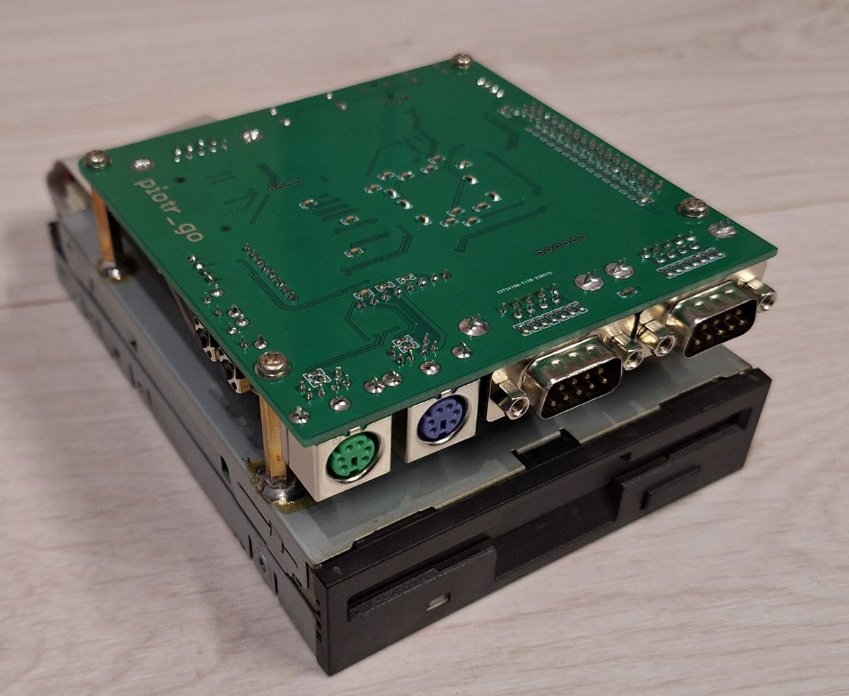

    On the other hand as for the RISC core - today I receive from the packet of 5ns memories so I will replace and everything will be known.
    I'll definitely let you know.
    I'll just boast - after replacing the memory with 5ns everything works as expected. The RISC core has started to laugh, DOOM is running (without voice), the MP3 player is working.
    I attach pics of my Frankenstein :)
    Close-up of a custom computer hardware setup with a circuit board and various ports. Image of a modified floppy drive with an attached green circuit board mounted on standoffs.
    Now I start searching for a software, that will allow me to easily extract an Amiga partition in order to plug it under the emulator, drop in my files and record it back in the middle between the DOS partitions.
  • #190 21066889
    piotr_go
    DIY electronics designer
    Posts: 2905
    Help: 94
    Rate: 3337
    Super.
    Here you will find the flopp mounting tiles:
    https://github.com/piotr-go/DIY-A586/blob/master/v1.9/3D/floppy_mount.zip
    Under Linux just copy /dev/sdXX
    You can also mount the card directly in FS-UAE.
    On the Amiga you can mount a FAT partition with fat95.
    You then flip what you need between the amiga partition and the FAT on the DIY.
    (TIP: FAT16 is faster to mount)

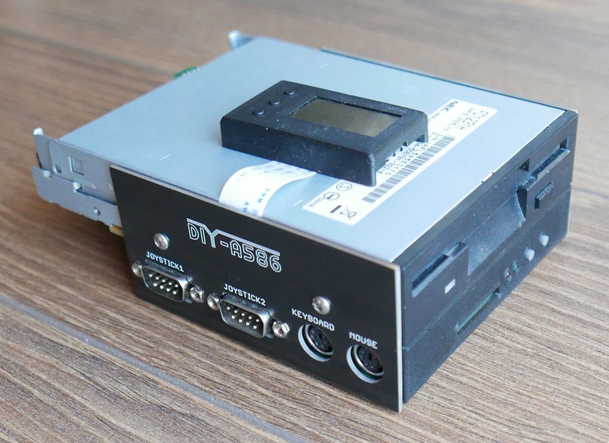

    Some time ago I ordered the panels:
    DIY Amiga adapter with joystick and floppy ports.
    Short because I am stingy :D .

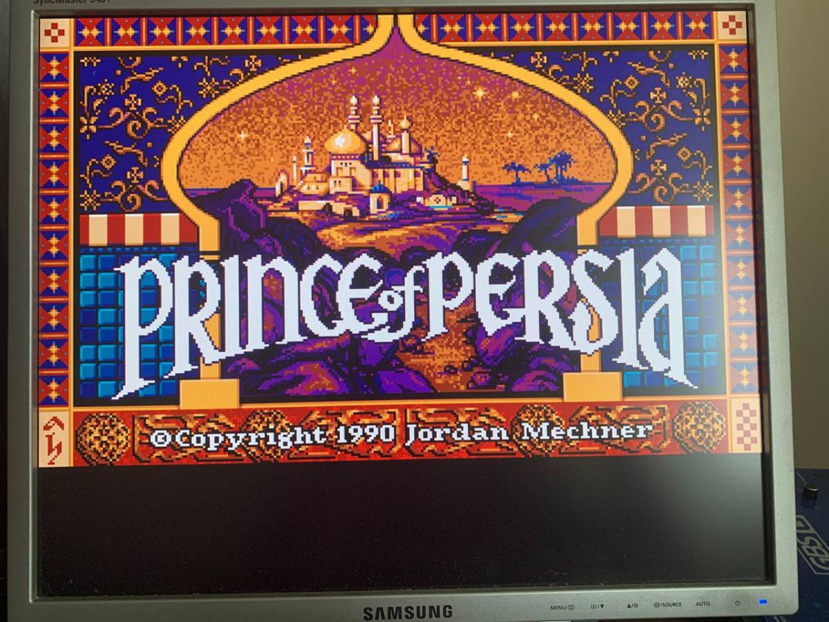

    spgstany
    have black borders on screen in amiga games
    have any solution for make picture on full size of screen?
    games on screens loaded from bootable ADF
    Amiga game screen with black borders on the sides. Prince of Persia game screen on a monitor with black borders on the sides.
  • #201 21081801
    piotr_go
    Posts: 2905
    Help: 94
    Rate: 3337
    That's how these games were made.
    To cropp try pressing "PrScr" several times, but your monitor may not accept non-standard resolutions.

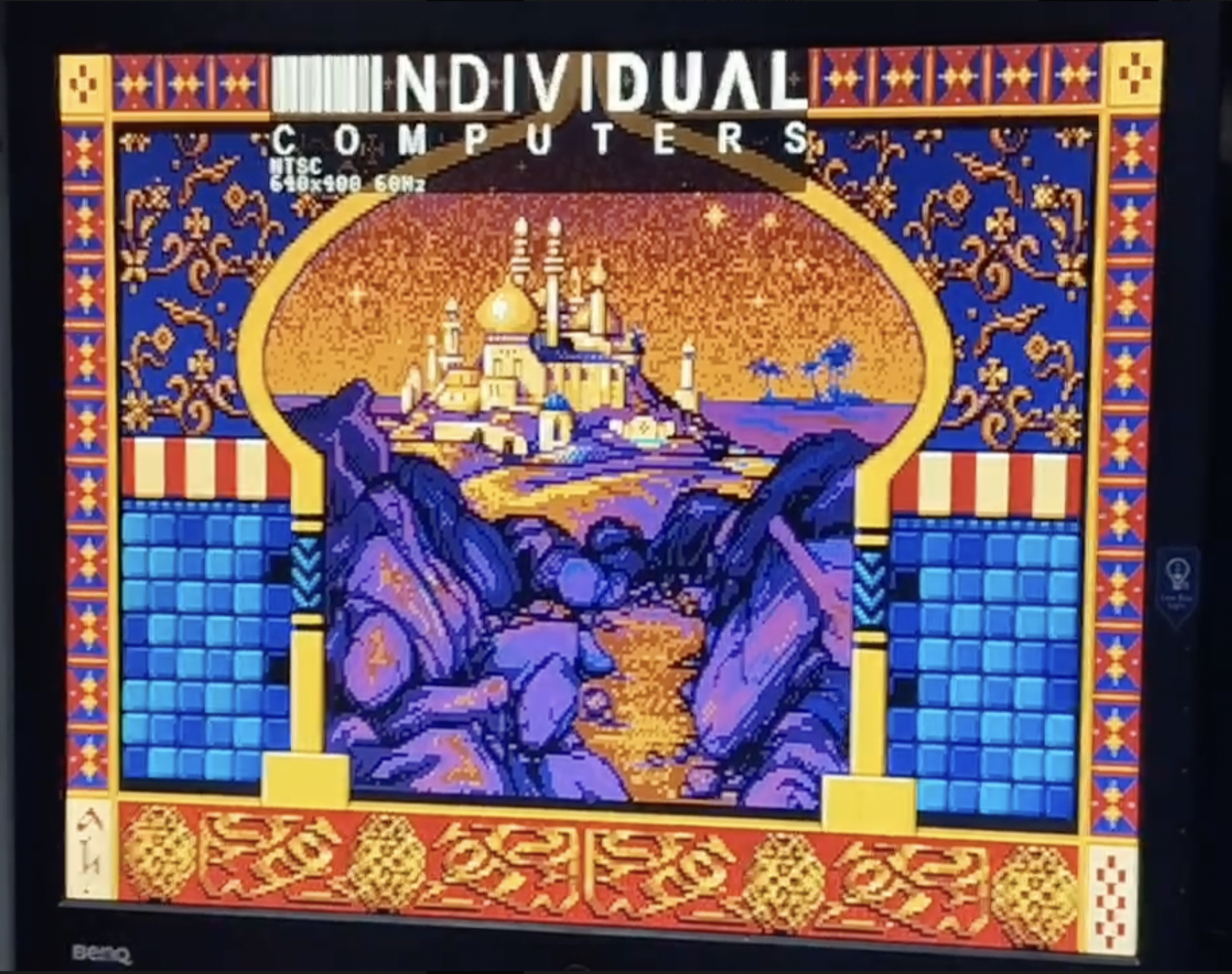

    I tried use "PrScr"
    different resolutions on diy-586 have different borders in games
    screen same game on original amiga
    Retro computer game screen with Arabic graphics and Individual Computers logo at the top.

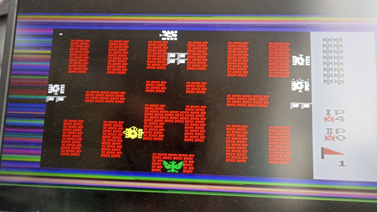

  • #203 21082231
    leonecomdir
    Posts: 35
    So the Spectrum core works on the Zxtanks games screen. Esxdos works too. All that remains is to release 8086, Amiga and risc-v doom)))) Graphic from the Zxtanks game on a Spectrum computer screen. .

    spgstany wrote:
    I tried use "PrScr"
    Aaaaaa, sorry, i forgot.
    I removed some resolutions and added interlaced modes instead.
    720x576 640x512
    288i 256i (for HDMI->RGB converter and SCART)

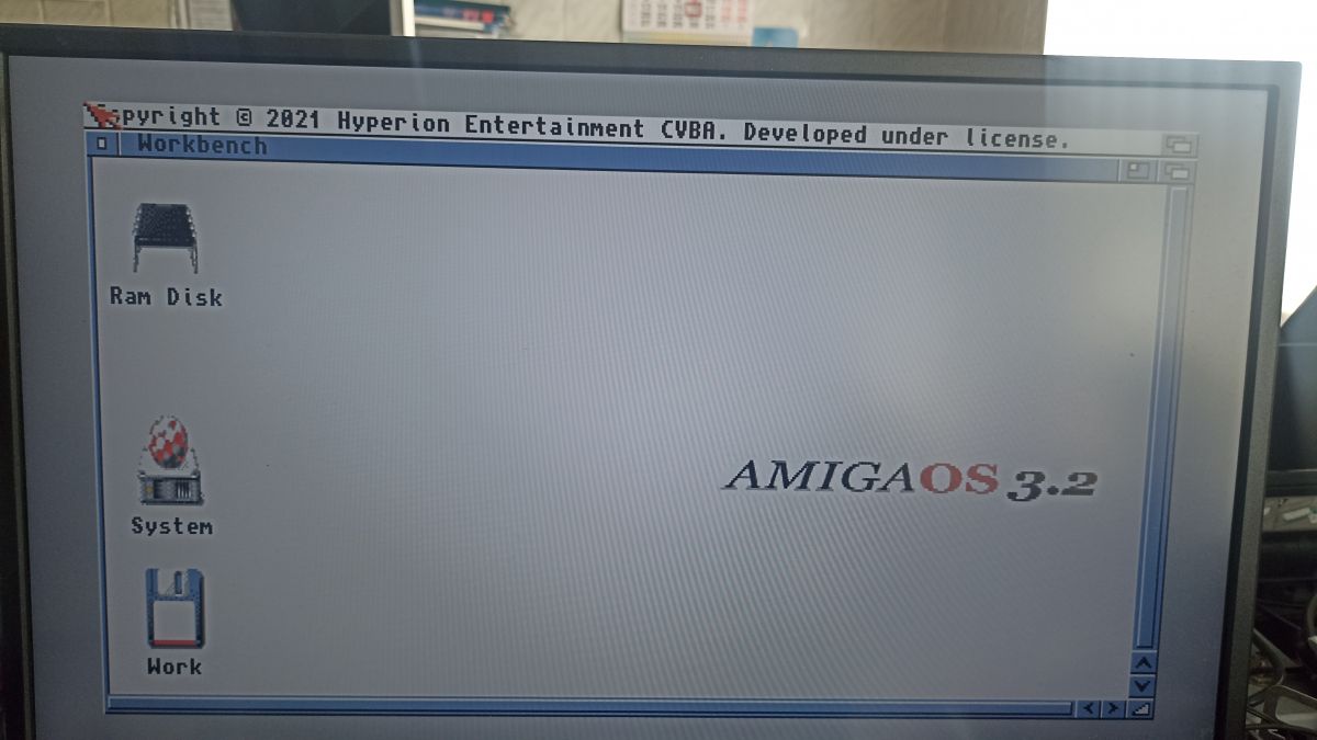

  • #206 21083432
    leonecomdir
    Posts: 35

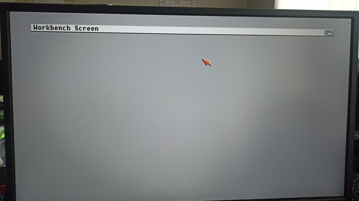

    Workbench screen with a gray background and a mouse cursor.
    Good afternoon. So far the maximum that has been achieved is the workbench screen.
    We need details on the workbench and kickstart versions. Now 3.4.1 and 3.1 (kick40063.A600) respectively. Is this normal
    Is it necessary to patch (patch) kick31.rom?
  • #207 21083506
    piotr_go
    Posts: 2905
    Help: 94
    Rate: 3337
    MD5:
    82a21c1890cae844b3df741f2762d48d KICK13.ROM
    e40a5dfb3d017ba8779faba30cbd1c8e KICK31.ROM
    33bc28d0fd88c121d09b182ff1026c5f KICK3221.ROM
    Patch not needed, just SD.ROM
    Booting from card or floppy?
    Which SDRAM did you use?
  • #208 21083711
    leonecomdir
    Posts: 35
    >>21083217
    I haven't soldered the audio connector yet)) I will try tomorrow to check
    Added after 5 [minutes]: >>21083506 Thank you! I booted from the card, followed the instructions from git-hub, tried different combinations of kickstart and worckbench and different Amiga models in the emulator (fs-uae). I gained experience, now I can install AmigaOS in the emulator in five minutes)))
    Tomorrow I will check the SDRAM model
    ps By the way, which Amiga model is closest to the mikan core?

    leonecomdir
    Posts: 35
    AmigaOS 3.2 startup screen with icons for Ram Disk, System, and Work.
    It works! I haven't checked the sound yet, but I'm running amigaOS 3.2
    Memory W9825G6KH-6I
    As kick3221 I used the roma with MD5 1d9b6068abff5a44b4b2f1d5d3516dd9
    I haven't played games yet, but all tools work normally.
