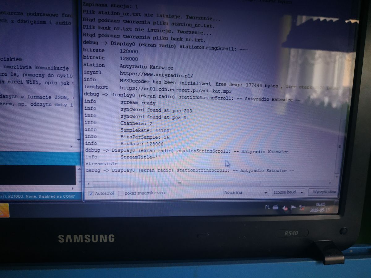

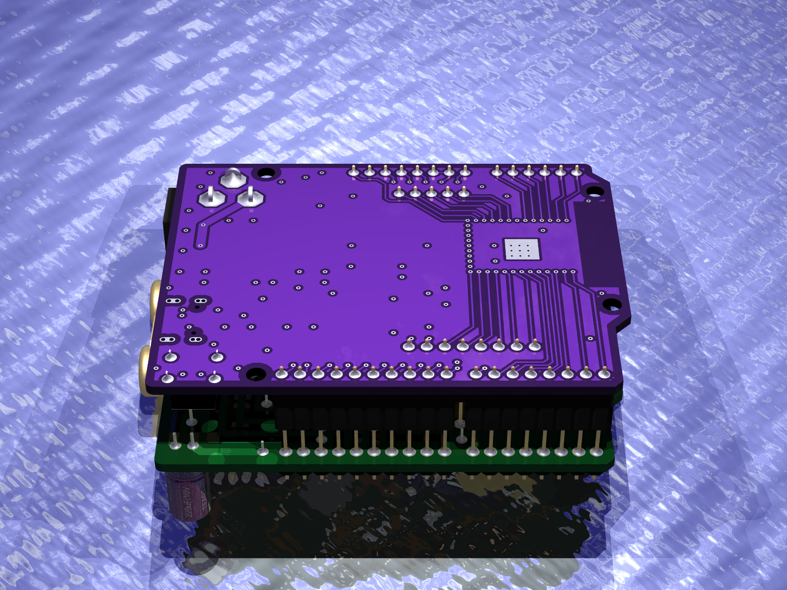

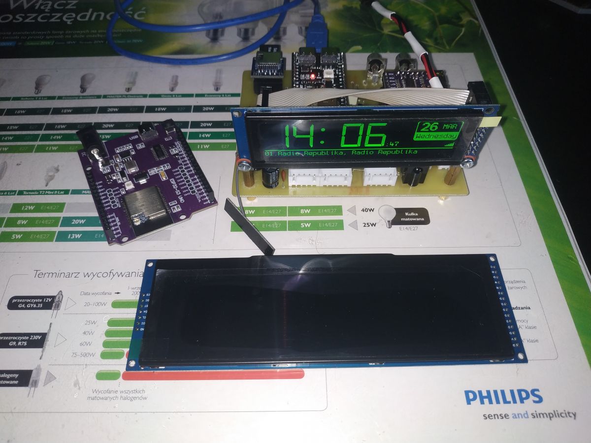

    Gentlemen I have bought a 5.5 inch OLED and an ESP32-S3 Uno
    ESP32-S3 kit with OLED display on a desk. .
    I have already designed a PCB version 2.0 as an overlay on the ESP controlled only by remote control and via the ;) page.
    This is how it will look like
    3D render of a PCB board with electronic components visible from the side.
    Close-up view of a purple PCB with electronic components. .
    This ESP alone for just over 20PLN at the Chinese is well worth it. For commissioning you need the CH341 controller, besides that the code of the colleague Robgold is loaded onto the board without any problems.
    After uploading and configuring the hotspot, the radio on the ESP alone starts 😀
    This is evidenced by the log in the serial monitor.
    Screen capture of debugging logs on a Samsung laptop monitor. .
    Cool radio will be for the workshop big OLED + this ESP.
    The only thing is that there is no resistor 0 from the RGB diode and you will have to get rid of it eventually, because it gives the eyes.
    Best regards...
  • #1037 21496569
    DJCheester
    Posts: 2049
    Help: 75
    Rate: 949
    Board Language: polish

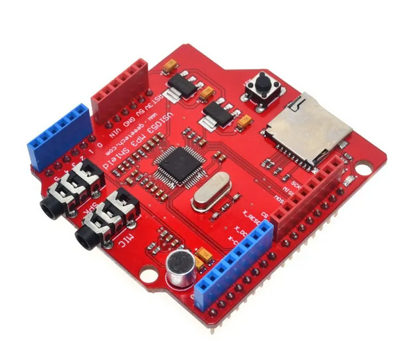

    So there is a converter and sd ?
    Well, but for our radio it's not going to be useful anyway, there's no way to rig it up yourself and connect it.
    Greetings ...
  • #1038 21496617
    rysin
    Posts: 56
    Rate: 10
    @DJCheester There's a whole audio player in there, only communication is via SPI. Practical Electronics have made an internet radio out of this on their board of course, along with the ESP32S3.
  • #1039 21496633
    hevet
    Posts: 346
    Rate: 47
    Only on this overlay is the VS1053B codec, not PCM5102, useless for this radio.
  • #1040 21496654
    rysin
    Posts: 56
    Rate: 10
    Under this programme it is certainly not suitable.

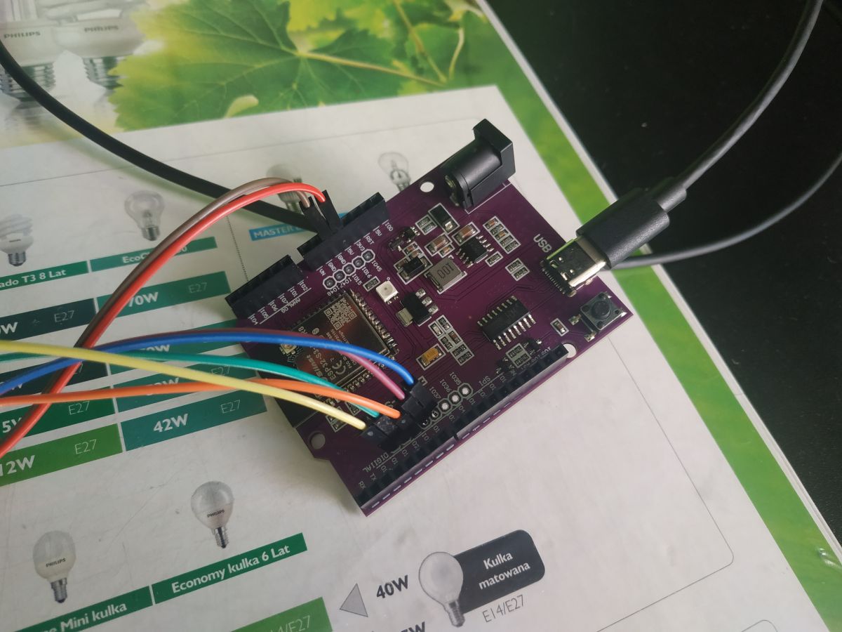

  • #1043 21498949
    DJCheester
    Posts: 2049
    Help: 75
    Rate: 949

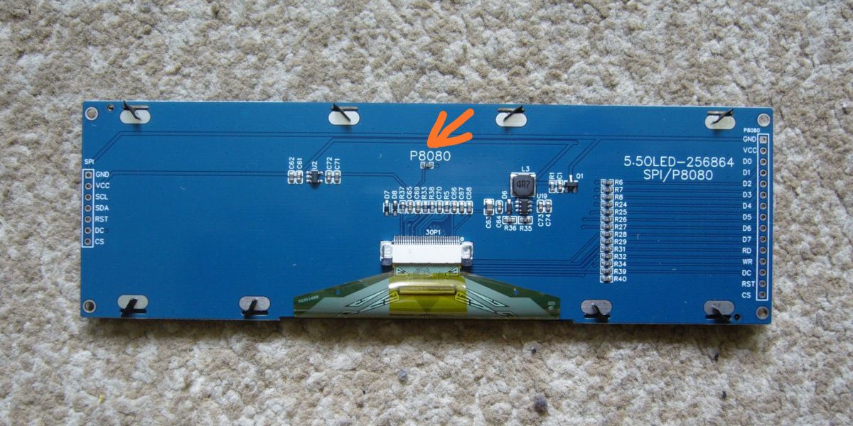

    Hi you can buy this large OLED, you just need to remove the 10k resistor marked below to run the OLED in SPI mode
    OLED PCB with a marked 10k resistor to be removed.

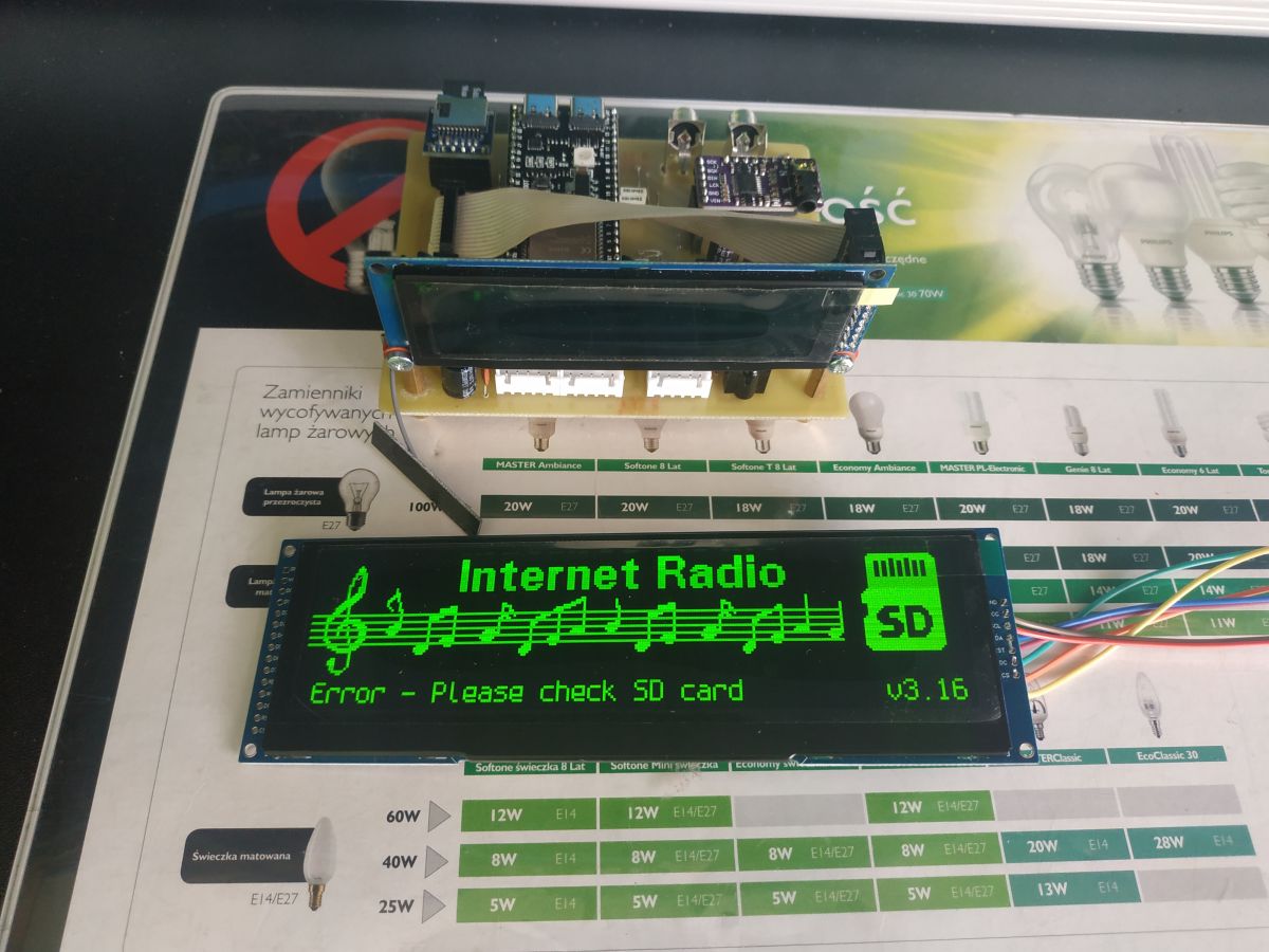

    I have connected the display to the programmed ESP S3 UNO
    ESP S3 UNO board connected to various cables and USB power.
    Radio running in cardless mode.
    Electronic setup with a large OLED display showing an SD card error message. .
    Two OLED displays, one larger and one smaller, connected to an ESP S3 UNO microcontroller on a table. .

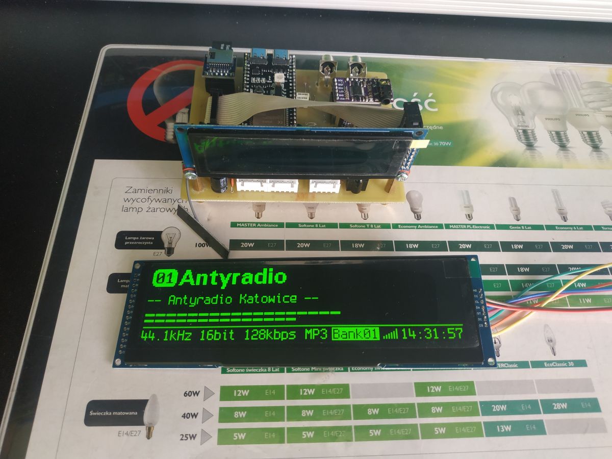

    For comparison, my previous radio in pictures with OLED 3.12
    The display was a bit expensive but I think it is worth it.
    Same resolution so up close a bit big pixels but in my case the OLED will be installed high up so from a distance it will look nice.
    It's on the same driver as the OLED 3.12 so nothing in the code needs to be changed just connect the pins correctly and the 5V power supply.
    Regards...

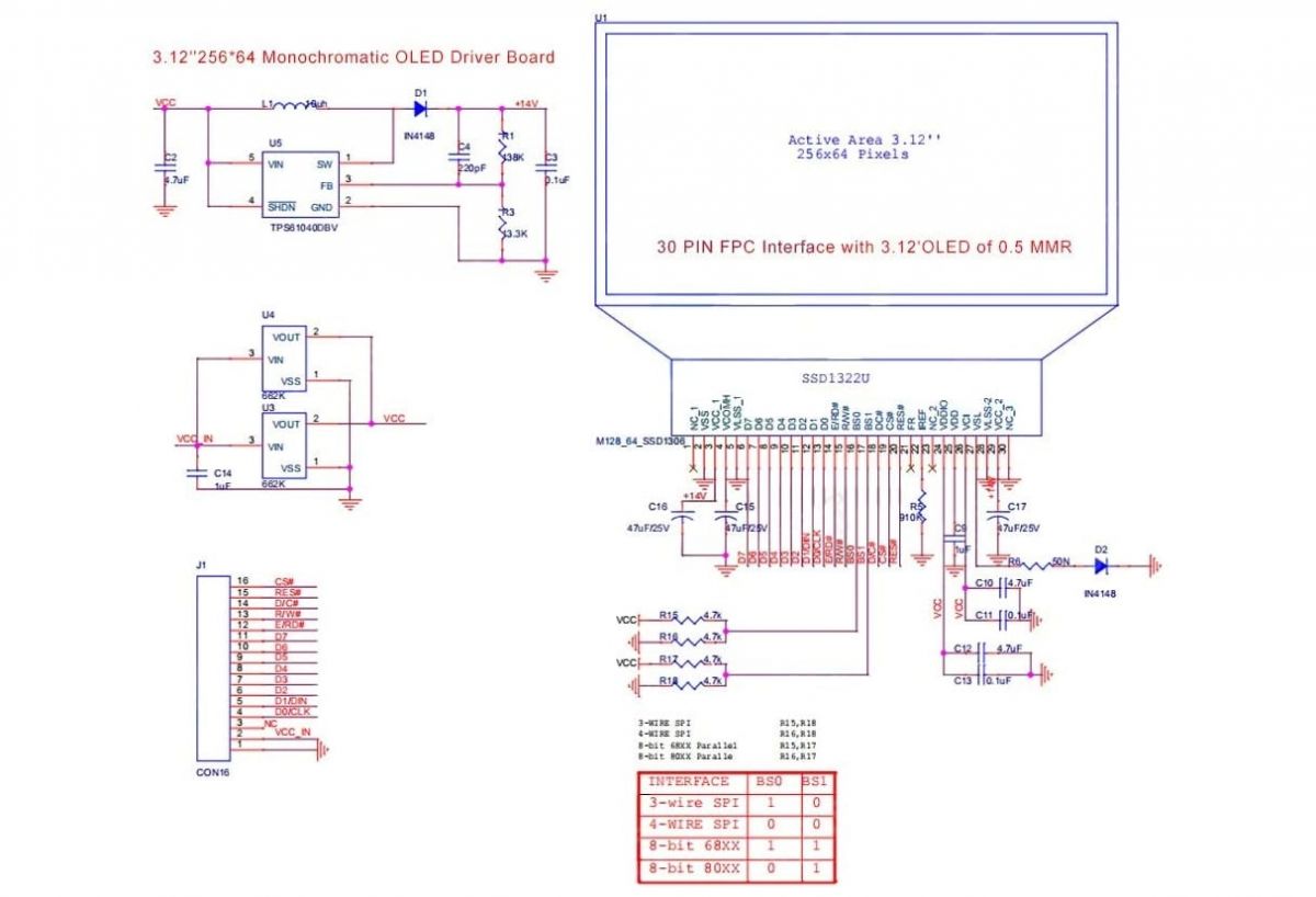

    Here's what I'm wondering... Why would anyone need such a large display in such an application?
    By the way, does anyone have a datasheet for this 3.12"? I can't find any that make sense, and the ones in the auctions are only cursory and poorly readable.

    Well you need it because it will be viewed from about 7 metres and that's why the version of the radio being made now has no encoder just ir and Web for control.
    I have the datasheet and schematic on my computer I will look for it and send it when I am at my computer.
    Regards...
    Added after 17 [minutes]: .
    Schematic of the board from the OLED here
    Diagram of a 3.12 inch OLED board interface. Drawing of the board from the OLED here.
    The display itself, on the other hand, is here
    https://docs.rs-online.com/6267/0900766b8162af09.pdf

    @DJCheester Thanks. I think I can handle it now.
