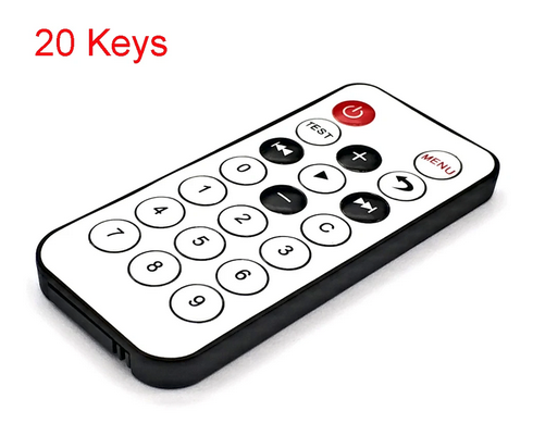

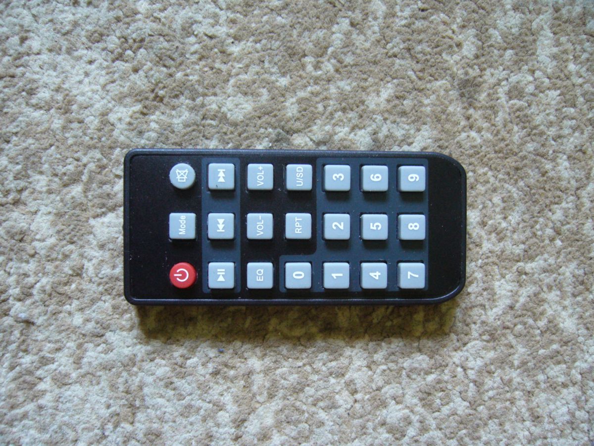

    Hi these remotes are quite perishable, intensive use will shorten the life of these buttons.
    I personally prefer rubber bands
    Remote control with buttons on a brown background. .
    For this radio I specially bought this set
    https://pl.aliexpress.com/item/1005007046071152.html
    And I assigned this remote control to the radio, it transmits in the NEC standard.
    Greetings ...

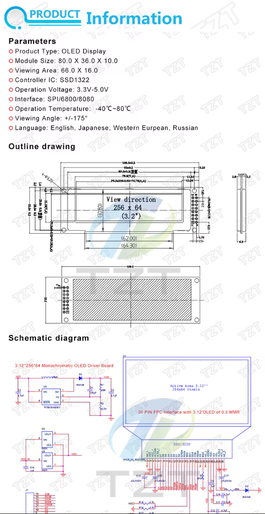

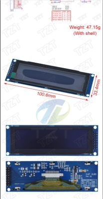

    @Slawek K. I will generally agree with you that OLED type displays used to be pretty much perishable. Often, after time, not even burn-in but simple degradation or unsealing threatened them. However, the last few years have brought some progress in this matter. Exactly the type of OLED we have under the name "3.12 inches" has been used successfully by Denon/Marantz in their network players for more than 10 years, and I have not encountered equipment on OLX in which this display would be burnt out or damaged. In addition, in our case the inverter works on 14V while Marantz equipment "chases" this matrix with an almost maximum voltage of 18V.
    We'll see how long it will last in such a radio playing a few hours every day. I am curious myself and intend to check it out.

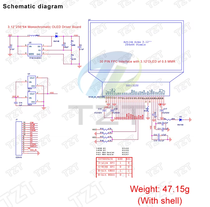

    @ArturAVS
    Datasheet in picture form from Alibaba. You can find the SSD1322 driver itself on Google.
    The image shows the technical specifications of an OLED display. .
    3.12-inch OLED display with technical details. .
    Schematic diagram for a 3.12-inch monochromatic OLED display. .

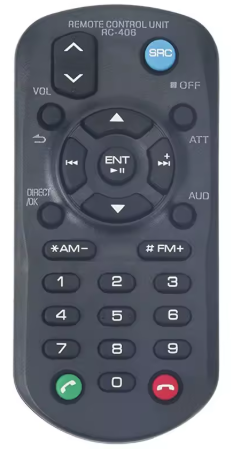

    I would still recommend Kenwood's RC-406 remote control:
    Kenwood RC-406 remote control.

    Hi..... nice this RC-406 Kenwood remote, is it easy to implement into this radio project????? As I will be building my radio, I think I will just buy this remote. What IR receiver will be suitable for it? For the time being I'm watching the project and apologize if my questions are too obvious for many.
  • RC-406 remote and TSOP2238 receiver recommended
    #1059 21499798
    Lechuuu
    Posts: 104
    Rate: 25
    @Sharki38 The RC-406 remote control is great, I recently ordered 3 of these from Ali and they work great. You should also get yourself a TSOP2238 IR receiver from TME, which works smoothly and has high sensitivity (compared to other cheap poor receivers). The software of colleague @robgold has by default entered all the commands under the RC-406 remote control, also you do not need to modify anything - it will work immediately.

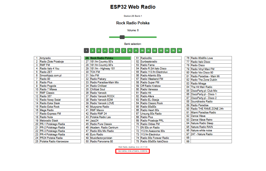

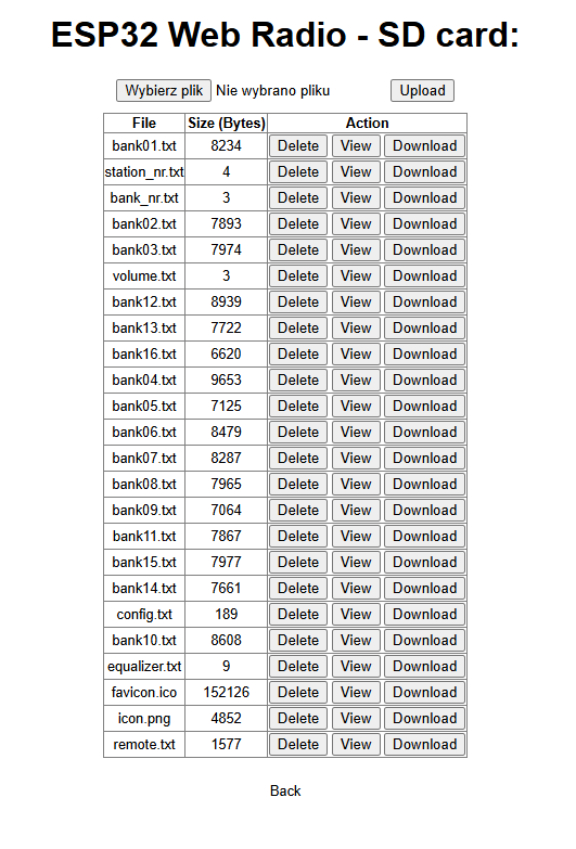

    I wanted to share the new Evo radio update - version 3.17 actually 3.17.36 Link .
    What's new:
    - OTA update from the main website without entering recovery mode, without compilation
    - SD card file browser via www page
    - From this version, the configuration of the remote control codes is kept on the SD card in the remote.txt file
    - Full configuration of settings via website
    - Verbal time announcements (every hour if enabled in the configuration) we hear "It's time" and e.g. eighteen o'clock zero zero. There is both PL and EN version in the code, but the configurator currently works only with PL version.
    - I have introduced a version sub-revision for my own purposes. That is, 3.17.xx. This is only visible on the website.
    - As of version 3.17, there is no longer an mp3 player in the code and there is no second encoder. As I announced at the beginning of the development of "Evo" it is radio only.

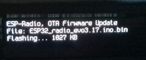

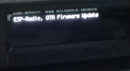

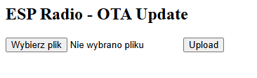

    OTA Update - update via www .
    Three options appeared at the bottom of the www page: SD CARD, OTA UPDATE, CONFIG, enter OTA Update. The radio will turn off the audio stream, a message will appear on the OLED screen: "ESP-Radio, OTA Firmware Update", after selecting a file on the page the display will show the file name and the progress of the memory flashing. In my opinion this works faster than via UART.
    ESP radio OTA update page with file selection and upload buttons .
    ESP32 Web Radio webpage with a list of radio stations and control options. .
    Display showing firmware update for ESP-Radio. .
    Black OLED screen displaying the white text ESP-Radio, OTA Firmware Update. .

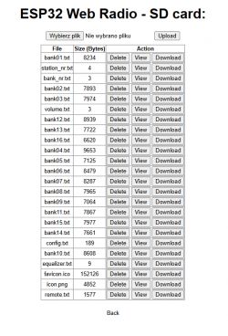

    File viewer on SD card .
    Clicking on the "SD CARD" option will open a simple file browser of the files on the SD card. Among other things, you can view bank files, configuration files, delete files and upload any new file. In this way, we do not need to remove the card and it can be built into the device.
    Screenshot of the SD card file browser for ESP32 web radio. .
    Remote codes on SD card - remote.txt file
    All remote control codes are from now on kept in the remote.txt file on the SD card. The file looks like the one below. I wanted to be able to easily do a "copy-paste" of what is defined in the code in version 3.16. In the absence of the file, the radio will accept the codes set in the program code for the RC-406 Kenwood remote control.
    It is very important not to modify the "order" of this file. That is, if we do not have a button for a given command, we set the FF address and the FF command, i.e. 0xFFFF; but do not delete the line in question. The program does not recognise commands from the file itself but assigns them sequentially so the order is also important. Each command MUST start with "0x" and end with a semicolon ";"
    Code: C / C++

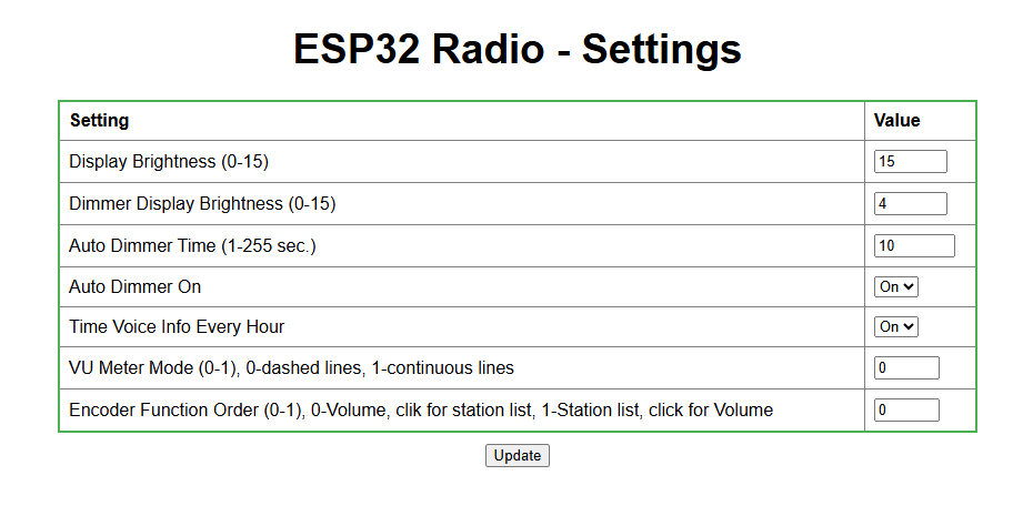

    Full configuration of settings via www .
    Enter via the web page (menu at the bottom as with other options). The following parameters can be set. The whole system is saved in the config.txt file and read from it when starting the radio. The AutoDimmer function is based on register settings, so it will only work for displays based on the SSD1322 driver. Ultimately I will use the contrast setting of the u8g2 library but I need to build a second radio board for testing.
    Settings: Display Brightness, Dimmer Display Brightness (0-15), Auto Dimmer Time (1-255 sec.), Auto Dimmer On, Time Voice Info Every Hour, VU Meter Mode (0-1), 0-dashed lines, 1-continuous lines, Encoder Function Order (0-1), 0-Volume, click for station list, 1-Station list, click for Volume
    ESP32 radio settings interface with a list of options and values. .
    Word time announcement .
    As one of you requested I have added options for the radio to read the time verbally. This is based on the audio library author's program. Now for those who have the RC406 remote control under the red handset button you can read out any time for yourself.
    What next ? .
    For the future, I would also like to move the URLs with the banks to the configuration file. So that as few things as possible are in the program code.
    Also, the HTML code of the individual pages will eventually land on the SD card, but this will make it impossible to use the radio server without the SD card. Question: does anyone use the radio with EEPROM settings only ?
  • #1063 21508053
    hevet
    Posts: 347
    Rate: 47
    You've hit the ground running, I'm already getting down to testing :)
    @robgold in line 3672 (Platformio) is:
    myFile.println("Voice Info Every Hour On =" + String(timeVoiceInfoEveryHour) + ";");
    and I think it should be
    myFile.println("Voice Info Every Hour =" + String(timeVoiceInfoEveryHour) + ";");
  • #1064 21508418
    robgold
    Posts: 726
    Help: 10
    Rate: 290
    >>21508053 This is just a description in the file. Auto Dimmer also has the name notation as "Auto Dimmer On" but I have changed this in the newer version because the selection function no longer has 0 -1 but on/off so it doesn't need to be called that much. I have also standardised the page names as: ESP Radio - SD card, Config, etc.
