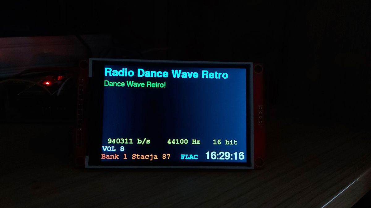

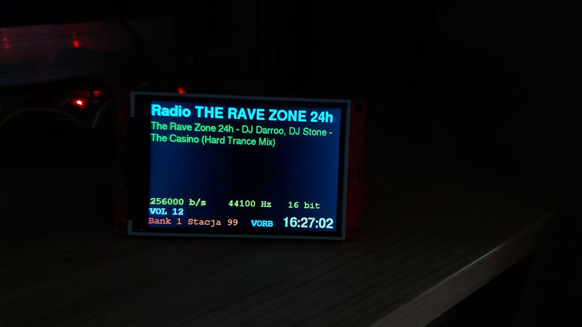

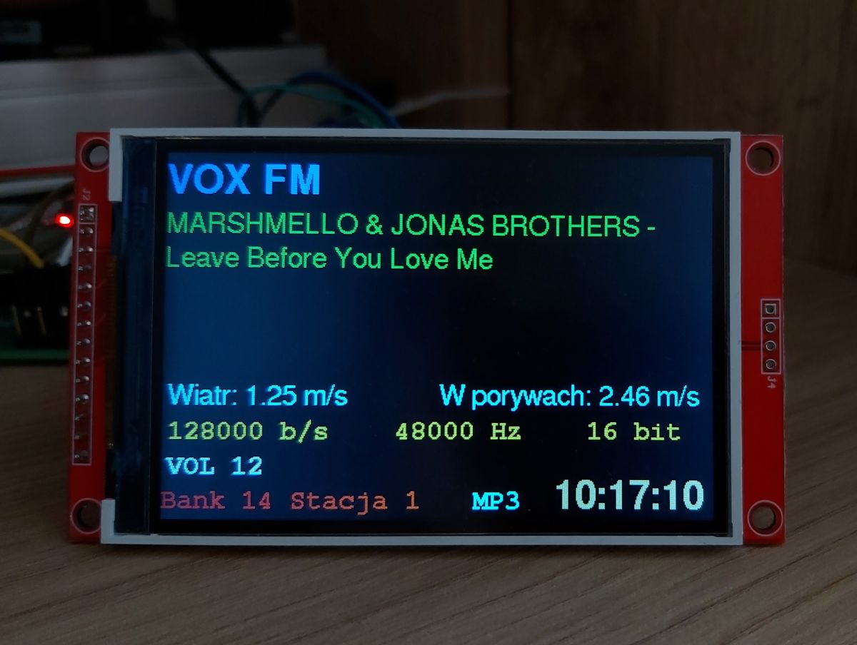

    A small step forward, for now just the ILI9488 screen + ESP32 S3 dev module + PCM5102A + IR receiver.
    The screen is capacious, size 3.5 inches , so it holds everything. I have a little trouble with it, because I think something is not working on the SPI bus (and there is also a card reader running) and it can crash after some time and there is only white backlight.
    I haven't managed to fire this screen up with some ready-made library for it and I have all the init and control in the main sketch file under the Arduino IDE and there I'm sure I'm getting errors or missing some parameters to send. Maybe someone can throw up some battle tested code to control it?
    https://github.com/sarunia/ESP32_internet_radio_v3
    ESP32 S3 module with ILI9488 display showing internet radio interface 3.5-inch display showing internet radio interface with station and audio info 3.5-inch ILI9488 screen displaying radio track info and audio parameters. .
    3.5-inch color LCD showing internet radio interface with playback data ILI9488 display showing internet radio interface with sound and sensor data .

    I've added a calendar card, the layout of the on-screen content is not final and I'll see what else I can add here, there will certainly be no VU metre-style water features, emoticons etc. For me the on-screen content is enough, and I have the radio on my computer desk so I often glance at it. What needs to be improved is the optimisation of the screen control code, but I'll try something next week at the weekend.
    In the meantime, this is how it looks today:
    All code uploaded to github in the link above, for now only operating from the remote control the radio itself in a basic way including switching banks and volume control.

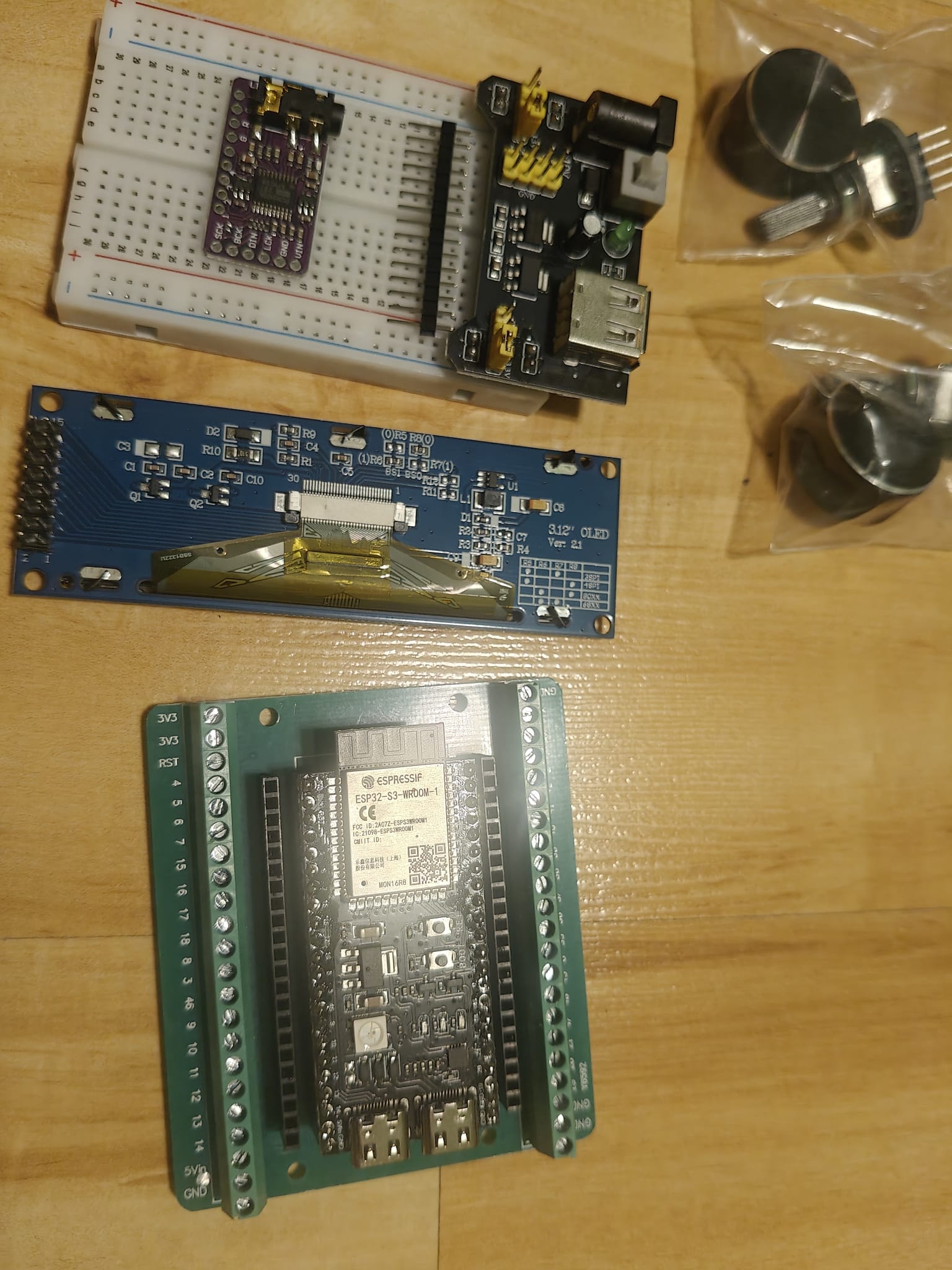

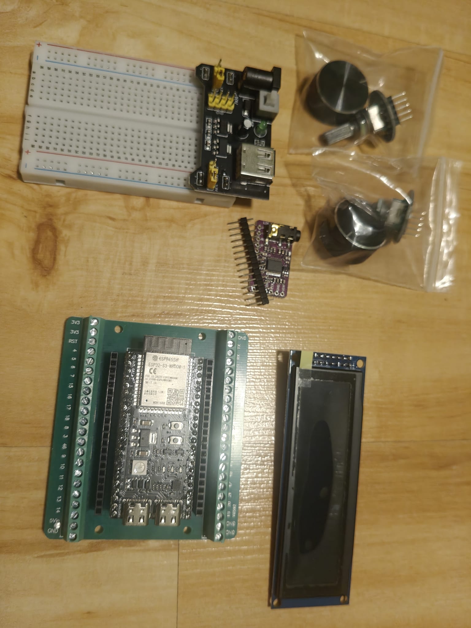

    With these popsicles, will this project from this topic work ?
    • Internet radio and audio file player on ESP32-S3 1.jpeg (325.2 KB) You must be logged in to download this attachment.
    • Internet radio and audio file player on ESP32-S3 2.jpeg (255.78 KB) You must be logged in to download this attachment.

    Well now you have the necessary stuff.
    The radio itself will play with an ESP32S3, a DAC and an OLED display.
    Only you need to compile yourself Robgold's softwares in SPIFFS version and not as SD because I don't see a uSD card reader
    Regards...
    Added after 1 [minute]:
    You can use the USB type C found on the ESP module as a power supply you don't need the power supply of the one on the contact board.
    Well unless you want to plug everything into the contact board.
    Regards...

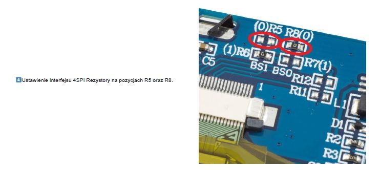

    A colleague Robgold is making .bin files available on github. I don't know if it's legit, but after uploading the file to the module (Esp flasher) the radio fired up, sees the SD card, saves banks etc.
    Second thing: the display needs to be set up under 4SPI:
    Close-up of a PCB with R5 and R8 resistor positions circled for 4SPI setting. .

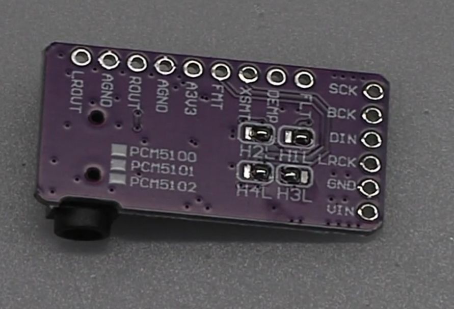

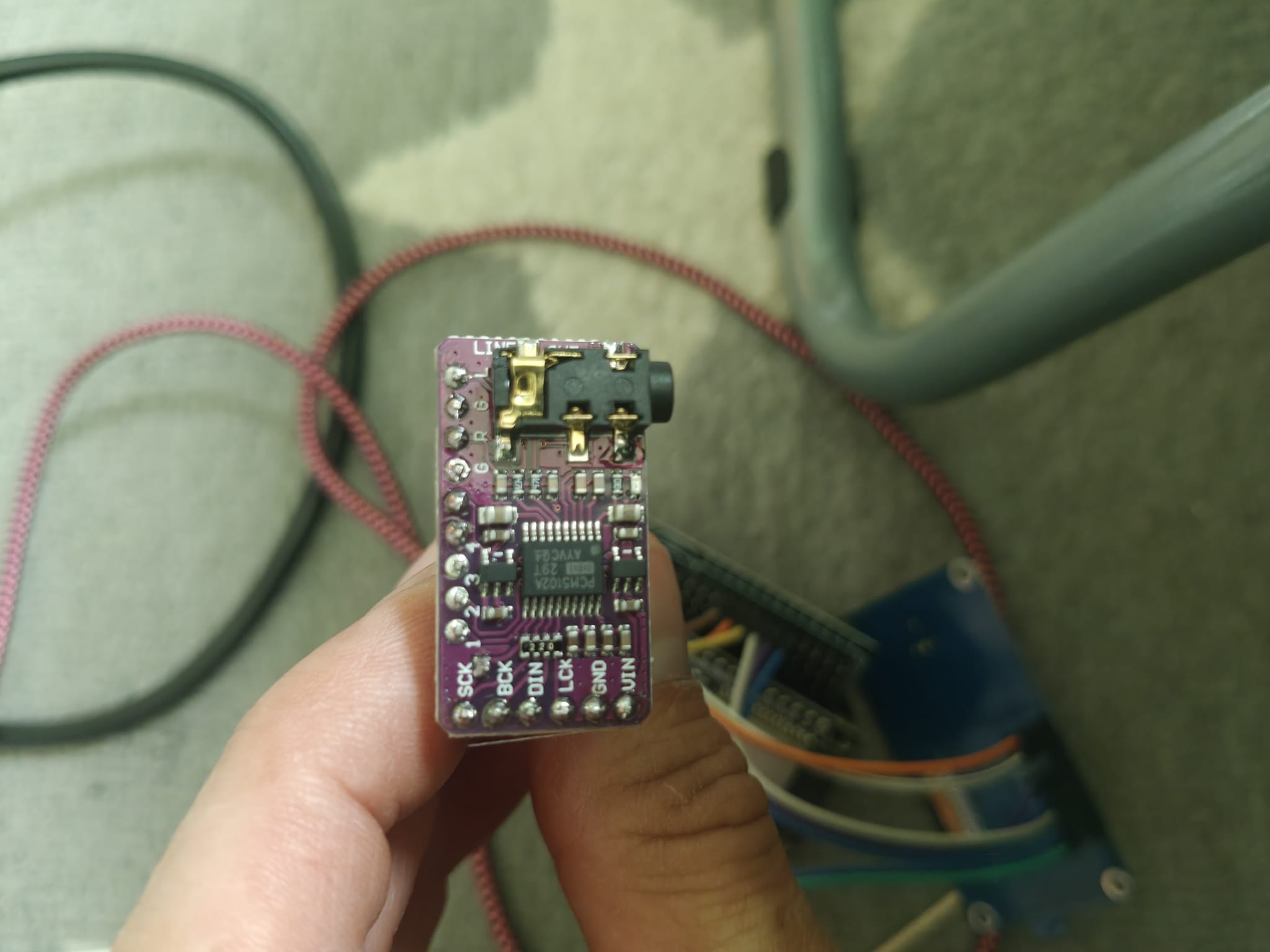

    Correct the display as you write and accordingly the pcm module with jumpers underneath the module.
    DAC module with PCM5100/5101/5102 chips and pin headers .
    As for the software in bin format, of course it provides and it works, but a uSD card is required mate amrowek in the pictures of the module that the memory card slot does not have. If he uploads the bin soft the radio will not start without the card.
    In order to run the radio without the card, the user has to recompile the code by replacing the SD card with SPIFFS.
    Regards....

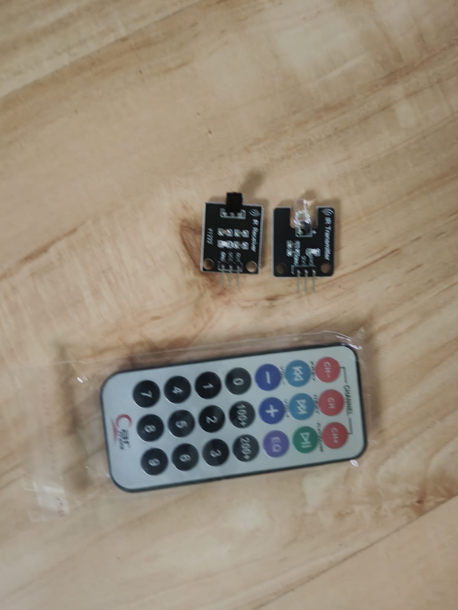

    And you are still missing an IR receiver to control from the remote, I see that you have an encoder with this you can set to change the station volume, but additional options you can not set for this you need a remote control and IR receiver.

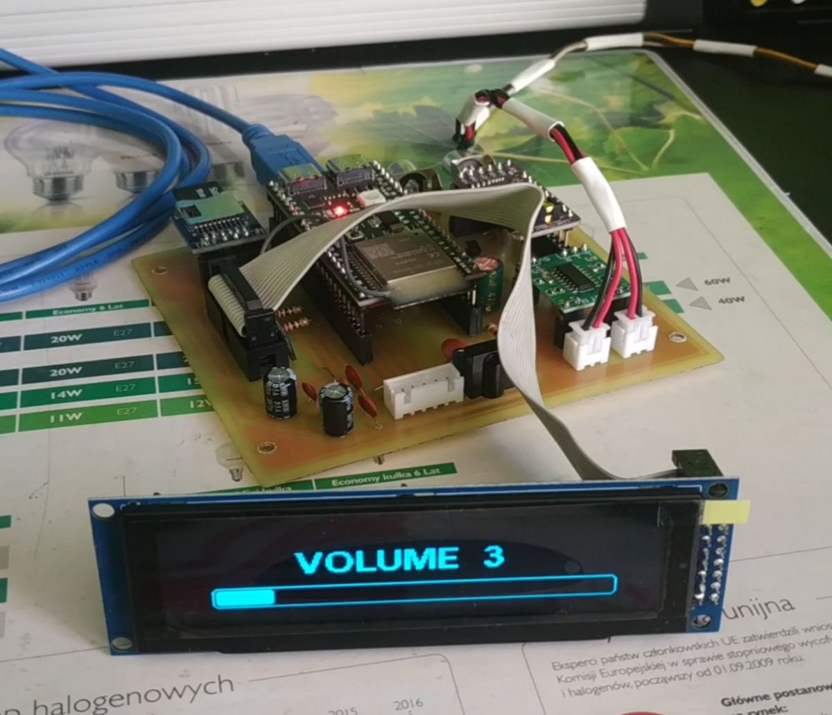

    I, for the time being, have started to develop the player as a separate device on OLED 3.12
    Close-up of MP3 player prototype with OLED display mounted on a PCB board .
    Audio player prototype with 3.12-inch OLED displaying MP3 file information
    Audio player prototype with OLED display showing volume level .
    Player code borrowed from Major, design from Robgold and volume and eq functions.
    It is these options for playing and storing songs that I miss.
    And also the issue of full remote control, i.e. selecting the song number from the catalogue via the digits in the remote control.
    It's nice that the project didn't die (like most of the projects on the electrode) but will be developed, thanks to you guys for updating the softwares.

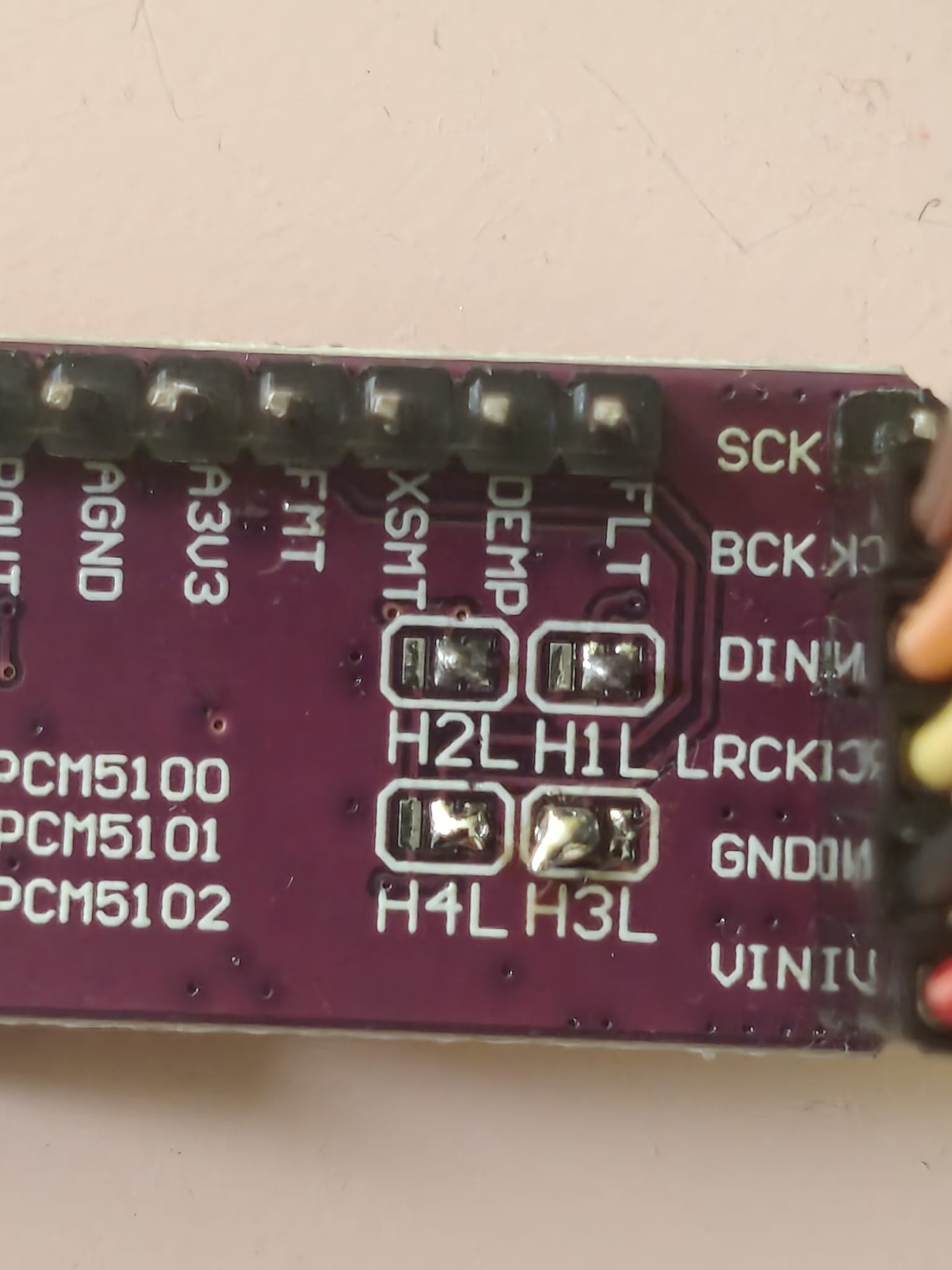

    hm did i make the jumpers right, on the top side the jumper at the SCK pin

    I connected the SCK pin physically to ground so this jumper on the module was not used, make the jumper underneath as in my photo a few posts above.

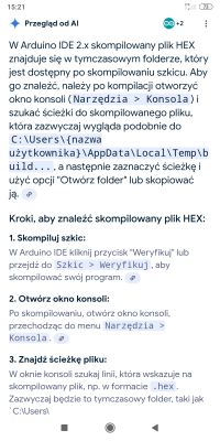

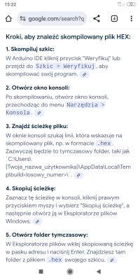

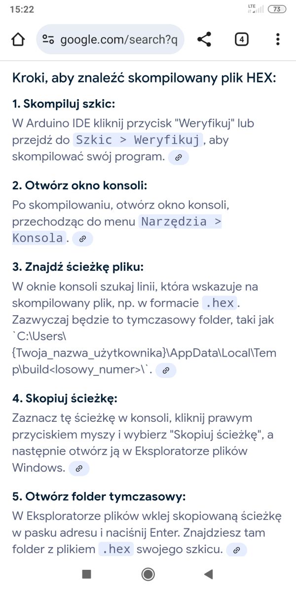

    In 2x I don't know search from the top menu Export compiled file so much about this AI says
    Screenshot with instructions on how to find a HEX file in Arduino IDE 2.x .
    Instruction steps for locating a HEX file in Arduino IDE shown on a smartphone screen .
    Greetings...

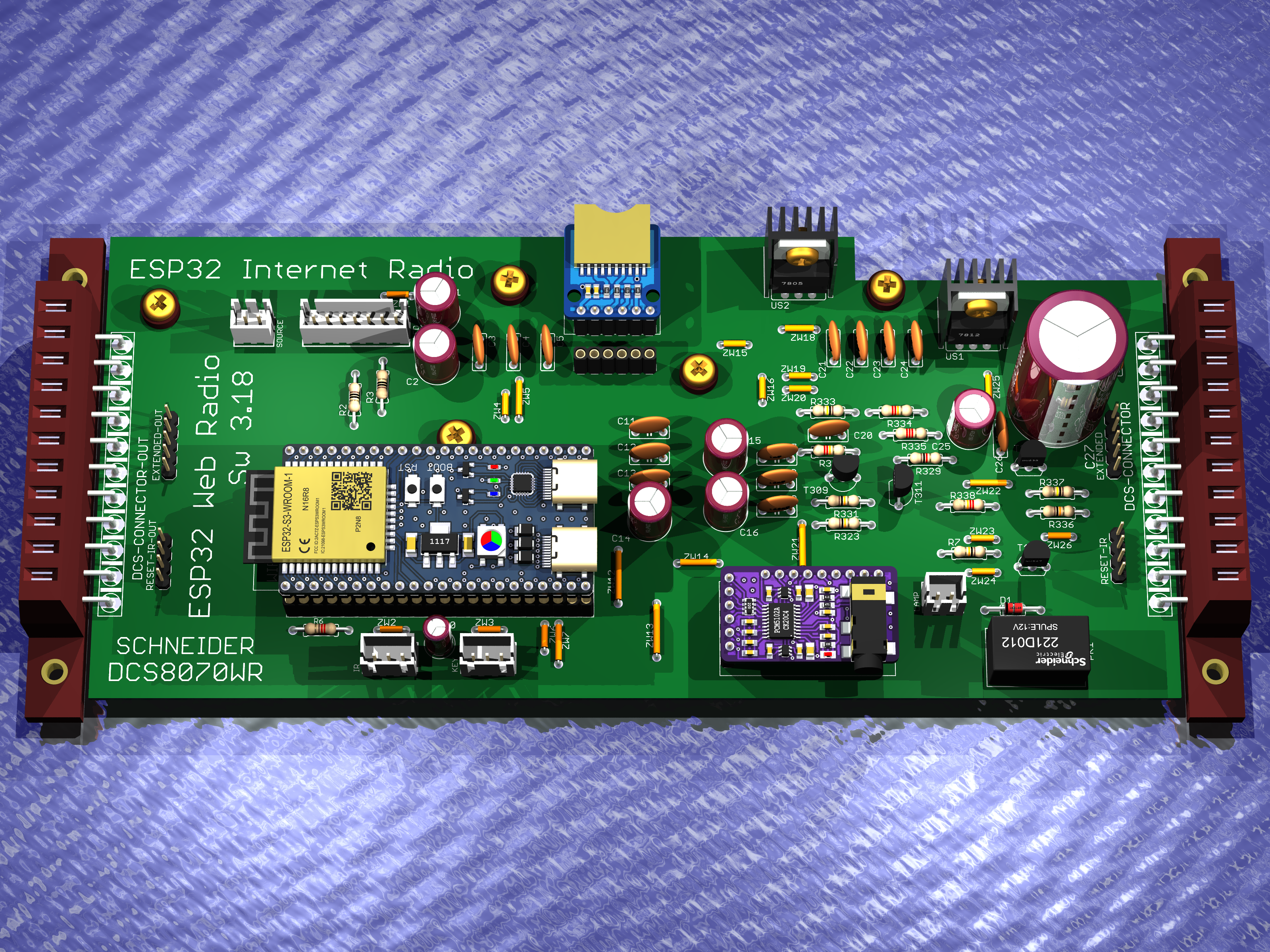

    Hey kol Robgold I'm still compiling under my Schneider tuner chassis which I intend to finish by the end of the year.
    There is a space of 23mm x 78mm and I'm also looking for something that would fit there best currently the OLED 3.12 whole is nice but too big, the 2.08 on the other hand is very small and quite strange looking.
    Schneider audio tower with remote control resting on the top device .
    I've already taken steps and made a PCB design taking into account the signals going from the other blocks in the kit, i.e. the remote control and input selector signals.
    This is how it looks after rendering...
    Rendered PCB of internet radio with ESP32 module and DCS connectors
    And so far I'm at the etched PCB stage and waiting for a free moment to solder it.
    Two PCBs; etched board on top, printed circuit layout on bottom.
    This is another version of the radio this time as part of a 40 year old kit after restoration 😀

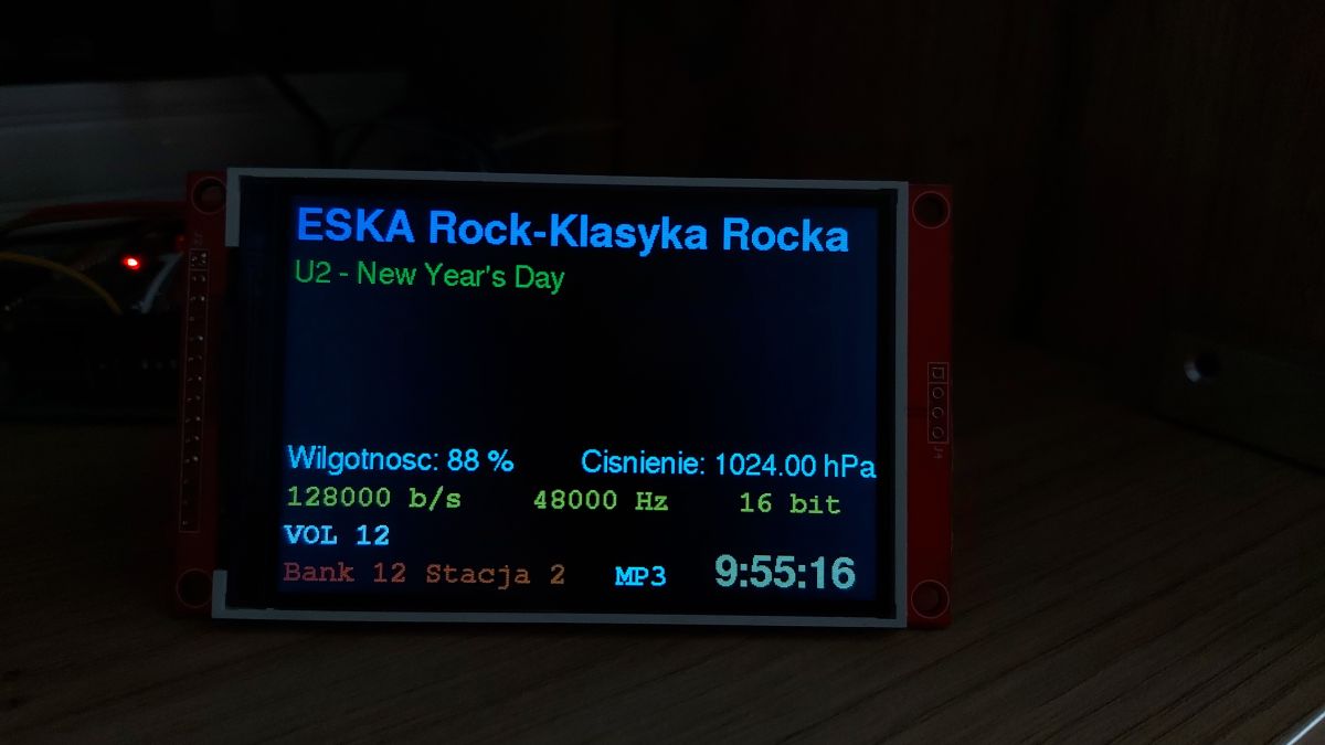

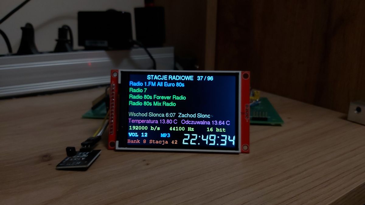

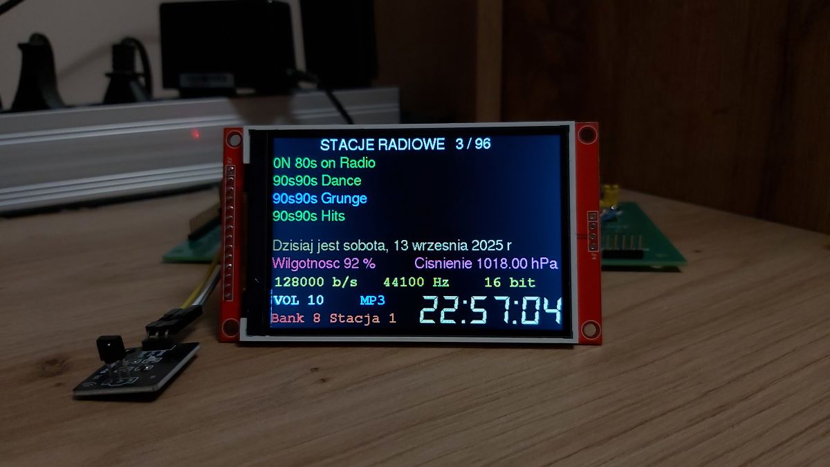

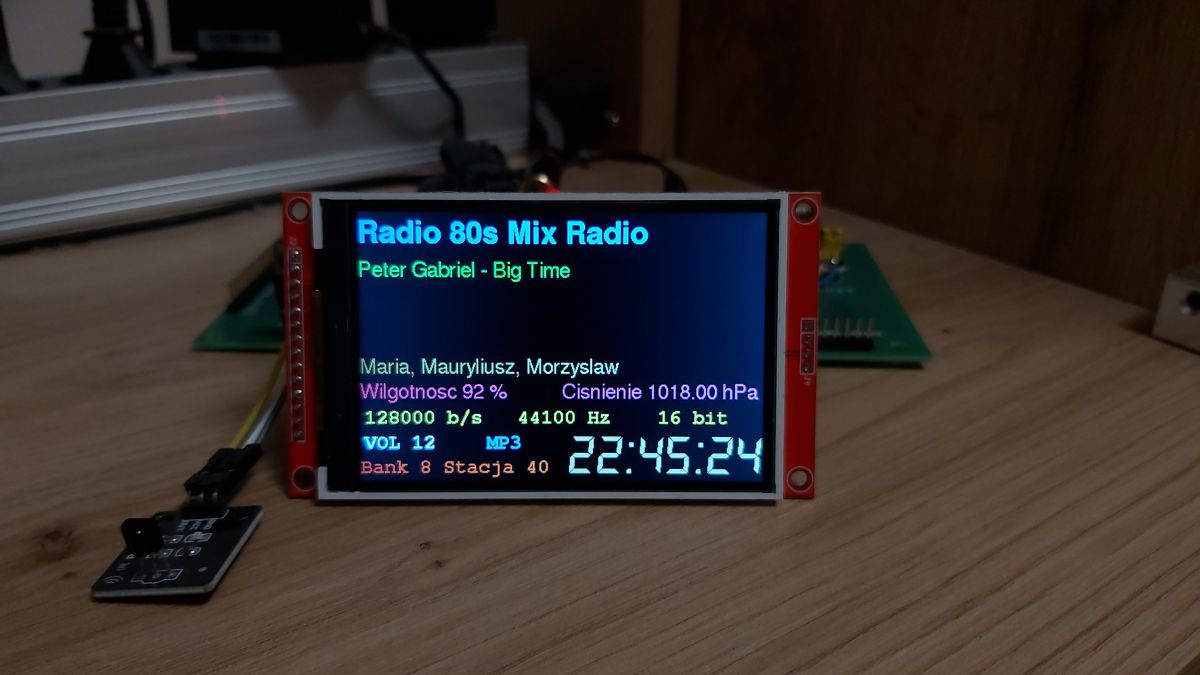

    Today's job was to change the clock font to DS_DIGII35pt7b. I also added a scrolling list of stations, the scrolling list with a view of 4 stations and the currently selected one is displayed in a different colour. Changing banks is done by changing the colour of the displayed bank in the bottom line until accepted or timeout after idle. Unfortunately, I haven't managed to fully embrace the display and there are occasional lint or it gets completely whitewashed despite all the wires being soldered. Evidently it loses the config, because by adding a tft init line at the moment of switching stations the display returns.
    Color TFT screen displaying internet radio data and a digital clock .
    LCD screen with radio station list, audio data, and large digital clock .
    LCD screen interface showing radio station list, current time, and weather data .
    I have made a wiring diagram, you can try it, improved screen stability - added more commands to init.

    I have this 76x284 display under Yoradio. It has only one myk, The backlight is connected to GND.

    #1318 21692802
    DJCheester
    Level 28  
    Posts: 2089
    Help: 75
    Rate: 958
    robgold wrote:
    @DJCheester
    Cool that colour LCD what you recommended Link. All these displays (well almost all of them) work over SPI. The Chinese just call them SCL and SDA regardless of whether it's an SPI or I2C data line. Sometimes these displays have both buses for communication.
    So, if we were to use what I've given (of course, if you were to convert the soft to it), would it be different to connect it to the ESP32 and by how much, because I've already made a pcb for the earlier OLEDs?
    Greetings ...

    OK, here's another version from me after a big update....
    I sat down recently and reworked my v3 to support with the latest audio library version 3.4.2, Arduino IDE also latest version 2.3.6, ESP tool version 4.6
    In addition, I introduced support for graphics via canvas to push content to the screen. By doing this, I was able to significantly improve the screen refresh rate and the whole thing looks much smoother and more aesthetically pleasing than the previous version.
    Unfortunately, I've noticed that the audio suffers with this setup - there are minor clipping in audio playback, especially during the more intense interface refresh. It looks like graphics and audio are competing for resources, so you'll need to diagnose the problem more accurately - check task prioritisation, audio caching and possibly optimise rendering so that screen refresh doesn't interfere with audio smoothness. For the moment I've commented out the calendar card and left the weather lines from the timer, but when refreshing the lines every 10s there is a slight pause in the audio, very short but it's there. Later I'll try to correlate to push the timer seconds change to the screen with the weatherman and calendar at the same time. I leave both versions on github for comparison. Overall already a very nice, smooth and stable screen. I still have some fine-tuning to do, but you can test....
    https://github.com/sarunia/ESP32_internet_radio_v3/tree/main/ESP32_radio_v3_ILI9488_canvas
    Maybe @robgold can you help optimise this?
    Below is a video of what it currently looks like:
