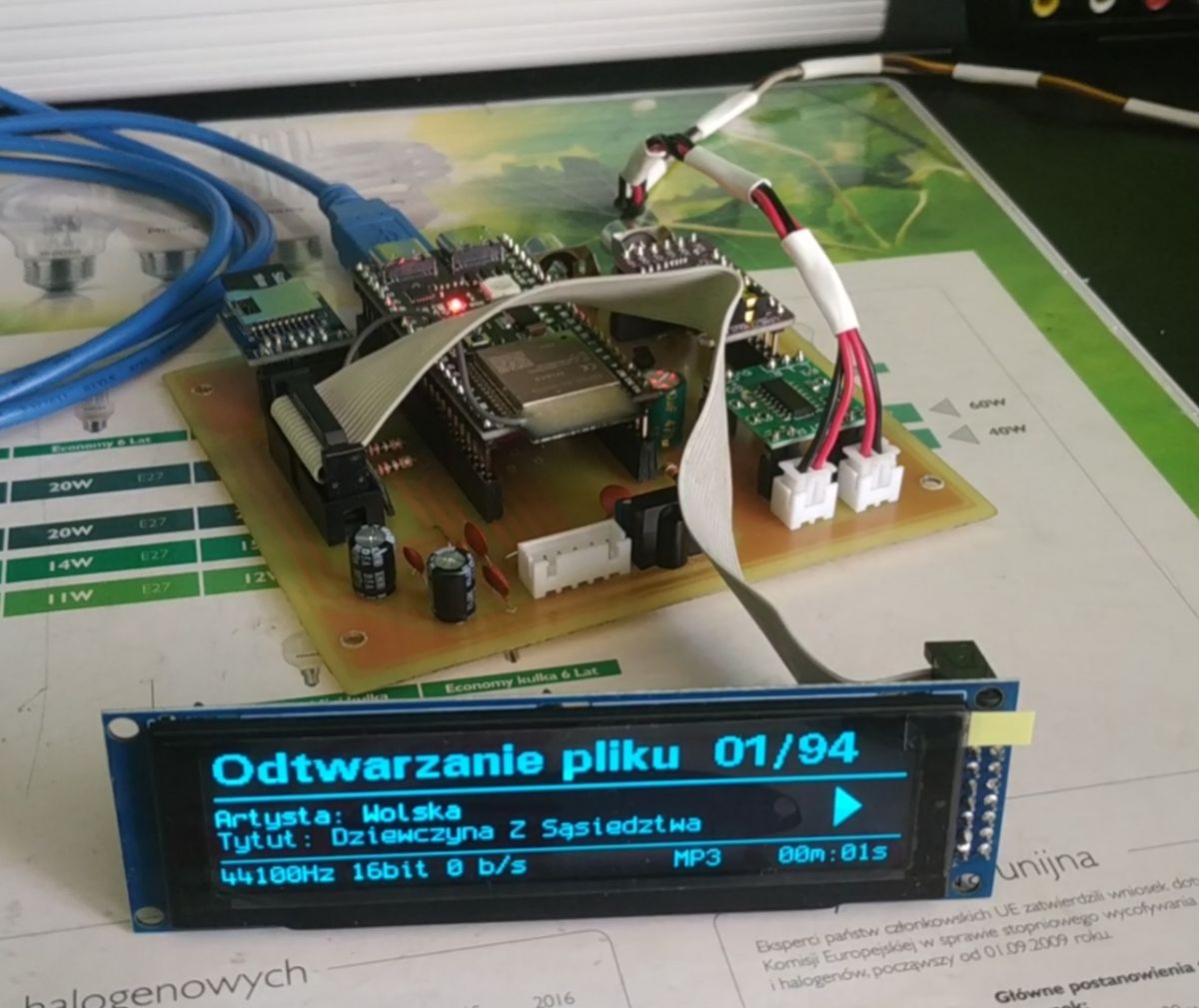

    I have improved support for the timer display, the display runs smoothly, all files including flac go without jamming, patches on my github, feel free to try the code.

    Have you improved the player with this additional function?

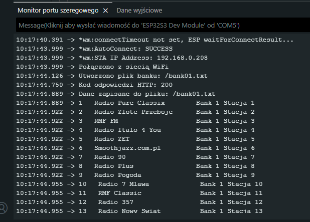

    @hevet show the logs from the terminal, you probably don't have wifi hooked up, and preferably load on a clean flash to enlist from the start, also don't know about the SD card- best to have one that worked with the previous version of my v2 or a brand new/formatted one.

    @MAJSTER XXL It just shows an SD card error, this card with this reader worked on the previous version, here it doesn't want to, the connections I checked and they are ok.

    @hevet I checked again on a clean card, the program starts as expected, creates files when they are not on the card and then uses them already.

    @MAJSTER XXL I've already embraced, got the card working on display, but had to remove three resistors on the lines from the card.

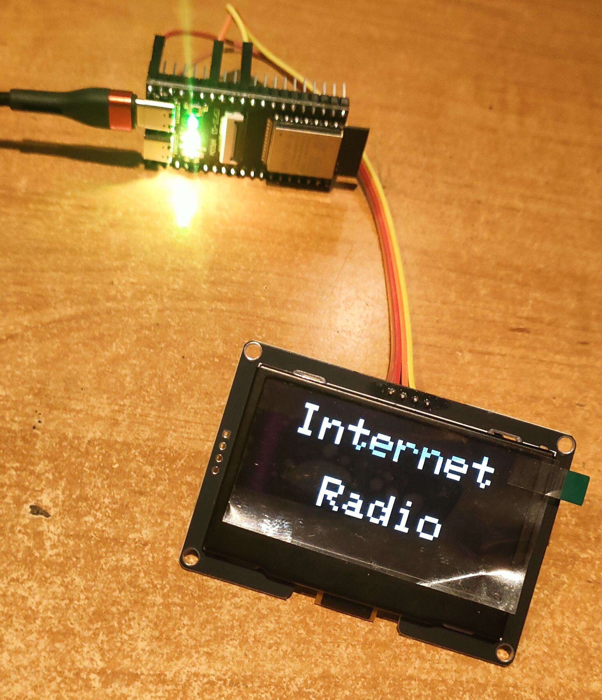

    Hi, I undertook to assemble the radio layout of a colleague Majster XXL, I couldn't compile the github file correctly, I found a post by colleague futek2, after uploading the .bin file to the ESP32 the word "Internet Radio" appeared on the OLED, nothing else happens, I only have the display connected to the ESP, once the rest of the project elements are connected should the radio work correctly?

    Most likely the Major's soft requires an SD card to be connected, see through the serial monitor where the programme stops.
    But most likely it is the uSD card
    Greetings ...
