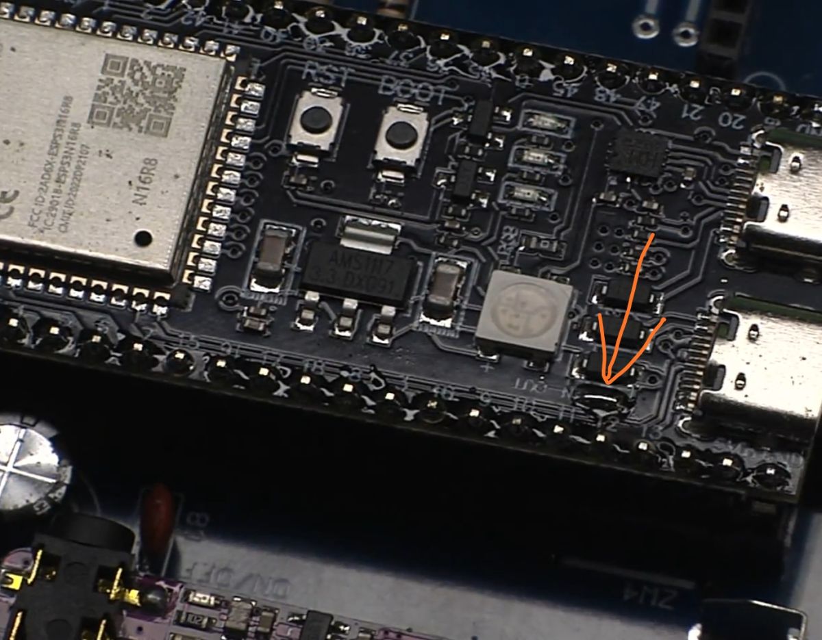

    Hello why do you need to combine all you need is a regular 5V charger from your phone and a USB C cable.
    You get 3.3V from the ESP32S3 module
    5V will also appear on the pins when you connect this jumper on the ESP
    Close-up of ESP32S3 board with jumper marked between USB-C ports .
    You will power the OLED display and the PCM converter from the pins marked 5V
    And the memory card reader from pin 3v3 of the ESP
    Greetings...

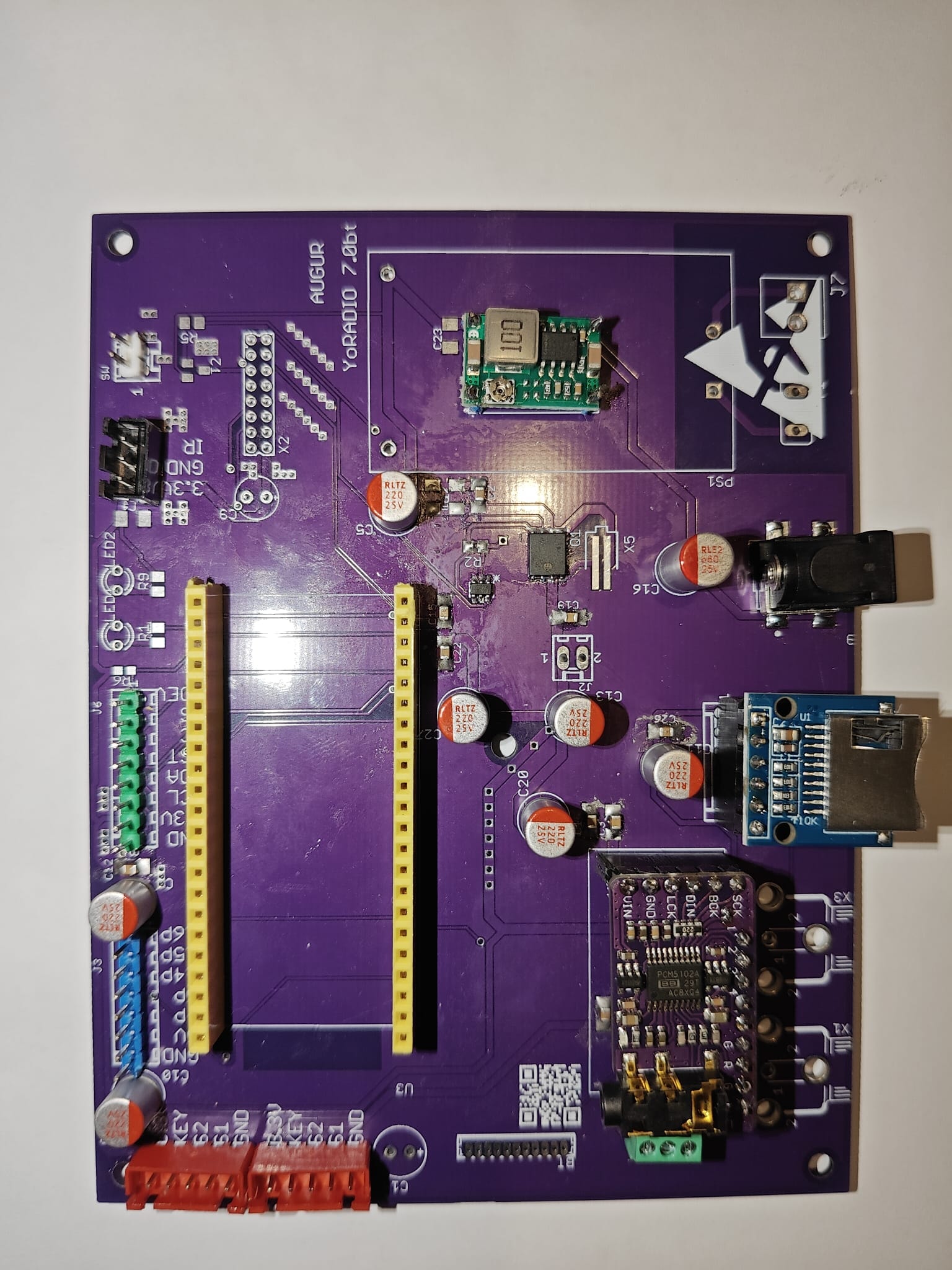

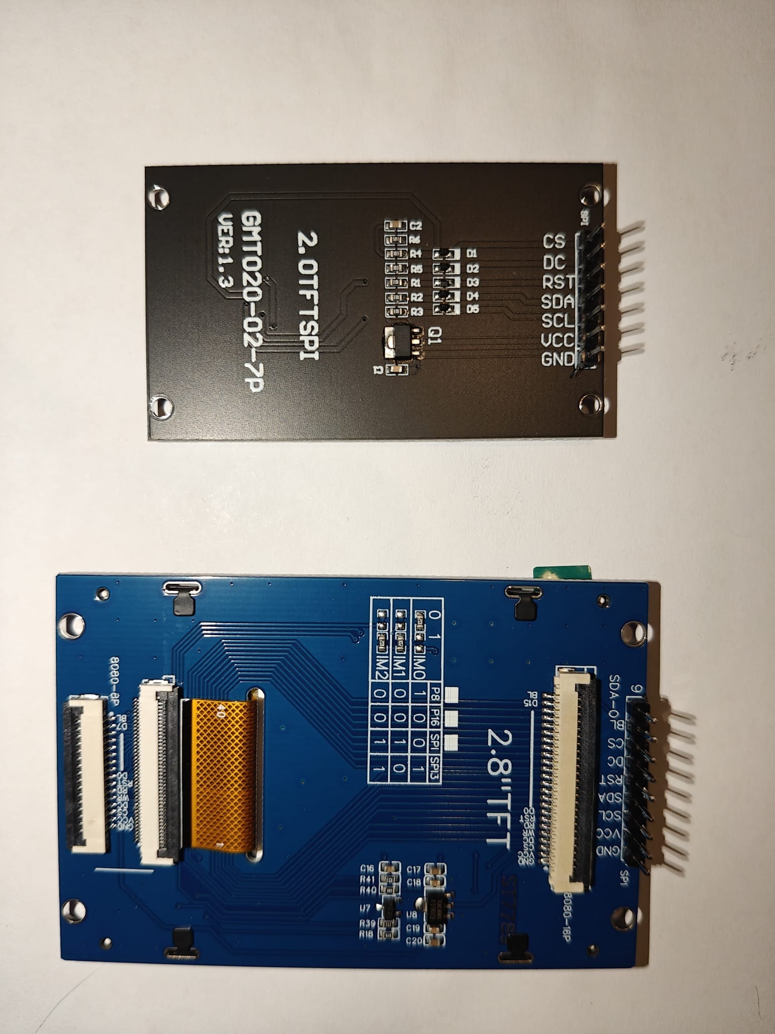

    Added after 17 [minutes]:
    Slowly step by step and question if this pcb is suitable for this project developed in this topic and if these two screens are suitable for this project.... ?

    Displays as far as I can see are not. You need an SSD1322 or ili9488.

    PCB I don't know I don't know the design of YoRadio is unlikely to work because you have other pins I see an inverter and a mosfet which are not used here.
    Why don't you order yourself a PCB for this project mate Robgold has a gerber file on github I have recently made my version available, you solder you win and everything works straight away.
    You are combining all the time uphill. As I see on the picture you have ESP32 pcm and card module, all you need is a display order yourself an OLED 2.08 or 3.12 inches for my PCB project and you will have a radio, these displays are not that expensive.
    Unless you absolutely want to have a colour one, I have seen the foreman making a new version, but I think I will soon make a PCB project for his version with a LCD screen.

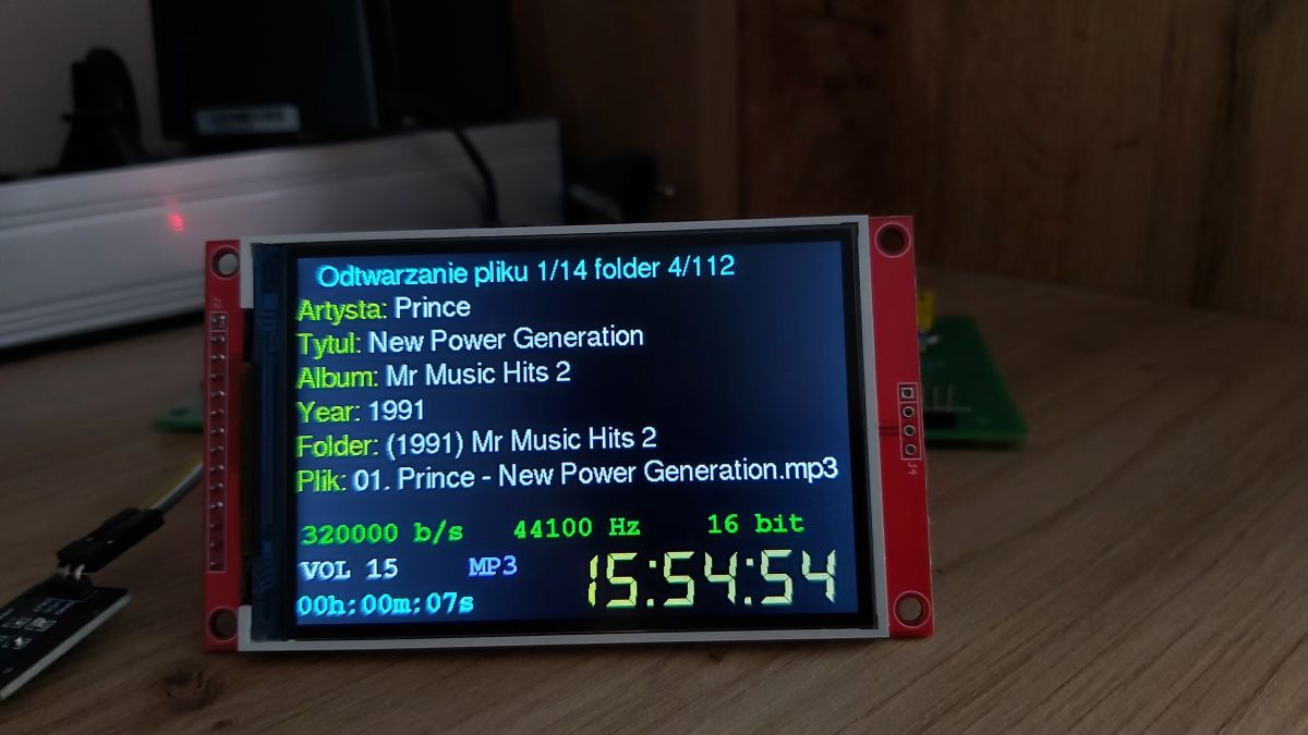

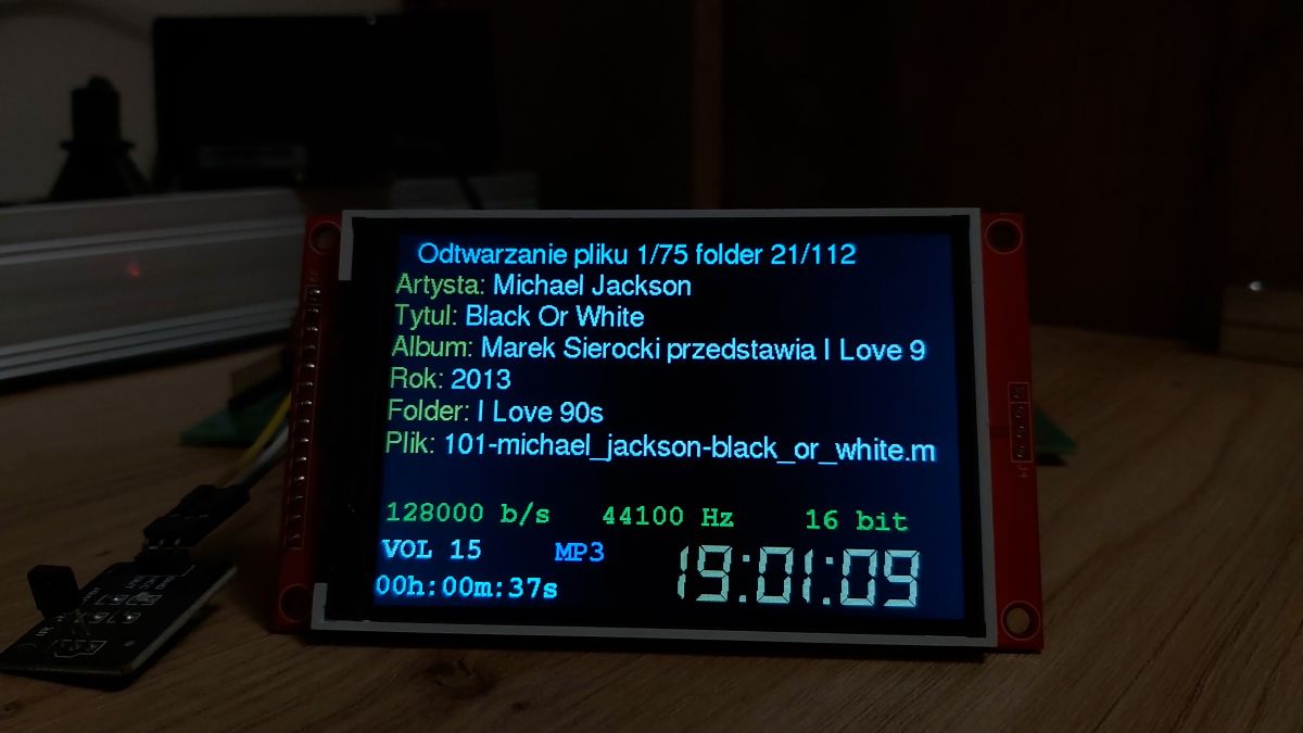

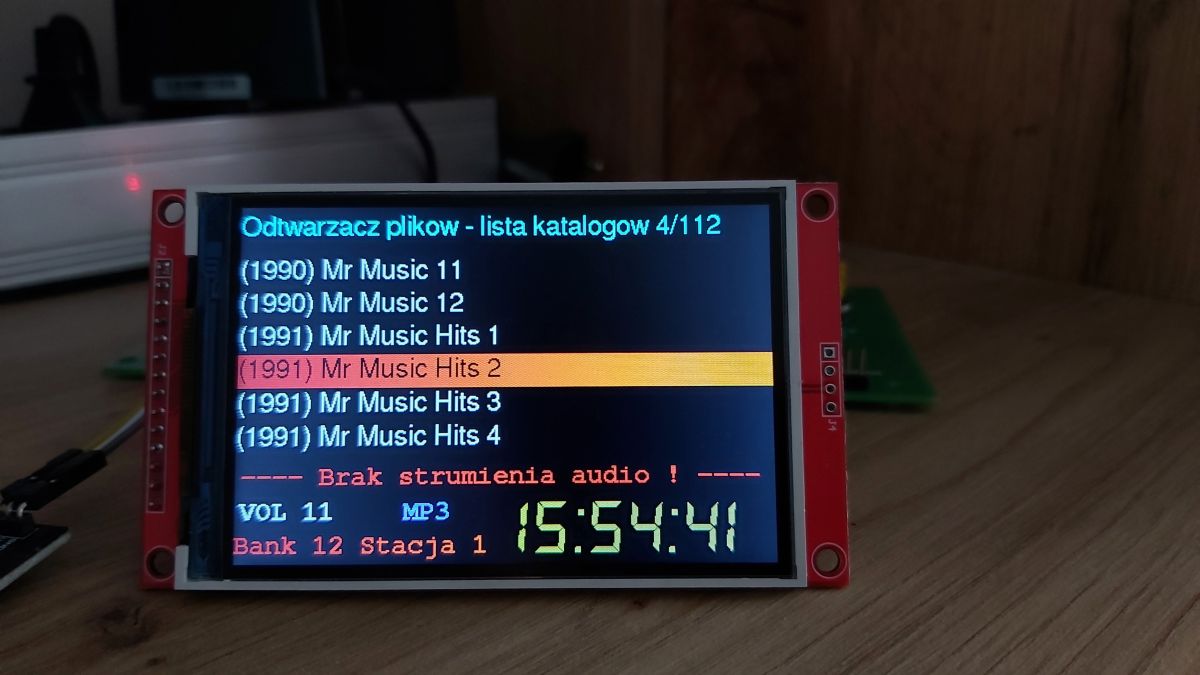

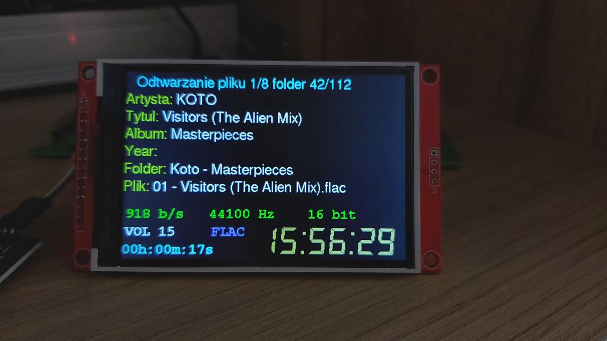

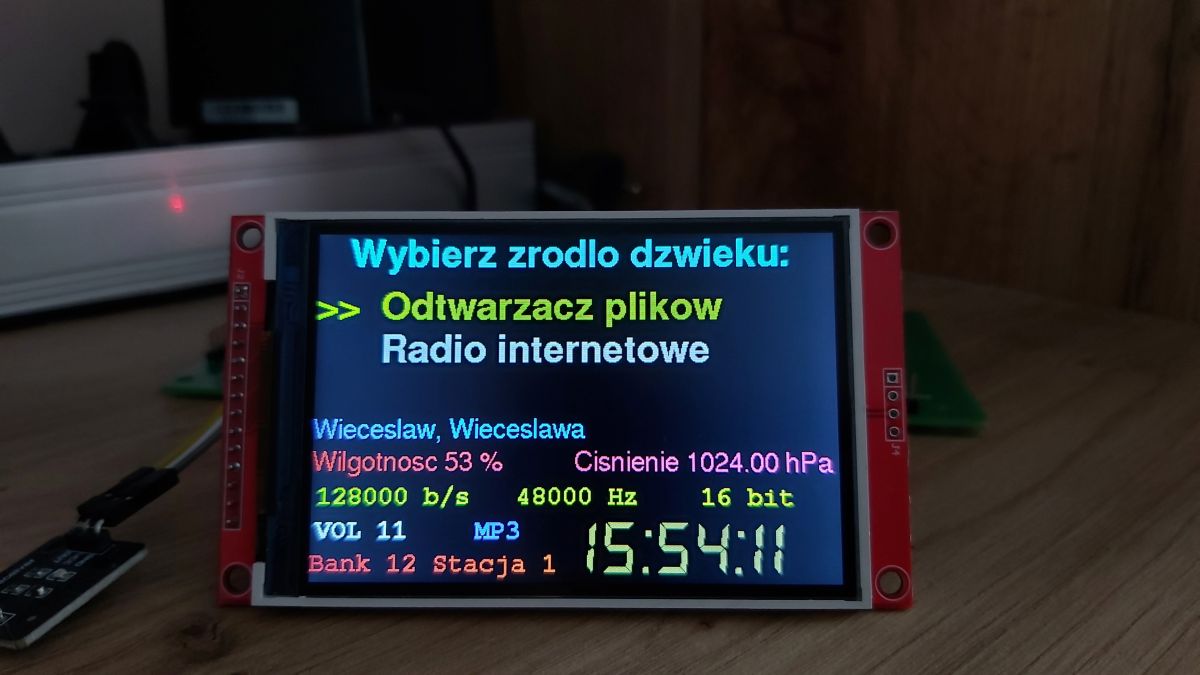

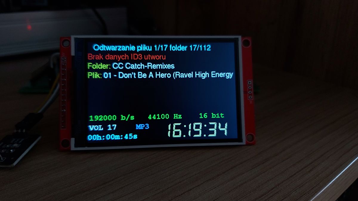

    My v3 version has gained an SD card file player - as usual in an early development version. Support for switching the selection of radio <-> player from the IRmenuButton from the remote control, then the program loads the contents of the SD card - it lists alphabetically found folders from the main directory, then there is the possibility of scrolling the list of folders with the buttons from scrolling the banks (IRbankUp and IRbankDown), the selected folder is confirmed with OK and the playback of the first file starts. Then, you can skip +1 and -1 track with the left/right arrows on the remote control. During playback, you can scroll through the list of folders and select one to play again.
    For now, the songs are played in order one after the other, then after the last file it moves on to the next folder. In general I see that the flac decoder returns incorrect bitrate values.
    In preparation, scrolling the list of files for free selection and patching the strange different behaviour of the program.
    https://github.com/sarunia/ESP32_internet_radio_v3
    Internet radio and audio file player on ESP32-S3 Internet radio and audio file player on ESP32-S3 Small LCD screen displaying details of an MP3 file played from an SD card ESP32 display showing FLAC file playback info from SD card .
    ESP32 project screen displaying MP3 file playback info from SD card .

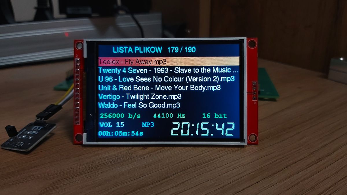

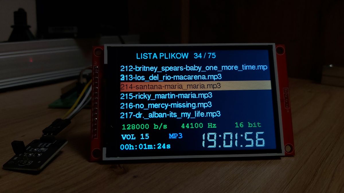

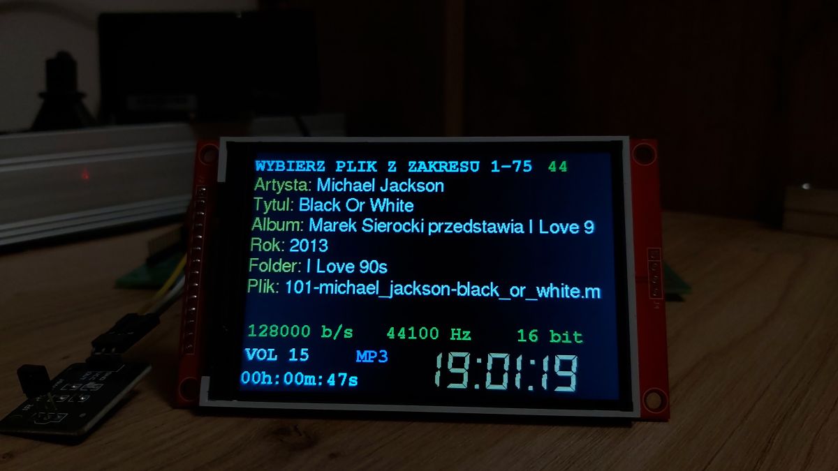

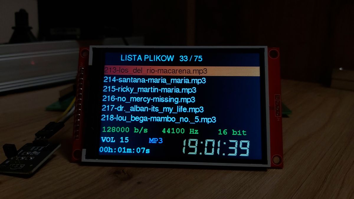

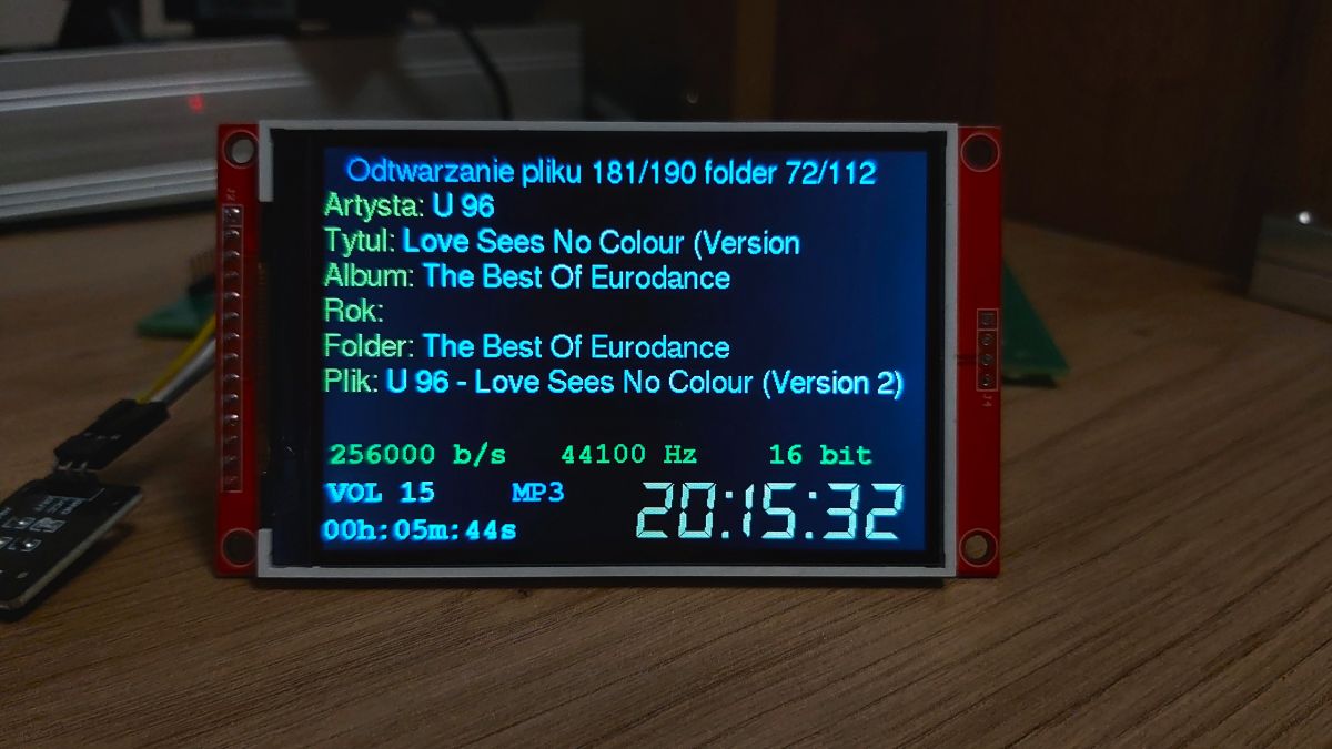

    I have today added support for selecting from a drop down list of files during active playback with both the up/down buttons and free number entry from the remote control keyboard up to 99. I am testing playback of the contents of almost 200 files from a folder - the program is doing well, I will add more folders to the card tomorrow for a trial, so you can play around....
    LCD screen showing audio file playback info from a microcontroller device LCD screen MP3 player displaying info about Black Or White track LCD screen with MP3 file list, highlighted selection, and playback details Small screen displays MP3 file list with playback details of selected file. LCD screen displaying audio playback info and technical parameters Small LCD screen showing MP3 file list with song and audio playback details. Small LCD screen showing MP3 file list with song and audio playback details.

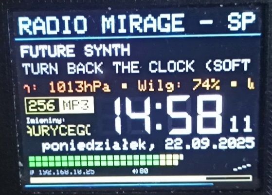

    As if anyone would be interested in a modification to yoRadio that pushed this project a little forward, I committed something like this.
    A lot of changes and fixes, SPDIF, OPUS and VORBIS decoders, station finder, full polish, naming, weather ect.
    The code is on github: https://github.com/romekb/yoRadio_spdif
    And this is what it looks like:
    yoRadio display screen showing station, song, weather, date, and time .
    And a short video:
    https://youtu.be/0B93uhm7WAI
    I have two such radios made based on two versions of Chinese CYD displays on a standard ESP32 (with a PSRAM cube glued on the wires, because without PSRAM it runs poorly). Of course on ESP32S3 there will be no problem as well as on WROVER modules. Now a Chinese panel with ESP32S3 and a 3.5'' 480x320 IPS display + capacitive touch, but with a slightly unusual TFT controller, is coming to me. I should be able to get it working, and of course the code will be on github.
