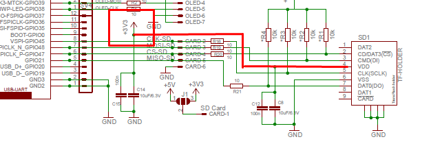

    I have a problem with the visibility of the SD card and so my question is whether the radio should see the card when there are no files on it and how should the power supply to the card be set to 3 or 5V.
  • Ask whether the SD card is a module or bare reader
    #1473 21744972
    robgold
    Posts: 726
    Help: 10
    Rate: 290
    @Jarosław 1808 Do you have the SD card as a module with a slot (some ready-made arduino board) or the reader itself ?
    Take a picture, often on ready made boards there are soldered resistors that "interfere" with communication. The card should be visible as soon as the radio starts up. If there is no card, you will get an "SD CARD" logo on the welcome screen indicating a problem reading it and the radio will store stations and bank number in the emulated EEPROM.
    The card is powered from 3.3V. Here is the wiring diagram in the Evo (consistent with the v2 connection at the Major PDF Link
    Wiring diagram showing SD card module connected to microcontroller with marked signal paths

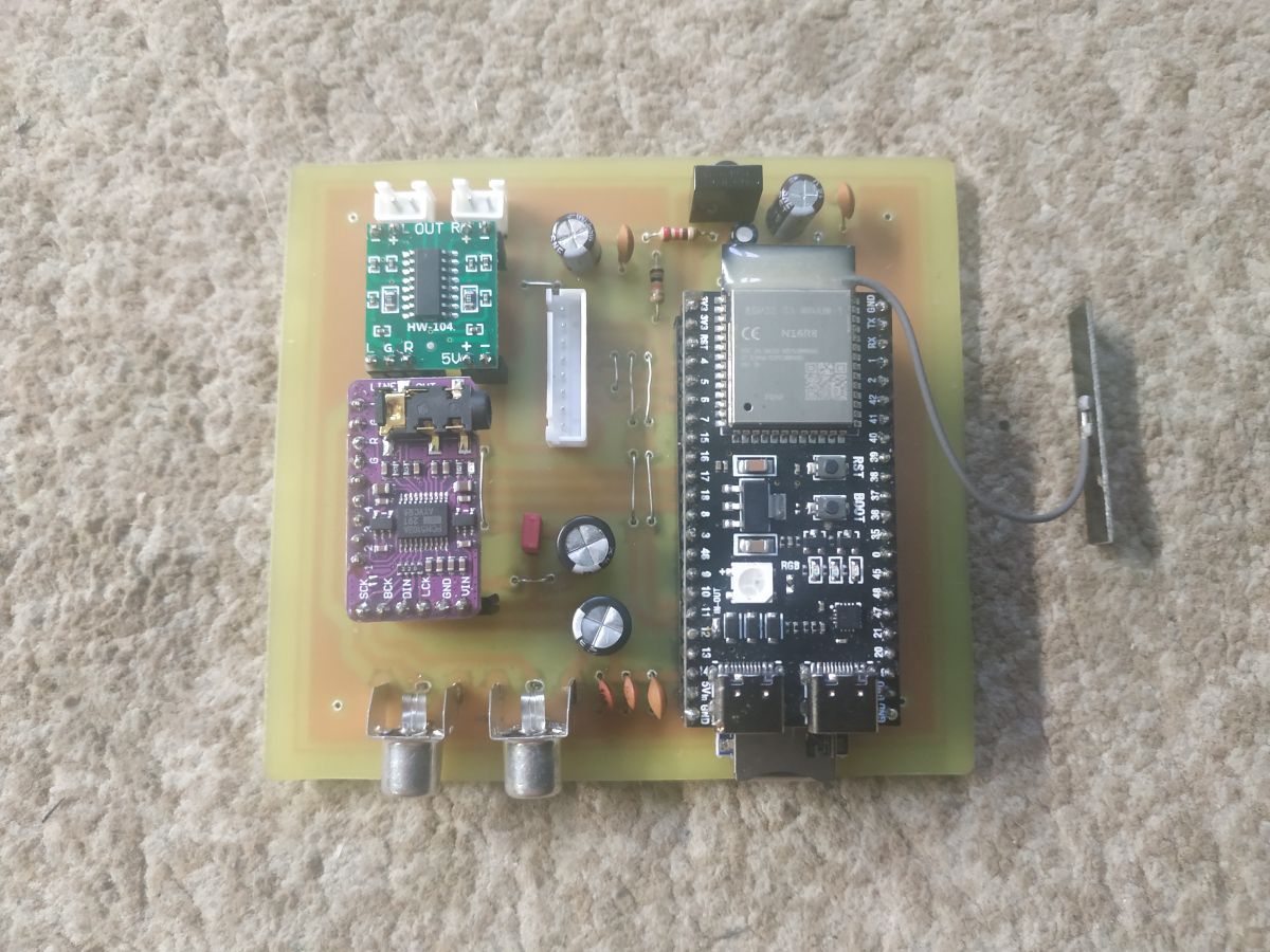

    Hello I've just finished soldering the PCB for the Majster version.
    And that's it for now as the display is stuck in the packet store for the weekend.
    Hand-soldered PCB with ESP32 and audio modules on beige surface
    Commissioning will unfortunately drag on for another week.
    Regards...

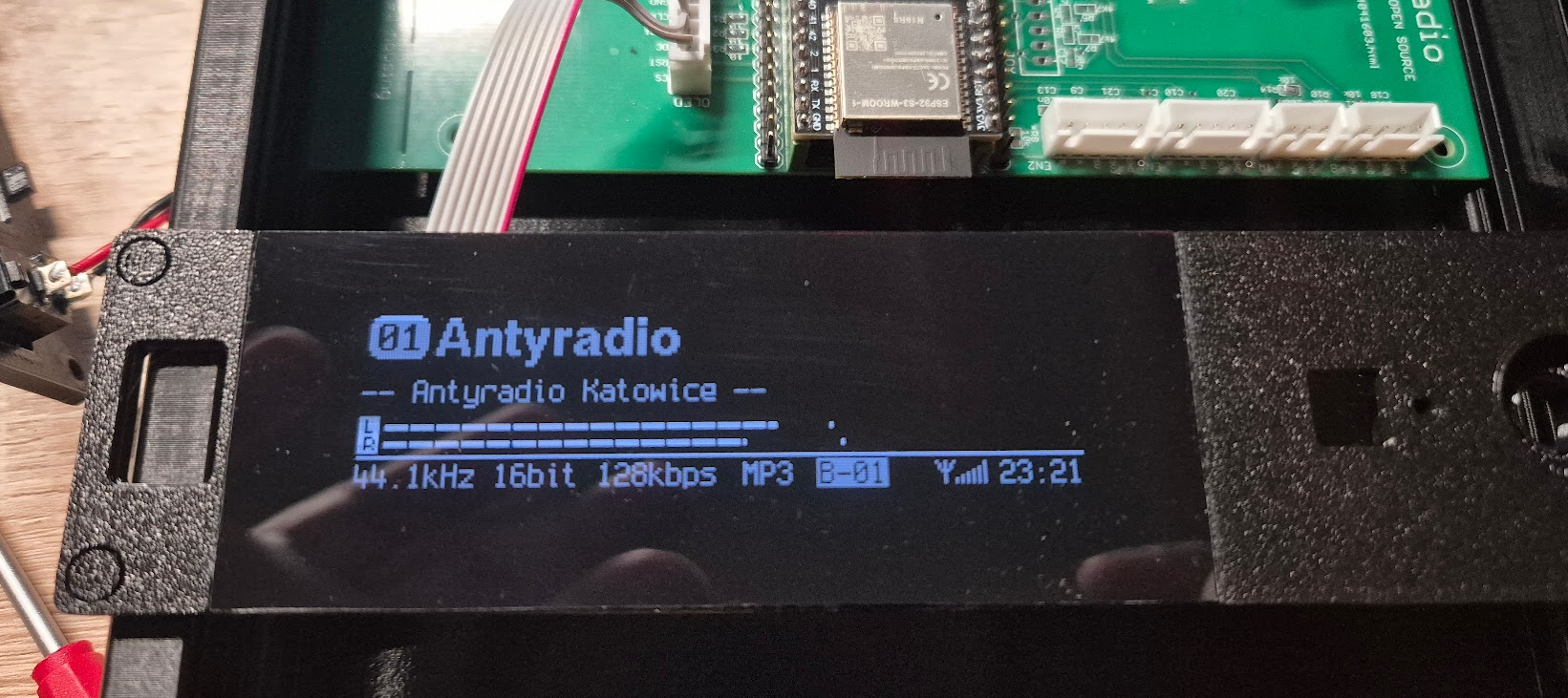

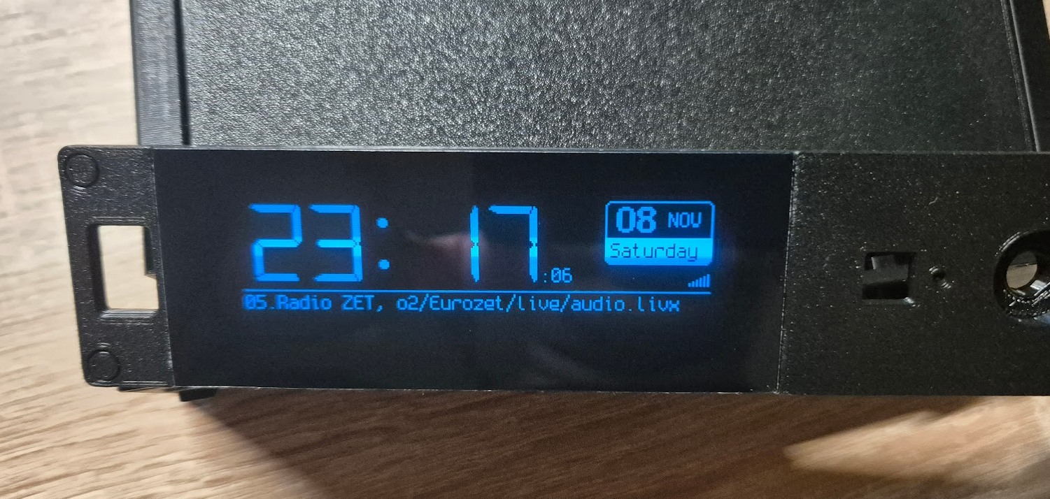

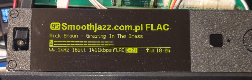

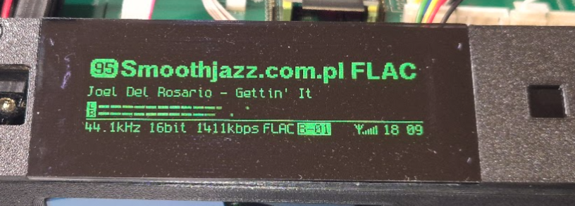

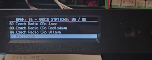

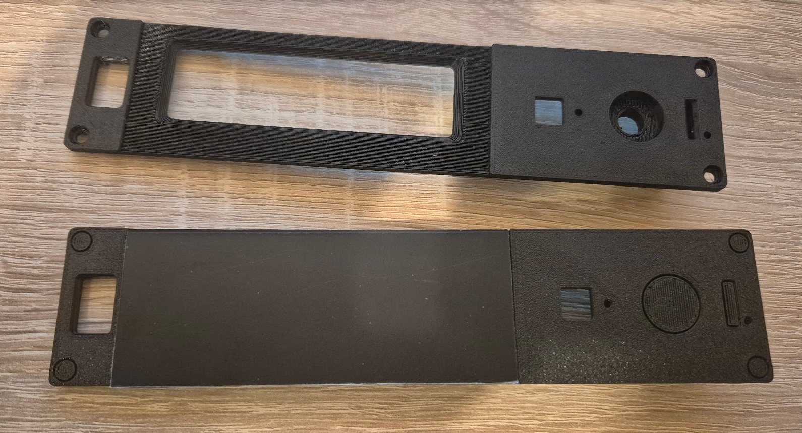

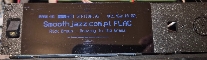

    I envied my yoRadio colleagues, especially the author of the Maestro software, and decided to make my own prototype in smoked acrylic. The first tests are already behind me. Judge for yourself how it looks.
    Two black prototype front panels with cutouts for screen and buttons
    Display of a prototype internet radio with black casing and blue-lit interface
    Display of a radio prototype showing Antyradio station info and system parameters

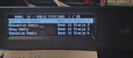

    In Bank 16 I did the last few stations in the new format on a test basis. The bank and station number information is no longer in the station name. It appears as a digit before the name. The station number and bank are still visible at the top of the station list screen. Check if it was not better to come to this standard.
    The current standard so far:
    LCD screen with a list of radio stations in Bank 16 inside a tinted plexiglass case
    New proposal:
    Black tinted-plexiglass radio player with screen showing radio station list.

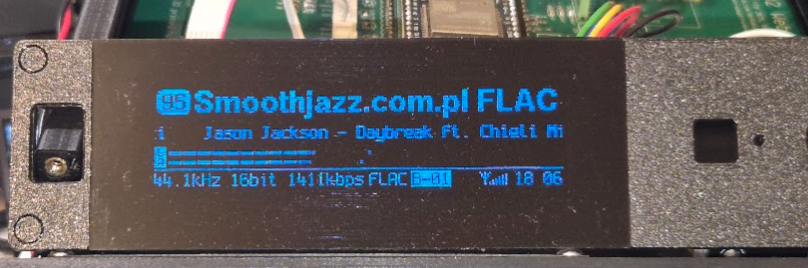

    @irysbox the full power ON/OFF function and the SLEEP function is already in the latest software version. I will upload to github today or tomorrow.
    Additional information:
    I managed to contact Mr. Peter from the station smoothjazz.com.pl , they corrected the metadata in the FLAC stream regarding the bitrate, the target is to be correct variable bitrate. By the way, I recommend it as someone who likes quiet music with which one can write code, work, tinker, and it is probably the only national station broadcasting in FLAC 16bit format, ~1Mbps.

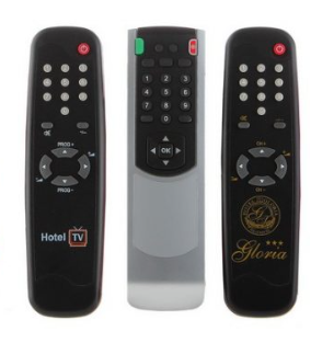

    @MAJSTER XXL, @hevet and colleagues who create your own version based on v2, v3, Evo
    PILOT:
    I had the idea to ask the companies that produce universal remotes in our country for how much they could create a dedicated remote control for our radio.
    These are remote controls for which only the front side is printed and the so-called rubber matrix is adapted to the customer's requirements
    Please let us know what list of buttons we would need. Out of curiosity I will send such an enquiry, we will see how much would a piece of such dedicated remote control cost us.
    I am thinking here for example of the company Elmark Link and remote EL3 or EL8 small
    Three black universal remote controls with number and arrow buttons standing upright
    Black remote control with many buttons, including color and arrow keys
    At the moment I have put together such a list of the buttons needed:

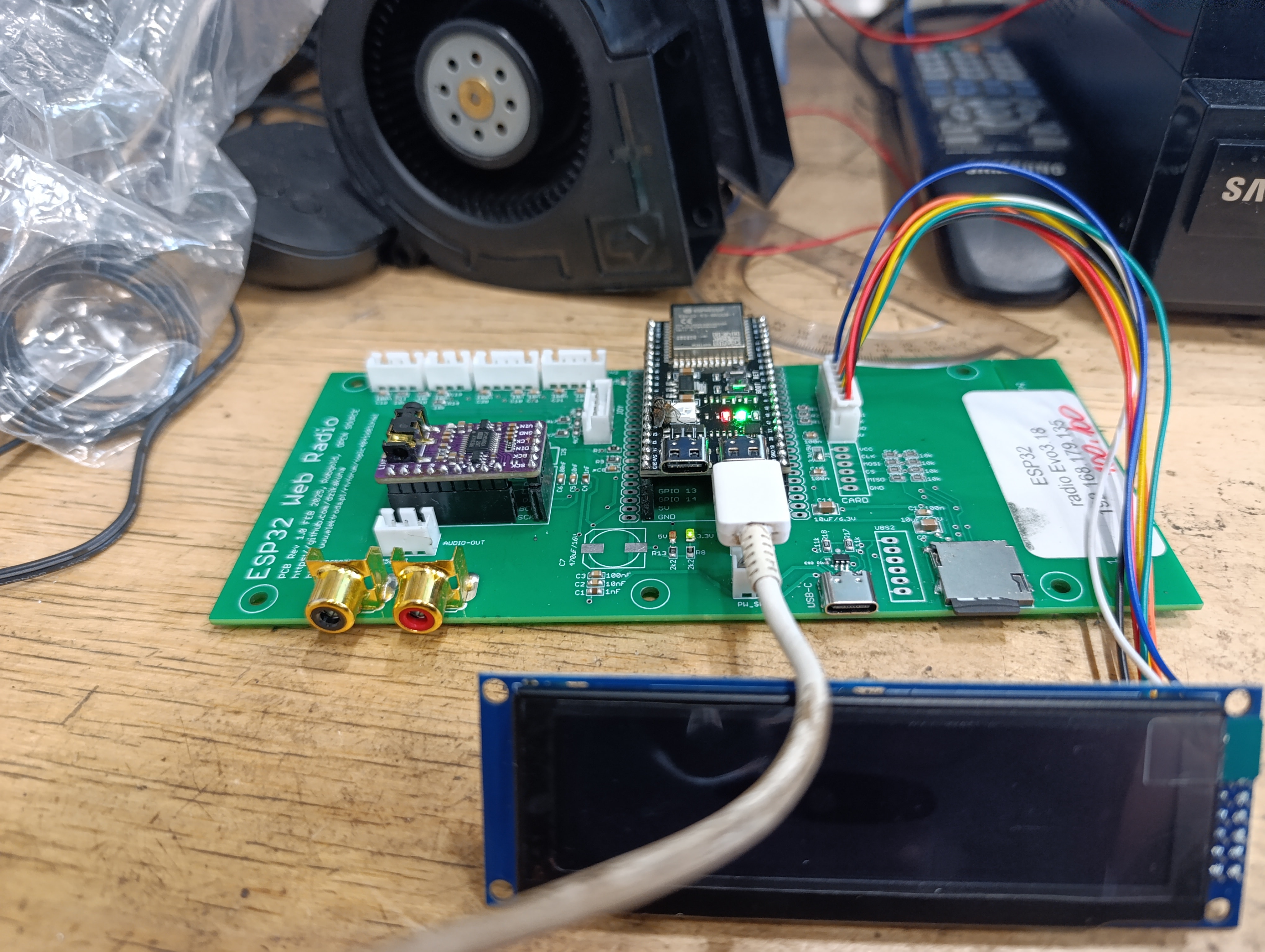

    • Internet radio and audio file player on ESP32-S3 IMG_20251022_201053.jpg (2.89 MB) You must be logged in to download this attachment.
  • USB 5V jumper required for board power
    #1491 21746733
    robgold
    Posts: 726
    Help: 10
    Rate: 290

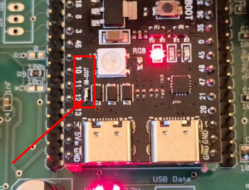

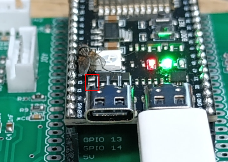

    >>21746721 So there you have my board.
    First important point, ignoring the fly that may have covered this up ;) make a jumper on the ESP PCB. If you want to power the board using USB on the ESP module then you need to supply 5V to the 5V bus (it powers an OLED for example). See that even the 5V LED is not lit. On the ESP module, in order for 5V from USB to appear on the leg labelled 5V there must be a jumper as shown in the picture.
    ESP module with USB connection and highlighted jumper on the PCB
    ESP board with marked jumper needed to supply 5V via USB
    Just for information, because I don't know if you know, you don't have to use an IP to view the radio page.
    On the local network the address works http://evoradio.local because mdns is implemented.

  • 2 mm smoked plexiglass gives best OLED contrast
    #1499 21748395
    robgold
    Posts: 726
    Help: 10
    Rate: 290
    Today, prototype number 2 - that is, how to make a "premium" version of our ESP32 radio enclosure
    I used very faintly smoked plexiglass with a thickness of 2mm. According to my feelings this is probably the best you can use for such a design. The results for the Green are excellent, the yellow is nice but falls slightly into the green, the white OLED performs decently. Blue is the worst performing.
    White:
    OLED display in a dark plexiglass case showing SmoothJazz.com.pl station
    Blue:
    OLED display in a plexiglass case showing ESP32 radio UI with blue text
    Green:
    Green OLED display in a dark plexiglass enclosure showing FLAC audio information
    Yellow:
    Green OLED display in dark plexiglass enclosure showing music playback information
    Green is a bit reminiscent of old alarm clocks from times gone by where a green filter was used for VFD displays ;)
  • #1500 21748422
    irysbox
    Posts: 54
    Rate: 8
    i would put a millimeter of filament at the bottom and top so there would not be an uneven cut in the Plexiglas unless you polish it to perfection :) and I see that you have the screws embedded in the laptop nuts I came up with a similar technique but I put the notch and the nuts square and the pin goes into the hole and the nut
