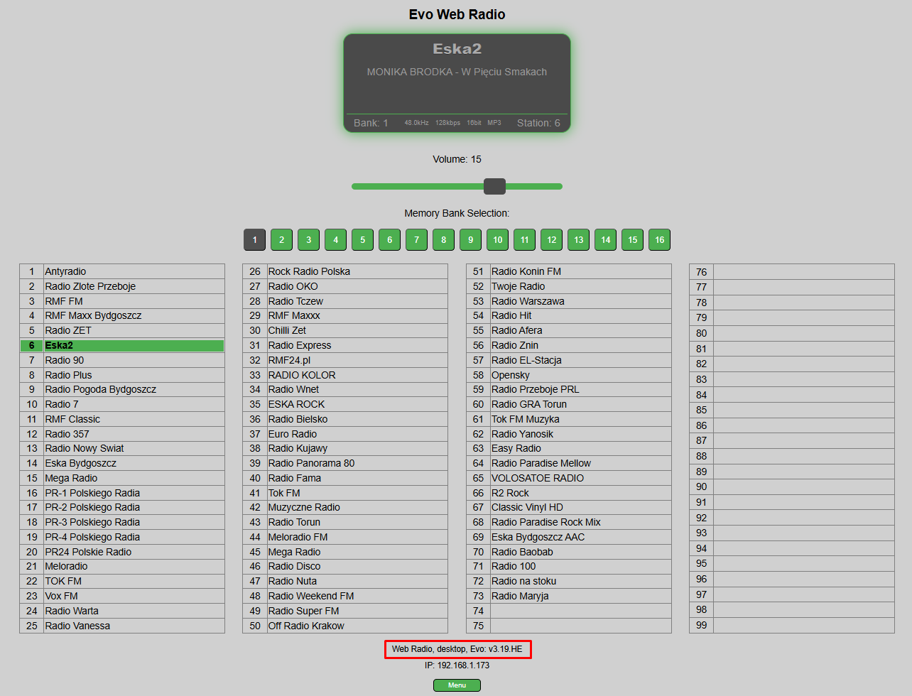

  • New Evo 3.19.32 adds standby, sleep, and no-network modes
    #1505 21748513
    robgold
    Posts: 726
    Help: 10
    Rate: 290
    i uploaded new version Evo 3.19.32 to my GitHub Dzikakun Link
    I have also added a "merged" file to the build directory this time, this can be uploaded using the standard ESP flash tool by uploading the BIN from address 0x0000
    What's new ?
    Power modes
    The radio after power up checks what was the reason for the reset, if it is the result of a power outage it goes into "Standby" mode. I have added a full reset also with RTC registers. Radio can be switched on/off both with IR remote control (red handset) and encoder2 (1x click 0.5 sec turns radio on, to turn off hold down until "POWER OFF" appears)
    Timer in "Standby"
    When the radio is switched off by remote control in this mode, the screen can remain off (black) or display a full-screen clock. Configuration takes place via the website - settings tab. Due to the fact that a new variable has been added to the config.txt file, please run the settings on the www page and re-write the configuration file
    OLED clock display showing time 19:41 in standby mode
    Sleep mode
    Use the green handset button to set the sleep mode. This function works as in Yamaha, Denon, Marantz tuners. With the first click we set the time from 90minutes to 15 minutes. (90->75->60->45->30->15->OFF). If the information about the set sleep time disappears from the display, from now on pressing the sleep button invokes the function showing the set time, another pressing switches sleep off according to the principle 1x click show sleep setting, another click sleep OFF. On the display in all modes the icon of the three letters "Z" appears - "ZZZ" as an indication of the activated SLEEP mode.
    OLED display showing SLEEP 90 MIN in green letters
    Radio display with OLED screen showing current station and active SLEEP mode icon
    No network mode
    In no-network mode when the WiFi manager starts up, the IR remote control works from now on to a limited extent, the radio can be switched off (red handset), and a reset can be performed using the 'back' button. This is a nod to those who use the HotSpot for internet and sometimes forget to switch it on.
    Radiobrowser
    A new 'Radiobrowser' button has appeared in the menu tab. This is a page that uses Radiobrowser servers to search for any radio station in the world. There is a "PLAY" button on the page, which sends the address of the stream and allows you to play the station immediately on the radio. The radio in this mode displays "URL" as the station number, while the bank number disappears from the display. At the moment, it is not possible to automatically transfer links to the selected Bank.
    NOTE: In order for the Radiobrowser website to work, the browser.html file located in the "SD card content" directory must be uploaded to the SD card or SPIFFS memory
    Screenshot of Evo Web Radio menu highlighting the Radio Browser API option
    Radio display shows WIHT-FM ZC Main station with AAC stream and signal indicators.
    Radiobrowser interface showing rock radio stations from the USA with Play buttons
    Volume function "Fadein-Fadeout"
    I have added the "Fadein", "Fadeout" function. Now the station change is done with a pleasing mute and volume. This has eliminated the crackling that sometimes occurred when switching stations. Also in SLEEP mode, when the radio has counted down the preset "bedtime", it will start to slowly mute and then switch off.
    Scrolling through the station list
    I have restored the option to scroll through the station list in the so-called "loop" mode, i.e. being on a station e.g: 99 scrolling by one station will set the list to position no: 1.
    Updating banks with stations
    I am slowly getting around to updating all the banks. A great many stations no longer work, many are duplicated between banks. There will probably be a lot of empty space. At the moment the following have been refreshed:
    Bank1 (treating this one as my list of favourite, handy stations)
    Bank16 contains HiRes FLAC stations
    The rest of the banks are coming soon.

    Evo Web Radio interface with radio station list and active station Eska2 playing
    Thanks for making me realise (through a quick code analysis) that I don't actually have a declaration for the OPUS codec.
