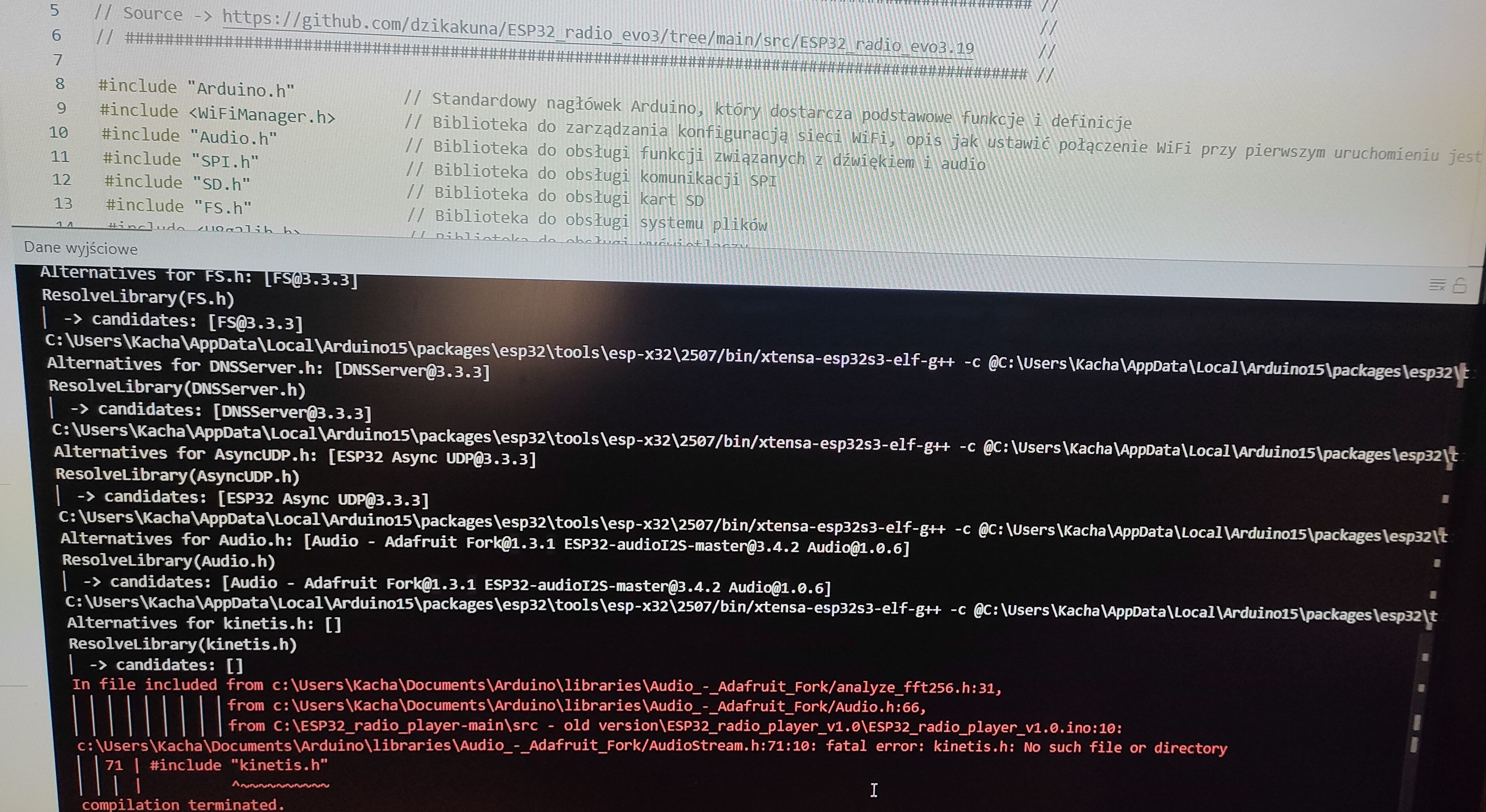

    Hi. This is probably my last attempt at programming the ESP32-S3-N16R8. Something is definitely doing "wrong", I just don't know what. At the moment I have IDE v. 2.3.6, Teensy installed from within the IDE, some changes to the audio libraries and after a while of compiling the message - "Arduino\libraries\Audio_-_Adafruit_Fork/AudioStream.h:71:10: fatal error: kinetis.h: No such file or directory".
    What do I still need to install so that I can finally compile the file correctly and upload it to the ESP?
    After checking the installation instructions given to me by DJCheester, the same error with kinetis.h still occurs.

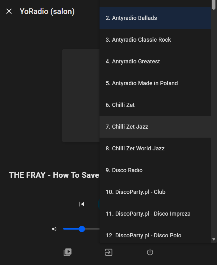

    Good morning,
    First of all I wanted to congratulate the author @robgold - the project is really impressive and very polished. I came across Evo3 while looking for information about YoRadio. When I checked out YoRadio at my place, I decided to give Evo3 a try.
    I have a question about MQTT support. There is MQTT support in YoRadio I just need to fill in the server details to make the device visible in Home Assistant, which enabled me to, among other things, control the radio, select stations and create my own media_player entity. This allows me to send voice notifications (TTS) from Home Assistant directly to the radio, which is very convenient
    Is it planned to add MQTT support in Evo v3, allowing such integration (control, station selection, TTS via Home Assistant)?
    https://github.com/e2002/yoradio?tab=readme-ov-file#home-assistant
    YoRadio widget in Home Assistant playing “How To Save A Life” by The Fray
    YoRadio interface with radio stations list and playback screen in Home Assistant

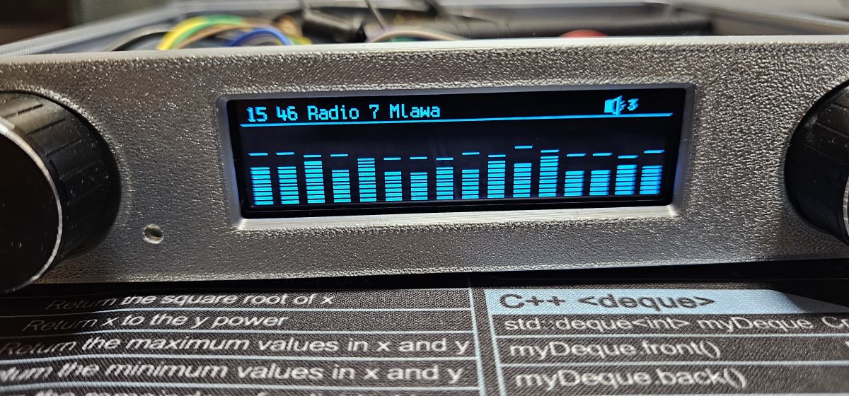

    My suggestion of a pseudo-analyser as style 5 and 6 For those who like gadgets.
    Audio device screen with LED display showing Radio 7 Mława and audio bar visualization. Evo Web Radio settings screen with display and VU meter parameters. Audio device display showing Radio 7 Mława and sound level bars Monitor displaying Evo Web Radio settings with display and VU Meter configuration options Monitor displaying Evo Web Radio settings with display and VU Meter configuration options

  • #1632 21758159

    @ejcon to swap only main.cpp or also the audio library ?
    My attention was drawn to the mouse pad. This is called a programmer's download :D
    Okay, I've already answered myself by analysing the code. I have already corrected this bit_count++ in the latest version.
    Will try to pull it in as mode 5.

    >>21758024
    No integration with MQTT planned at the moment

  • #1635 21758354
    hevet
    Posts: 347
    Rate: 47
    >>21758158 in the latter there are too wide bars, the last one does not fit and is 1 pixel wide
    Must be
    // Bar parameters - 16 bars for the full width of the screen,
    // but with a 1 pixel gap between bars to make them clearly visible
    uint8_t barGap = 1;
    uint8_t barWidth = (SCREEN_WIDTH - (EQ_BANDS - 1) * barGap) / EQ_BANDS;
    if (barWidth < 2) barWidth = 2;

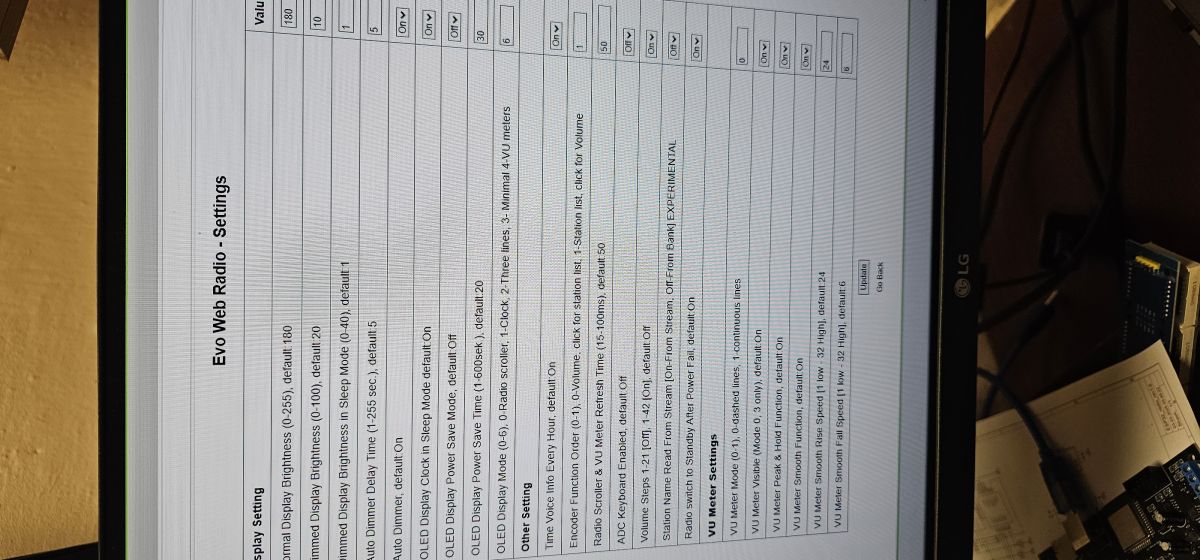

  • #1636 21758738

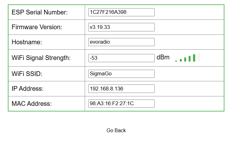

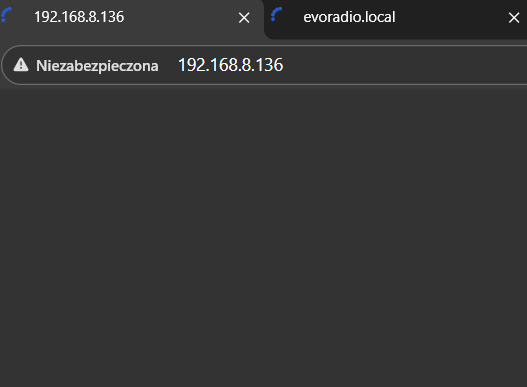

  • Blank configuration page despite SD card working
    #1640 21759003
    ajakubek
    Posts: 10
    @robgold At first I thought there had to be an SD card for the website to work but from what I've read it doesn't. It's just that I don't get the configuration page displayed. I even switched the radio under the mobile router, from the computer, from the phone I still have a blank page under the radio address which cannot load, the radio plays. I added a microSD card reader and also the page does not load. I am uploading logs from the port monitor.

  • #1643 21759045
    ajakubek
    Posts: 10
    >>21759018 page at this address does not want to load spins a circle in the browser. Same thing from phone, computer under 2 different routers. I have already compiled 2x and still the same. I connect to other esp modules on the network without problems.
    Browser tab with IP address 192.168.8.136 showing Not Secure warning
  • #1644 21759066
    irysbox
    Posts: 54
    Rate: 8
    >>21759003 It didn't load under the IP either, but I thought it was blocked by the browser because of an untrusted site, add /menu after the IP address and it will load the menu page
  • Check terminal logs for current IP address
    #1645 21759068
    robgold
    Posts: 726
    Help: 10
    Rate: 290
    >>21759045 You must have something with the network. Have you checked in the log on the terminal that the IP address is correct ? Just because a router assigned you such an IP address previously does not mean that it is the same now. I assume that your radio is playing correctly, or not playing at all?
    Actually, the web server is something I use more often than the encoder on the radio, so I would rule out a software error.
  • #1646 21759069
    ajakubek
    Posts: 10
    @irysbox Beautiful! Helped. And I was looking for what are the names of the subpages but didn't find to type after /
    @robgold yes radio plays normally, downloads banks and time from github.

  • PROG button opens new settings menu
    #1647 21759072
    MAJSTER XXL
    Posts: 2064
    Help: 164
    Rate: 429
    From me today such a new "settings menu" for the v3 version, I used another button on the remote control (in my case the PROG button) to activate it. And how it works:
    PROG - activates or closes the SETTINGS menu.
    Up / Down - moves the selection in the menu.
    OK - enables / disables the selected function.
    The changes are saved immediately to the SD card (settings.txt) and after a power restart the ESP32 reads these parameters from the SD card.
    The update has flown to my github.
    Here's a video of how this functionality works, there will be more options to enable/disable here.
