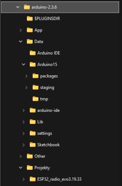

    Hi. This is probably my last attempt to program the ESP32-S3-N16R8. Something is definitely doing "wrong", I just don't know what. At the moment I have IDE v. 2.3.6, Teensy installed from within the IDE, some changes to the audio libraries and after a while of compiling the message - "Arduino\libraries\Audio_-_Adafruit_Fork/AudioStream.h:71:10: fatal error: kinetis.h: No such file or directory".
    What do I still need to install so that I can finally compile the file correctly and upload it to the ESP?
    After checking the installation instructions given to me by DJCheester, the same error with kinetis.h still occurs.
    I was the one who created this manual, I see that you want to compile the Evo radio and remove the Adafruit library because it is the library used when compiling the Majster. Robgold's soft uses u8g2lib for the screen.
    Greetings...
    Added after 5 [minutes]:
    Oh and you may have to clear the temp folder because that's where the Arduino saves temp files.
    I can't remember the paths by heart I can check tomorrow and provide.

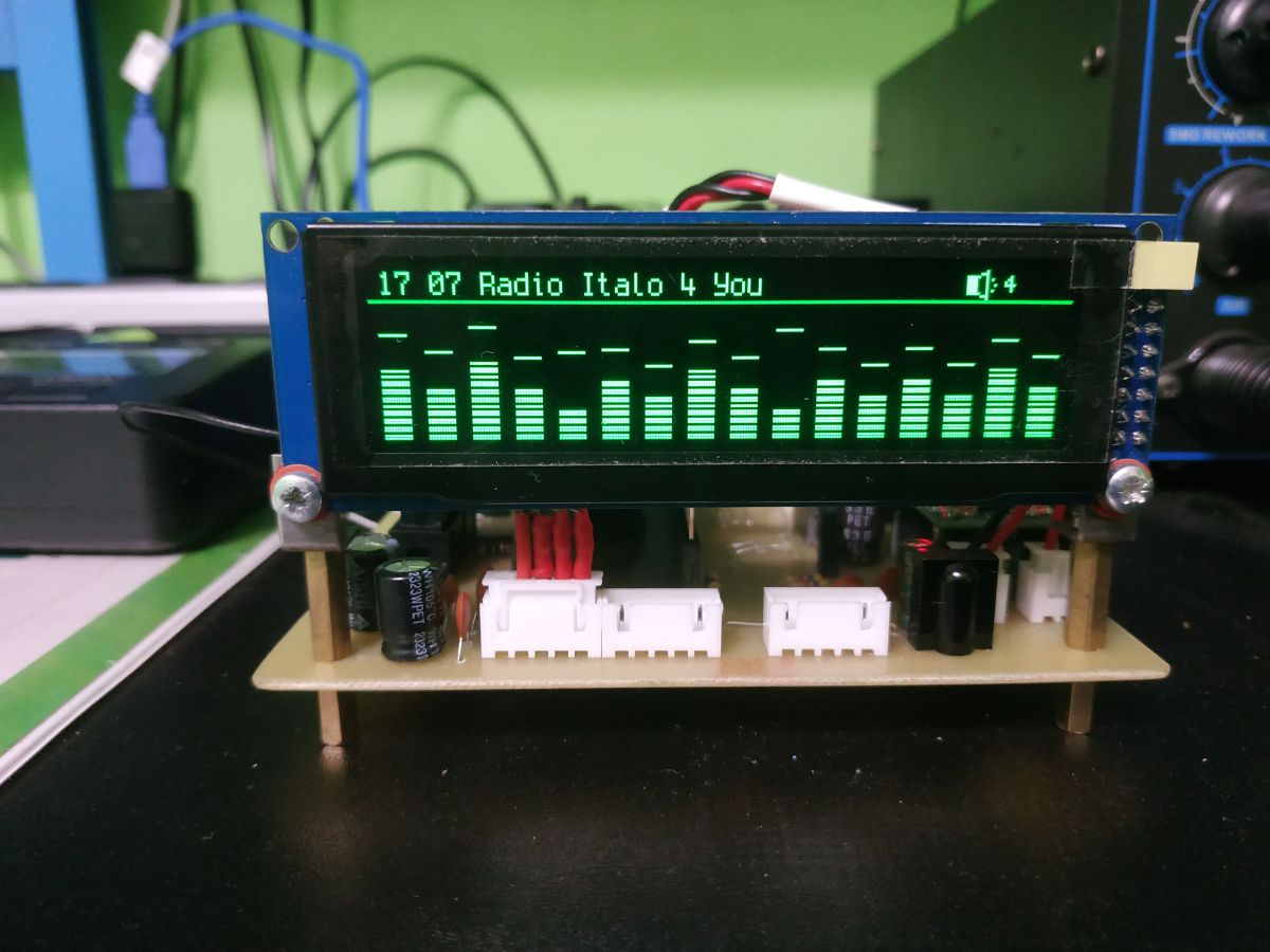

    Hi I have uploaded this your main.cpp file via Arduino renaming it to main.ino so that it can be opened in the Arduino environment (earlier in programmer's notepad I saw that this is the same code as in Arduino)
    It successfully compiled and uploaded to the radio.
    OLED display shows audio equalizer visualization with text Radio Italo 4 You OLED display showing audio spectrum analyzer with radio playback
    I've had a bit of a look at the workings of this pseudo analyser, and yes, to my eye the bars repeat every three jumps probably more in voltage (or digital value) than in a real analyser.
    The question is whether this generally in code has a breakdown of band frequencies ?
    Because yes I can honestly say it looks very artificial, probably the best of all is the peak hold on the bars.

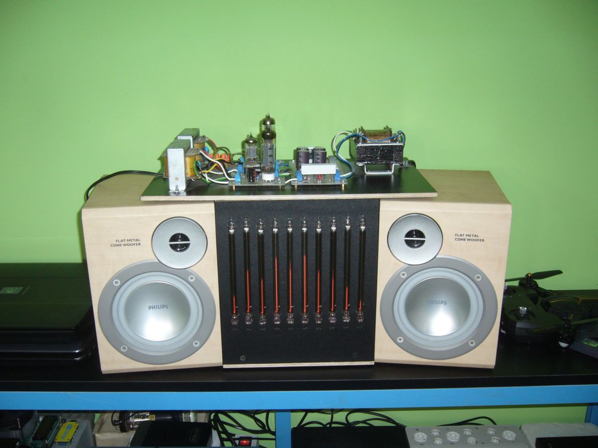

    I once built something like this
    DIY stereo radio with vacuum tubes and front-panel sound visualizer
    And here it is clearly divided into frequencies the first one on the left is responsible for the bass and the last one for the treble
    Is it possible to make this analyser work like this?
    For me, there doesn't have to be so many bars it could be 10 - 12, but it would work better.

    I've had a bit of a look at the workings of this pseudo-analyser, and yes, to my eye the bars repeat every three jumps probably more in voltage (or digital value) than in a real analyser.
    And what does it look like in motion?
    In my opinion this ESP already has a lot of work to do with the radio. On the FFT, it's already rather running out of olbig power.

    These are simple bars calculated from VU values. For mp3 streams the real FFT was still working fine, but from what my colleague and I were discussing FLAC streams required too much power for the FFT to work. For me personally it is a radio and should work as a radio. The FLAC streams are more important than the analyser. If anyone wants to add one for themselves a colleague has provided the code.

    Well, it doesn't look like much, but could a smaller number of bars be used, e.g. 5, 7, but with audio bands?

    Well, it doesn't look interesting, and would it be possible to fire off fewer bars, e.g. 5, 7, but it would go with the audio bands ?
    There is unlikely to be a difference. You have to extract fragments from the whole band anyway.

    Well, it doesn't look interesting, and would fewer bars be able to fire up e.g. 5, 7, but it would go with the audio bands?
    Greetings ...
    The first version with the equalizer provided by colleague @ejcon works like this but long term this requires maintaining your own version and tweaking the audio library.

    No, this is not the pdf. A couple of tabs back is the description:
    https://www.elektroda.pl/rtvforum/topic4041603-1500.html#21748612
    As for the environment, in order not to mess with the arduino configuration for version 3.18 of the radio, I installed the portable version 2.3.6.
    It's important that it's a portable version, because the current zip from the Arduino pages didn't work for me to run as a "sandbox", there are probably problems with version 2 in this topic, but somehow I didn't dig further. Grok gave up :)
    I reinstalled from scratch according to the above description as to each library version, including swapping the two libraries. It compiled without errors, but to be fair, I didn't check that exactly these lib swaps worked, in fact I don't know how to check, but the new files are in the correct directory.
    Arduino downloaded from here:
    https://portable.info.pl/arduino_portable/
    It creates the whole environment in a separate directory, so I currently have versions 3.18 and 3.19 separately.
    You can "develop" versions independently.

    Creates the entire environment in a separate directory, so I currently have versions 3.18 and 3.19 separately.
    You can independently "develop" versions for yourself.
    And don't these version portals use the Arduino15 directory where the core is downloaded ?
    Greetings ...
    Added after 1 [minute]:
    I need 3.2.0 because I also want to upload the Robgold version and this will only temporarily swap.
    Greetings ...
  • Arduino15 is created inside the project directory
    #1677 21759896
    simw
    Posts: 758
    Help: 94
    Rate: 288
    DJCheester wrote:
    Are not these version portals using the Arduino15 directory where the core is downloaded ?
    As far as I have been able to determine it does not, Arduino15 is created inside the directory.
    This is more or less what the tree looks like. The "Projects" directory I created myself.
    The whole thing takes up almost 7.4 GiB once I have adapted to compile version 3.19.33.
    Arduino folder structure with subfolders like Arduino15 and Projekty
