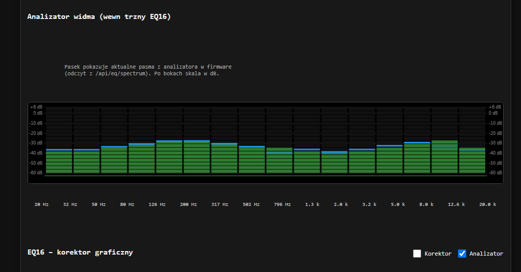

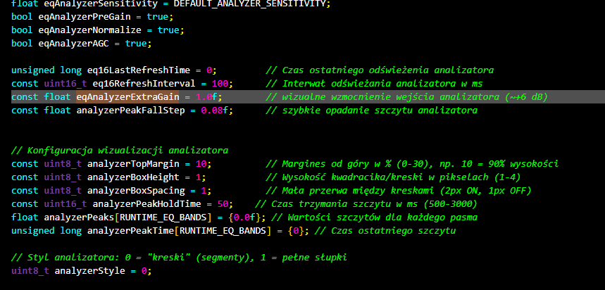

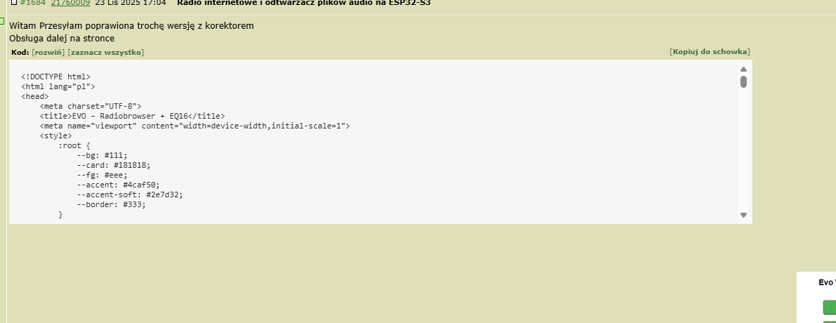

    ejcon wrote:
    I have a version with a real equalizer and eqalizer but there is a problem with the standard AAC and FLAC on these programs the equalizer is turned on it cuts transfers and jerks .
    There is a prefix for automatic operation when ACC and FLAC are on, the equalizer switches itself off or cuts the bands so that it does not jerk, but there is still a problem. Operation of the equalizer via the website .

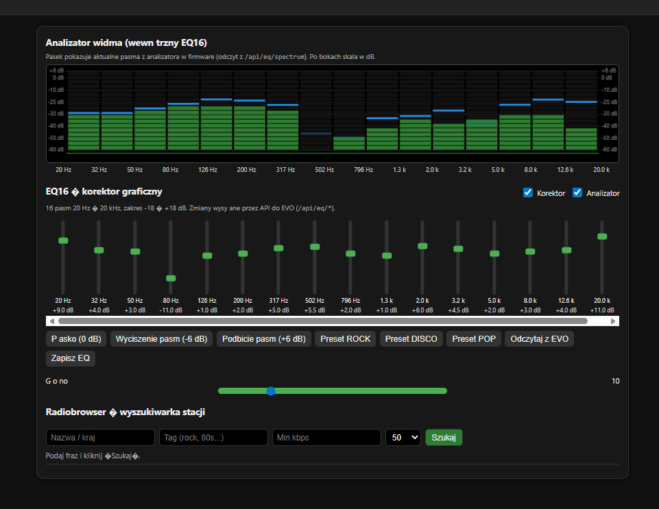

                let norm = (db - DISPLAY_MIN_DB) / (DISPLAY_MAX_DB - DISPLAY_MIN_DB);
                if (norm < 0) norm = 0;
                if (norm > 1) norm = 1;
                const y = paddingTop + innerH - norm * innerH;
                ctx.beginPath();
                ctx.moveTo(marginLeft, y);
                ctx.lineTo(w - marginRight, y);
                ctx.stroke();
                const label = (db > 0 ? '+' : '') + db + ' dB';
                ctx.textAlign = 'right';
                ctx.fillText(label, marginLeft - 4, y);
                ctx.textAlign = 'left';
                ctx.fillText(label, w - marginRight + 4, y);
            if (!levels || !levels.length) return;
            const n = levels.length;
            if (peakLevels.length !== n) {
                peakLevels = new Array(n).fill(0);
                peakHold   = new Array(n).fill(0);
                peakAlpha  = new Array(n).fill(0);
            const barGap = 3;
            const totalGap = barGap * (n + 1);
            const barWidth = Math.max(3, (innerW - totalGap) / n);
            const steps = 18;
            for (let i = 0; i < n; i++) {
                // z firmware dostajemy 0..1 odpowiadaj ce -60..0 dB
                const vIn = levels[i];
                let dbVal = vIn * 60 - 60; // -60..0
                if (dbVal < -60) dbVal = -60;
                if (dbVal > 0) dbVal = 0;
                // przeskalowanie do zakresu -60..+6 (wizualnie)
                let v = (dbVal - DISPLAY_MIN_DB) / (DISPLAY_MAX_DB - DISPLAY_MIN_DB);
                if (v < 0) v = 0;
                if (v > 1) v = 1;
                // peak-hold
                if (v >= peakLevels[i]) {
                    peakLevels[i] = v;
                    peakHold[i]   = 0;
                    peakAlpha[i]  = 1.0;
                } else {
                    if (peakHold[i] < PEAK_HOLD_FRAMES) {
                        peakHold[i]++;
                    } else {
                        peakLevels[i] = Math.max(0, peakLevels[i] - PEAK_FALL_STEP);
                        peakAlpha[i]  = Math.max(0, peakAlpha[i] * PEAK_FADE_FACTOR);
                const activeSteps = Math.round(v * steps);
                const x = marginLeft + barGap + i * (barWidth + barGap);
                const stepH = innerH / steps;
                // kostki s upka
                for (let s = 0; s < steps; s++) {
                    const y = paddingTop + innerH - (s + 1) * stepH;
                    if (s < activeSteps) {
                        const frac = (s + 1) / steps;
                        if (frac < 0.6) {
                            ctx.fillStyle = '#2e7d32';
                        } else if (frac < 0.85) {
                            ctx.fillStyle = '#f9a825';
                        } else {
                            ctx.fillStyle = '#e53935';
                    } else {
                        ctx.fillStyle = '#111';
                    ctx.fillRect(x, y, barWidth, stepH - 1);
                // niebieski peak z wygaszaniem
                const peakV = peakLevels[i];
                const alpha = peakAlpha[i];
                if (peakV > 0.001 && alpha > 0.01) {
                    const peakY = paddingTop + innerH - peakV * innerH;
                    ctx.save();
                    ctx.globalAlpha = alpha;
                    ctx.fillStyle = '#2196f3';
                    ctx.fillRect(x, peakY - 2, barWidth, 3);
                    ctx.restore();
            ctx.fillStyle = '#1b5e20';
            ctx.fillRect(marginLeft, h - paddingBottom + 4, innerW, 2);
        async function spectrumLoop() {
            const POLL_MS = 120;
            while (true) {
                let bands = [];
                try {
                    const resp = await fetch('/api/eq/spectrum');
                    if (resp.ok) {
                        const data = await resp.json();
                        if (data && Array.isArray(data.bands)) {
                            bands = data.bands;
                } catch (e) {
                    // brak endpointu – nic nie rysujemy
                drawSpectrum(bands);
                await new Promise(r => setTimeout(r, POLL_MS));
        spectrumLoop();
        // ------- EQ16 + cz stotliwo ci -------
        const EQ_BANDS = 16;
        const freqs = [];
        (function computeFreqs() {
            const f0 = 20, f1 = 20000;
            for (let i = 0; i < EQ_BANDS; i++) {
                const t = i / (EQ_BANDS - 1);
                const f = f0 * Math.pow(f1 / f0, t);
                freqs.push(f);
        const anFreqLabelsDiv = document.getElementById('anFreqLabels');
        function createAnalyzerLabels() {
            anFreqLabelsDiv.innerHTML = '';
                const div = document.createElement('div');
                div.className = 'an-freq-label';
                const f = freqs[i];
                div.textContent = f < 1000 ? Math.round(f) + ' Hz'
                                           : (f / 1000).toFixed(1) + ' k';
                anFreqLabelsDiv.appendChild(div);
        const eqSlidersBox = document.getElementById('eqSliders');
        const eqEnabledCheck = document.getElementById('eqEnabled');
        const anEnabledCheck = document.getElementById('anEnabled');
        let eqGains = new Array(EQ_BANDS).fill(0);
        function createEqUI() {
            eqSlidersBox.innerHTML = '';
                const bandDiv = document.createElement('div');
                bandDiv.className = 'eq-band';
                const wrap = document.createElement('div');
                wrap.className = 'eq-slider-wrap';
                const slider = document.createElement('input');
                slider.type = 'range';
                slider.min = '-18';
                slider.max = '18';
                slider.step = '0.5';
                slider.value = '0';
                slider.className = 'eq-slider';
                slider.dataset.band = String(i);
                slider.addEventListener('input', onSliderInput);
                slider.addEventListener('change', onSliderChange);
                wrap.appendChild(slider);
                bandDiv.appendChild(wrap);
                const label = document.createElement('div');
                label.className = 'eq-band-label';
                const f = freqs[i];
                label.textContent = f < 1000 ? Math.round(f) + ' Hz'
                                             : (f/1000).toFixed(1) + ' k';
                bandDiv.appendChild(label);
                const gain = document.createElement('div');
                gain.className = 'eq-band-gain';
                gain.id = 'eqGain' + i;
                gain.textContent = '0 dB';
                bandDiv.appendChild(gain);
                eqSlidersBox.appendChild(bandDiv);
        function onSliderInput(e) {
            const band = parseInt(e.target.dataset.band, 10);
            const val = parseFloat(e.target.value);
            const gainLabel = document.getElementById('eqGain' + band);
            gainLabel.textContent = (val > 0 ? '+' : '') + val.toFixed(1) + ' dB';
        function onSliderChange(e) {
            eqGains[band] = val;
            sendBandToDevice(band, val);
        function setAll(v) {
            eqGains = eqGains.map(() => v);
            const sliders = eqSlidersBox.querySelectorAll('.eq-slider');
            sliders.forEach((sl, i) => {
                sl.value = v;
                const lbl = document.getElementById('eqGain' + i);
                lbl.textContent = (v > 0 ? '+' : '') + Number(v).toFixed(1) + ' dB';
            sendAllToDevice();
        // Presety ROCK / DISCO / POP
        function applyPreset(name) {
            let curve = new Array(EQ_BANDS).fill(0);
            if (name === 'rock') {
                curve = [5, 4, 3, 2, 1, 0, -1, -2, -2, -1, 0, 1, 2, 3, 4, 5];
            } else if (name === 'disco') {
                curve = [6, 5, 4, 3, 2, 1, 0, -1, -1, 0, 1, 2, 3, 4, 5, 6];
            } else if (name === 'pop') {
                curve = [3, 2, 1, 0, 0, 0, -1, -1, -1, 0, 1, 2, 3, 3, 3, 3];
            eqGains = curve.slice(0, EQ_BANDS);
                const g = eqGains[i] || 0;
                sl.value = g;
                lbl.textContent = (g > 0 ? '+' : '') + g.toFixed(1) + ' dB';
            sendAllToDevice();
            saveEQToDevice();
        async function reloadFromDevice() {
            try {
                const resp = await fetch('/api/eq/state');
                if (!resp.ok) throw new Error('HTTP ' + resp.status);
                eqEnabledCheck.checked = !!data.enabled;
                if ('analyzer' in data) {
                    anEnabledCheck.checked = !!data.analyzer;
                if (Array.isArray(data.gains)) {
                    eqGains = data.gains.slice(0, EQ_BANDS).map(g => parseFloat(g) || 0);
                        sl.value = g;
            } catch (e) {
                alert('Nie uda o si  odczyta  EQ z /api/eq/state');
        function sendBandToDevice(band, gain) {
            const url = '/api/eq/band?band=' + encodeURIComponent(band) +
                        '&gain=' + encodeURIComponent(gain.toFixed(2));
            fetch(url).catch(() => {});
        function sendAllToDevice() {
            const params = new URLSearchParams();
            eqGains.forEach((g, i) => {
                params.append('g' + i, g.toFixed(2));
            fetch('/api/eq/set?' + params.toString()).catch(() => {});
        async function saveEQToDevice() {
            try {
                const resp = await fetch('/api/eq/save');
                alert('EQ zapisany do pliku.');
            } catch (e) {
                alert('B  d zapisu EQ: ' + e.message);
        eqEnabledCheck.addEventListener('change', () => {
            const on = eqEnabledCheck.checked ? 1 : 0;
            fetch('/api/eq/enable?on=' + on).catch(() => {});
        anEnabledCheck.addEventListener('change', () => {
            const on = anEnabledCheck.checked ? 1 : 0;
            fetch('/api/eq/analyzer?on=' + on).catch(() => {});
        createAnalyzerLabels();
        createEqUI();
        reloadFromDevice();
        // ------- VOLUME przez WebSocket -------
        const volSlider = document.getElementById('volSlider');
        const volValue  = document.getElementById('volValue');
        let websocket = null;
        function setVolumeLabel(v) {
            volValue.textContent = v;
        function updateSliderVolume() {
            const sliderValue = volSlider.value;
            setVolumeLabel(sliderValue);
            if (websocket && websocket.readyState === WebSocket.OPEN) {
                websocket.send("volume:" + sliderValue);
            } else {
                console.warn("WebSocket niepo  czony");
        function connectWebSocket() {
            websocket = new WebSocket('ws://' + window.location.hostname + '/ws');
            websocket.onopen = function () {
                console.log("WebSocket po  czony (EQ panel)");
            websocket.onclose = function () {
                console.log("WebSocket zamkni ty – reconnect za 3s");
                setTimeout(connectWebSocket, 3000);
            websocket.onerror = function (error) {
                console.error("B  d WebSocket:", error);
                websocket.close();
            websocket.onmessage = function (event) {
                if (event.data.startsWith("volume:")) {
                    const vol = parseInt(event.data.split(":")[1]);
                    if (!isNaN(vol)) {
                        volSlider.value = vol;
                        setVolumeLabel(vol);
        volSlider.addEventListener('input', () => {
            setVolumeLabel(volSlider.value);
        volSlider.addEventListener('change', () => {
            updateSliderVolume();
        volSlider.addEventListener("wheel", function (event) {
            event.preventDefault();
            let currentValue = parseInt(volSlider.value);
            const step = parseInt(volSlider.step) || 1;
            const max = parseInt(volSlider.max);
            const min = parseInt(volSlider.min);
            if (event.deltaY < 0) {
                volSlider.value = Math.min(currentValue + step, max);
            } else {
                volSlider.value = Math.max(currentValue - step, min);
        connectWebSocket();
        // ------- Radiobrowser -------
        const statusEl = document.getElementById('status');
        const resultsEl = document.getElementById('results');
        const API_RB = 'https://de1.api.radio-browser.info/json/stations/search';
        document.getElementById('btnSearch').addEventListener('click', searchStations);
        document.getElementById('q').addEventListener('keydown', e => {
            if (e.key === 'Enter') searchStations();
        async function searchStations() {
            const q = document.getElementById('q').value.trim();
            const tag = document.getElementById('tag').value.trim();
            const minBr = document.getElementById('minBr').value.trim();
            const limit = document.getElementById('limit').value;
            if (!q && !tag) {
                statusEl.textContent = 'Podaj przynajmniej nazw  lub tag.';
                return;
            statusEl.textContent = 'Szukam...';
            resultsEl.innerHTML = '';
            if (q) params.append('name', q);
            if (tag) params.append('tag', tag);
            params.append('hidebroken', 'true');
            params.append('limit', limit);
            if (minBr) params.append('bitrate_min', minBr);
            try {
                const resp = await fetch(API_RB + '?' + params.toString());
                if (!Array.isArray(data) || data.length === 0) {
                    statusEl.textContent = 'Brak wynik w.';
                    return;
                statusEl.textContent = 'Znaleziono ' + data.length + ' stacji.';
                data.forEach(addStationRow);
            } catch (e) {
                statusEl.textContent = 'B  d pobierania: ' + e.message;
        function addStationRow(s) {
            div.className = 'station';
            const metaBox = document.createElement('div');
            metaBox.className = 'station-meta-box';
            const name = document.createElement('div');
            name.className = 'station-name';
            name.textContent = s.name || '(bez nazwy)';
            const meta = document.createElement('div');
            meta.className = 'station-meta';
            const country = s.country || '';
            const br = s.bitrate ? s.bitrate + ' kbps' : '';
            const codec = s.codec || '';
            meta.textContent = [country, br, codec].filter(Boolean).join(' • ');
            const url = document.createElement('div');
            url.className = 'station-url';
            url.textContent = s.url_resolved || s.url || '';
            metaBox.appendChild(name);
            metaBox.appendChild(meta);
            metaBox.appendChild(url);
            const actions = document.createElement('div');
            actions.className = 'station-actions';
            const btnSet = document.createElement('button');
            btnSet.className = 'btn-small';
            btnSet.textContent = 'Ustaw w EVO';
            btnSet.onclick = () => sendToEvo(s);
            actions.appendChild(btnSet);
            const btnCopy = document.createElement('button');
            btnCopy.className = 'btn-small';
            btnCopy.textContent = 'Kopiuj URL';
            btnCopy.onclick = () => copyUrl(url.textContent);
            actions.appendChild(btnCopy);
            div.appendChild(metaBox);
            div.appendChild(actions);
            resultsEl.appendChild(div);
        function copyUrl(url) {
            if (!url) return;
            navigator.clipboard.writeText(url)
                .then(() => statusEl.textContent = 'Skopiowano URL.')
                .catch(() => statusEl.textContent = 'Nie uda o si  skopiowa .');
        function sendToEvo(st) {
            const url = st.url_resolved || st.url || '';
            if (!url) return;
            const name = st.name || 'Radio';
            const href = '/update?url=' + encodeURIComponent(url) +
                         '&name=' + encodeURIComponent(name);
            statusEl.textContent = 'Wysy am URL do EVO...';
            fetch(href)
                .then(() => statusEl.textContent = 'URL wys any.')
                .catch(() => statusEl.textContent = 'B  d wysy ania URL.');
    </script>
    </body>
    </html>

    Mi after winning the software via Arduino IDE (as before) the radio started to play very quietly normally I listen to 3-4 volume now on 15-20 I have this volume, in addition it plays only on one channel.
    And when displaying the analyser there is something like this

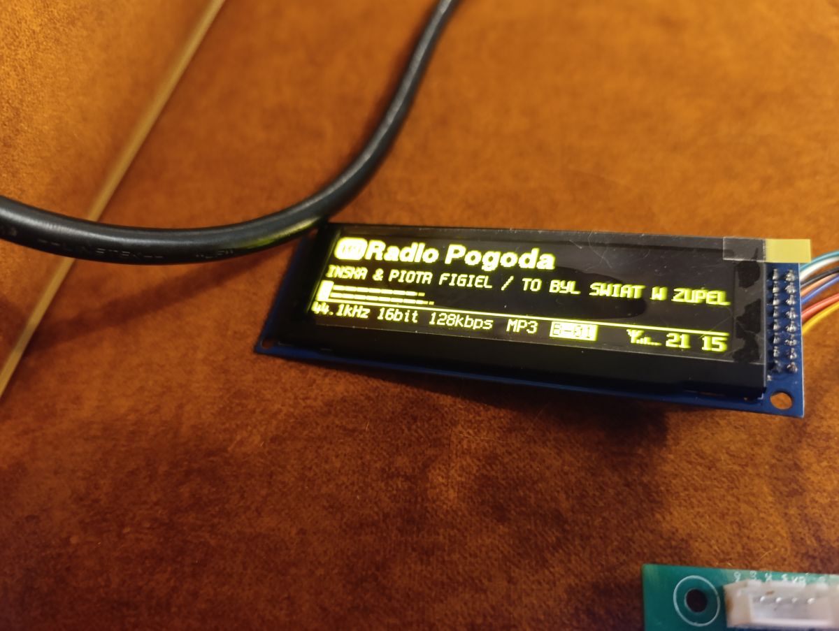

    LCD module displaying “Radio Złote Przeboje” and the song “Careless Whisper”.
    And immediately after firing up the mute is switched on I have to mute with the remote control.

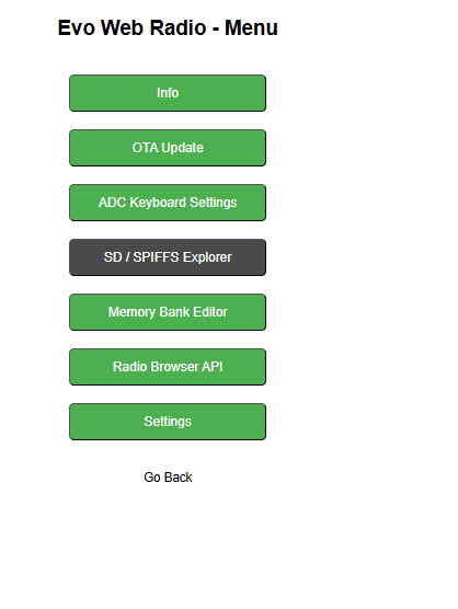

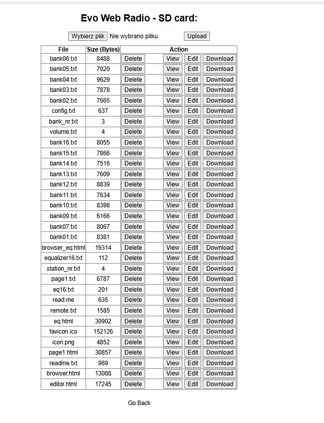

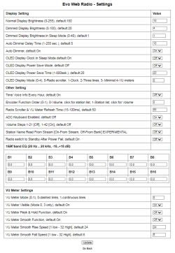

  • #1685 21760010
    DJCheester
    Level 28  
    Posts: 2089
    Help: 75
    Rate: 958

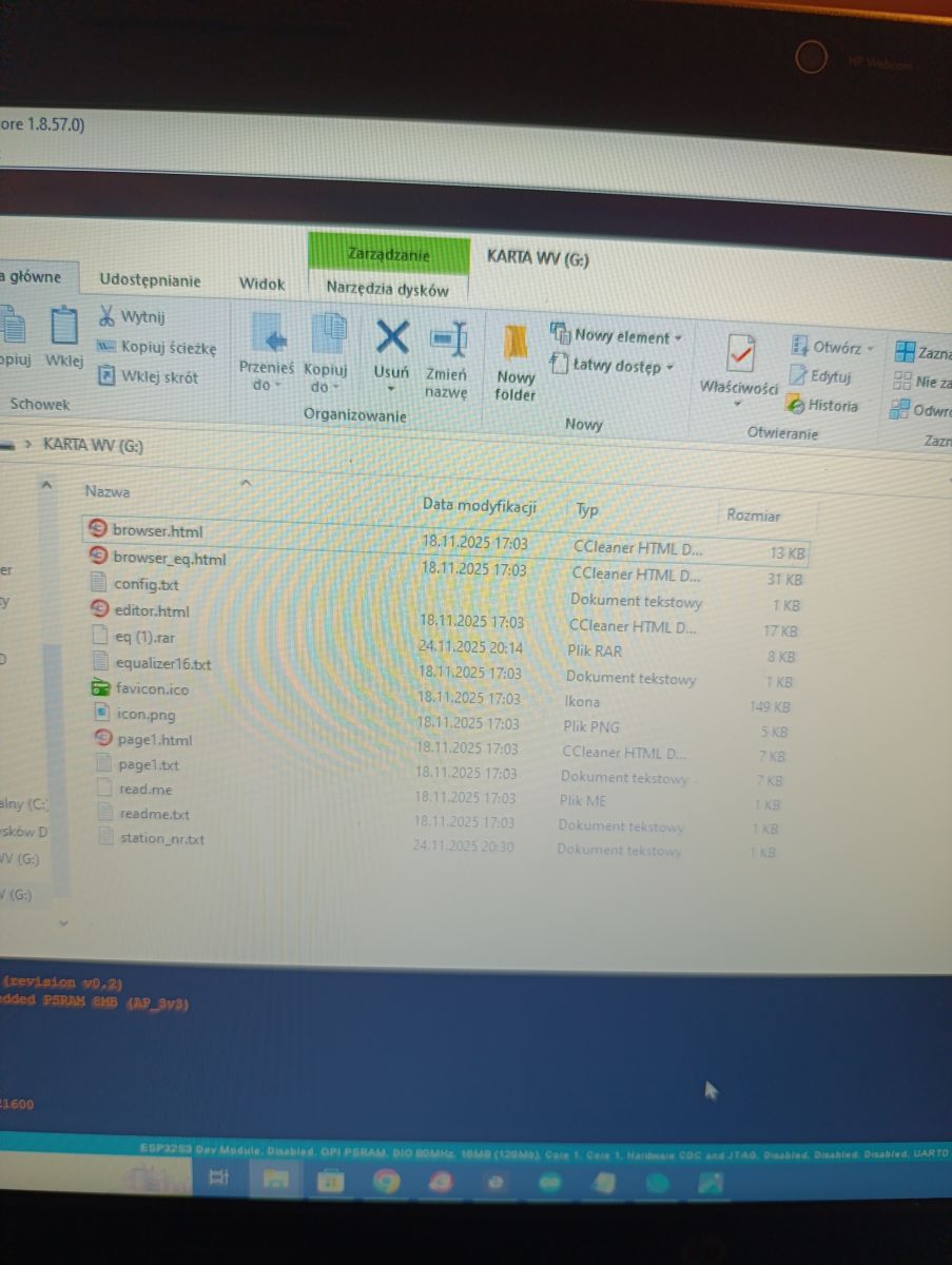

    Okay I'll upload it soon but tell me how to display it on the screen can you send me the config.txt file or tell me how to set it up ???
    And why do I have silence on one channel and no sound at all on the other ???
    Greetings ...
    Added after 3 [minutes]:
    How to get to the page that you show ??
    Umnie is only this ??

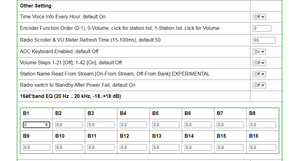

    Evo Web Radio settings panel with various display and sound configuration options
  • #1686 21760018
    ejcon
    Posts: 301
    Rate: 68
    >>21760010 Download the latter, as the earlier one was with errors. Check this one with the screens, it should be ok.

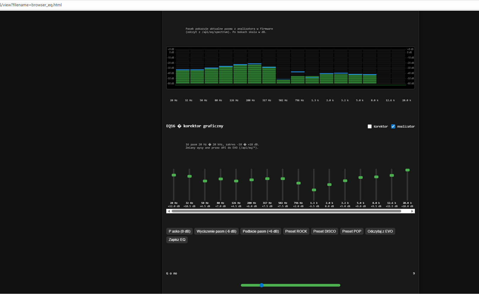

  • #1687 21760023
    DJCheester
    Level 28  
    Posts: 2089
    Help: 75
    Rate: 958
    Well, I am loading but tell me how to get this page what screen you have attached the code you gave in the box where to use it??
    Can you provide me with this browser eq html?
  • Equalizer and analyzer toggled from page1
    #1688 21760039
    ejcon
    Posts: 301
    Rate: 68
    You have the code for the equalizer and the equalizer on the code.
    expand copy and paste into page1 then preview and you have two selections one for the equalizer runs the equalizer and the other for the analyzer if it is checked then uncheck and check again and the analyzer runs the display and on the page
    Here is the code Screenshot from a forum showing HTML code fragment with CSS styling

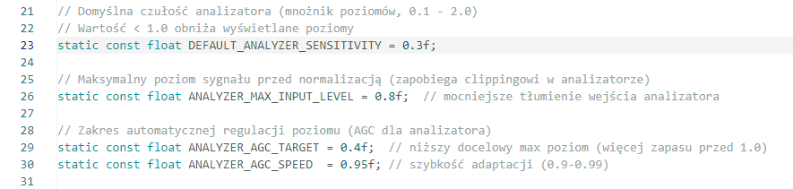

    Thought for 17s
    Okay, let's put this together, because in this project you have two places that behave as "PID / AGC" for the analyser:
    AGC of the analyser in AudioRuntimeEQ_Evo.* - this now actually controls the "gain" of the bars.

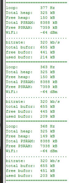

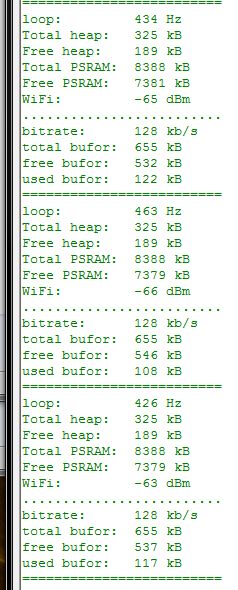

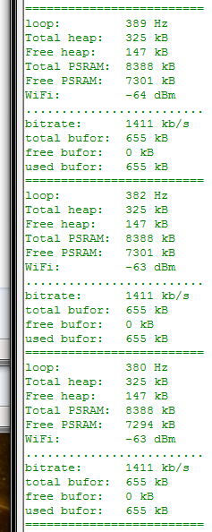

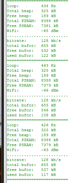

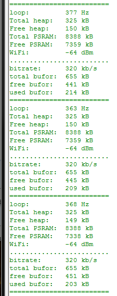

    In the pictures a bit of data from the radio. The software is completely different, but based on rogbold's libraries
    You can compare how it behaves at different bitrates:
    Screenshot of radio system diagnostics at 128 kb/s bitrate
    Debug screen showing ESP memory, WiFi signal, and 320 kB/s bitrate in three readings
    Screenshot of diagnostic data at 1411 kb/s bitrate, showing memory and buffer usage

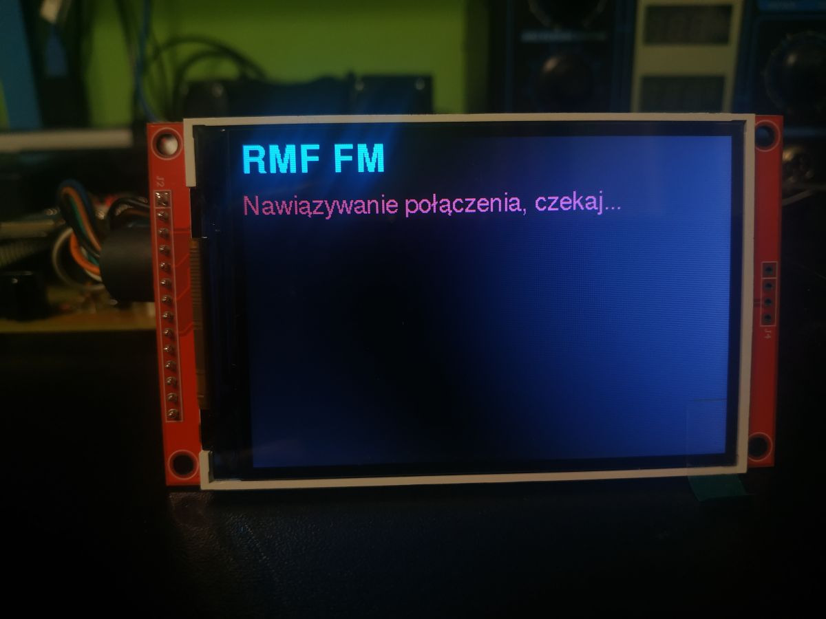

    Sometimes it won't even let me near the router to connect to the wifi - from the serial it says it can't see my network and puts out an AP
    Even when the radio near the router is there - possibly a problem with the mains charger too close - I'll work it out I'll power it from a powerbank on a longer cable etc
    On screen only Hello listener
    The next log is when it hangs on connected to wifi
    Here you can see that it has connected and there is a message connected to the network
    And the last log where it hangs here
    Close-up of a touchscreen showing “Connecting, please wait…” for RMF FM
    And the log
    Here it always stops at the same place

    And here I've already noticed yesterday that in order to run the spectrum analyzer as a screen after a power reset, you have to go to the website uncheck the analyzer and equalizer and then check the analyzer then only the analyzer shows up on the radio screen before there is such a thing.
    Is it possible to do something about it, so that it saves somewhere (preferably on SD card or (I use SPIFFS)) the status, because I often use the remote control and I hardly enter the page unless I change some configuration.
    Another thing is also from the remote control when the analyser is playing and we make the volume lower, then for a split second the volume screen enters but quickly disappears even you can not see the bar (volume responds) but as if on top is always the analyser ???
    I know you wrote that you operate through a server, do you plan to integrate this with the remote control and save settings ?

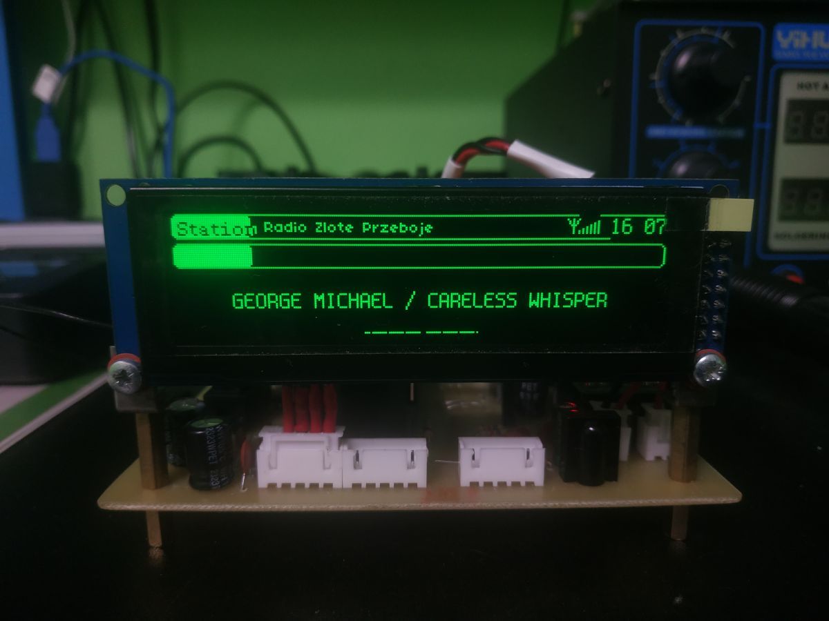

    Radio display showing station Radio Złote Przeboje and song George Michael
    ejcon wrote:
    Thought for 17s
    - what's that because I don't get it ?
    I'm about to play around with these variables and see how it works.
    Greetings ...
    Added after 16 [minutes]:
    ejcon wrote:
    Example of test set:
    static const float ANALYZER_MAX_INPUT_LEVEL = 0.45f;
    static const float ANALYZER_AGC_TARGET = 0.50f;
    static constat ANALYZER_AGC_SPEED = 0.95f;
    Ok let's focus on that, because what you wrote above is, for me, a higher level of driving.
    After uploading with these settings - the radio plays quietly i.e. not as before (vol3-6) the same volume i have (vol15-20)
    Well, but the analyser is higher now and it is possible to raise it still you can give other values in the direction of raising the bars because currently they come at full volume to this value

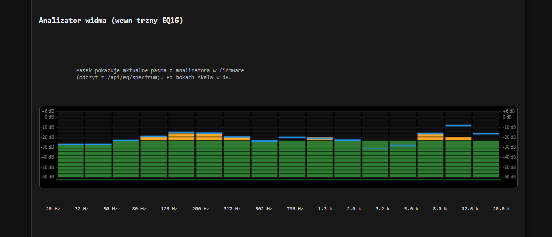

    Bar graph spectrum analyzer EQ16 with “Analyzer” checkbox selected
    Oh and just by using the remote control to change the view and going back to the analyser it is no longer there is this screen I have attached again marking and ticking makes the analozator come back.
    Unchecking and selecting on the page makes the analyser appear from virtually every view.
    Greetings ...

    >>21760849 Unzip the file you have attached download it with Evo Web Radio SD card file manager interface showing file list and actions http:/ip of the radio /eq you already have running you can check if it can't be started from the remote control under Audio
    For me it looks like this at 10 Volume on this set what you have attached EQ16 graphic equalizer interface with spectrum analyzer and frequency sliders What remote you have because maybe you could send me a file to operate if it is not the one from the original because I'm waiting for shipment to be able to run it from the remote and see if it works .

    It's like this, after uploading and resetting the radio the uV meters died and on the eq page there is another screen but also as undesirable as before everything is scattered and the analyser is not there.
    I did not recompile anything but rebooted
    And as for the altitude they are higher so at -20 db
    and the issue of volume, I think I understand you have an extended range there, because on the slider I can do 30 and more volume, where with the remote control I could only do 21 - well, on 30 it plays loud as before on 10 or 12 about
    Greetings ...

    The level of posts is acceptable with these settings
    C++ code snippet defining audio analyzer parameters including sensitivity and AGC limits
    Bar chart from EQ16 spectrum analyzer showing frequency levels in dB
    Maybe I'll pick up a bit more but that's tomorrow

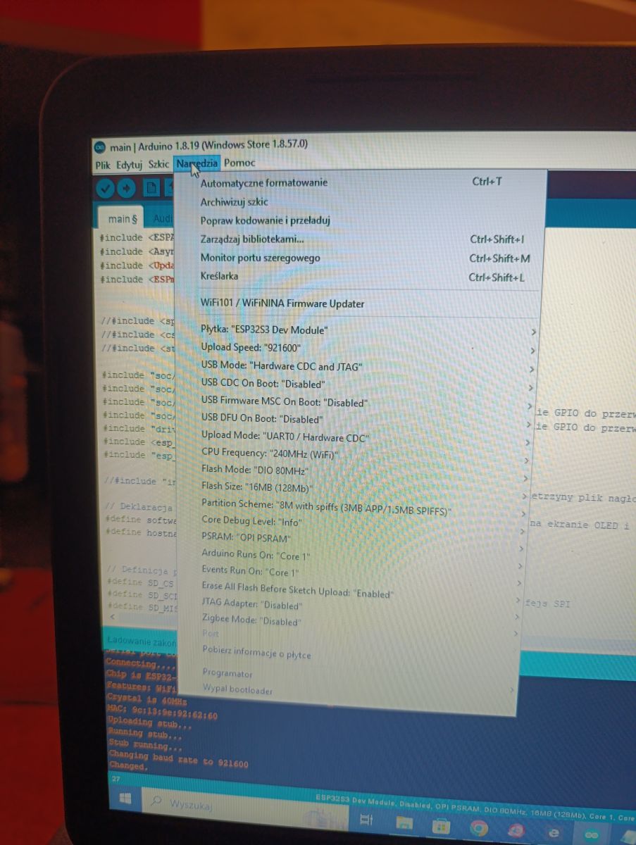

    I have such a problem everything compiles nicely without any errors but at the very end I find that after uploading the device resets all the time when trying to find the network.
    I have already checked on two Arduino 2.3.6 and 1.18.19 the effect is the same.

  • Updated equalizer bars and analyser input adjustment
    #1704 21761157
    ejcon
    Posts: 301
    Rate: 68
    The newer version of the equalizer and equalizer the bars look better
    here we can adjust the input signal of the analyser whether it is with or without an amplifier C++ code snippet configuring an audio analyzer with Polish comments Look of the bars on the analyser . the equalizer is started from the eq file still only supported by the website upload the file from RAR http://ip of the radio /eq to the sd file
    • eq.rar (7.19 KB) You must be logged in to download this attachment.
    • main.cpp (373.13 KB) You must be logged in to download this attachment.
    • AudioRuntimeEQ_Evo.h (3.93 KB) You must be logged in to download this attachment.
    • AudioRuntimeEQ_Evo.cpp (27.36 KB) You must be logged in to download this attachment.
  • #1705 21761212
    Jarosław 1808
    Posts: 129
    What files should be on the sd card?
  • WiFi manager may fail on hotspot name characters
    #1706 21761221
    robgold
    Posts: 726
    Help: 10
    Rate: 290
    >>21761212 In fact, there may be nothing. For commissioning I recommend this option. The radio will create everything for itself. Only Bank Editor and Radiobrowser won't work, because these are html files that should be on the card. And what are your settings in Arduino? PSRAM correctly selected? Module? Have you done a FLASH memory erase ?
    I'm still wondering if WiFi Manager has a problem with the hotspot name: "NETIASPOT-f5Pj 2.4G" and a comma in the name.
  • #1707 21761222
    Jarosław 1808
    Posts: 129
    Tools menu in Arduino IDE 1.8.19 showing settings for ESP32 board
    Screenshot of file explorer showing SD card KARTA WV (G with HTML, TXT, and image files Added at 2 [minutes]:
    Sd card
  • #1708 21761233
    robgold
    Posts: 726
    Help: 10
    Rate: 290
    >>21761222 Was your radio working on this WIFi before ? Because it's quite unusual to put a comma in the name of a WiFi but maybe I'm a DOS man and even spaces I prefer to replace _ ;)

    Added after 17 [minutes]:
    OLED display showing Radio Pogoda and track info with bitrate and codec details
    Added after 51 [seconds]:
    Winnings from your file
