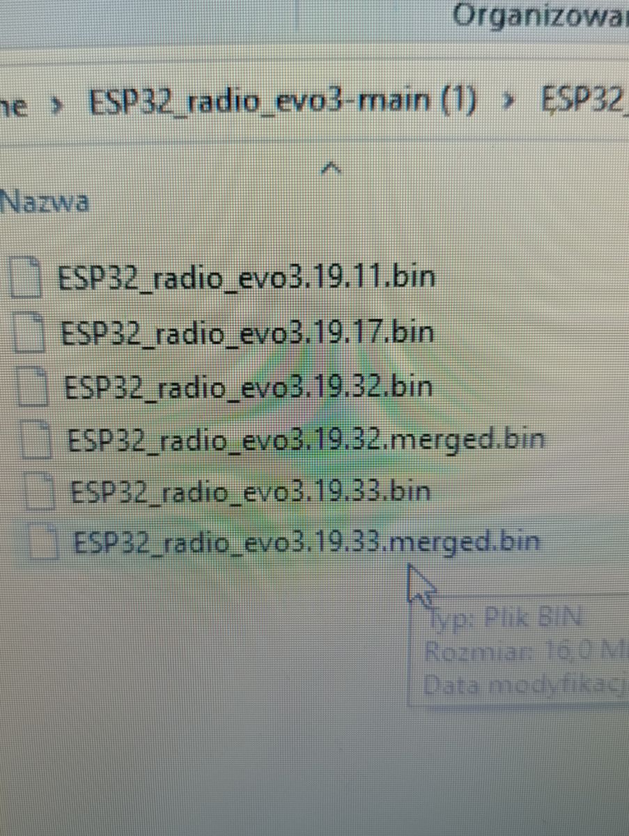

    Such a file is created by Arduino if we give the command to export binary files.
    Added after 1 [minute]:
    BIN files of ESP32 project with visible version names and merged file indicators

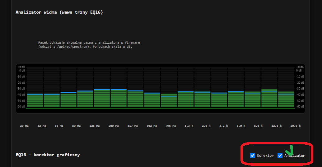

    Correction of pilot and analyser operation
    Change in analyser input gain jat here and appearance of bars
    Highlighted section of analyzer visualization code with Polish comments Checked pilot operation just arrived eq on and off AUD may not work if ACC or FLAC is on due to EQ automation. Volume on the eq works but the bar does not appear changes can be seen on the bar on the top left a little strange it would look like the bar would appear on the eq . Attached a set to control and set the equalizer on the page . Biharek not uploaded done at the time of compilation .As I wrote the bin names to the radio with and without amp . Operation from encoder volume and changing banks does not work I have to correct it.

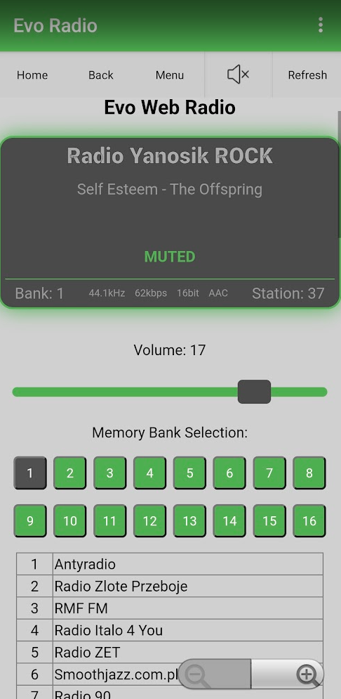

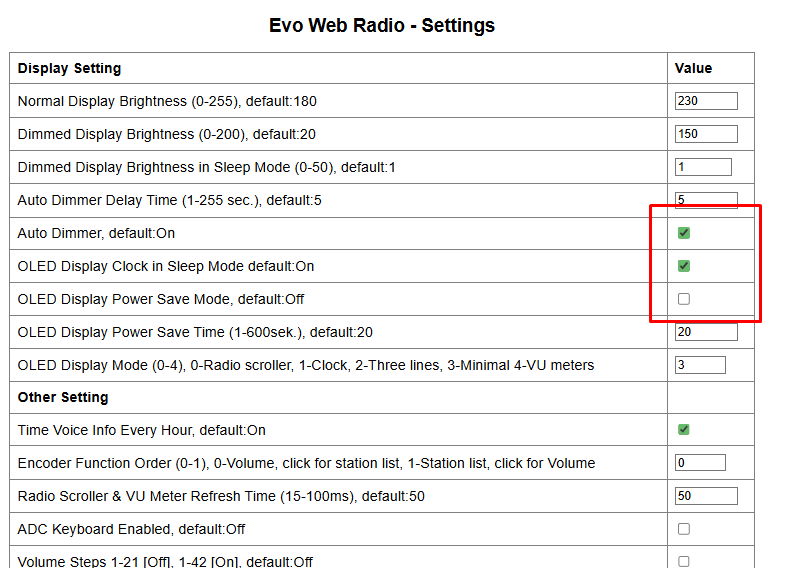

    Hello I uploaded the posts are at a good level with me. the remote no longer flashes with the volume screen on the analyzer. It would be fab only that to display the analyser you have to start the computer.
    To make it work you have to deselect both and then select the analyser only it is, when you run through all the screens from the remote control it is again a scatter of what I have previously inserted pictures of.
    And there is an inaccuracy in the volume from the remote 1-21 and from the page 1-42 which makes the radio play quieter as I wrote yesterday.
    From the page you can turn up the volume to 42 which is not possible on the radio from the remote control.
    And one last point: when using the remote control on the analyser, the display level of the bars decreases
    Greetings ...

    Starting the analyser only needs to be done once if it has been switched off on the website then it works from the remote control .Check if I am right .

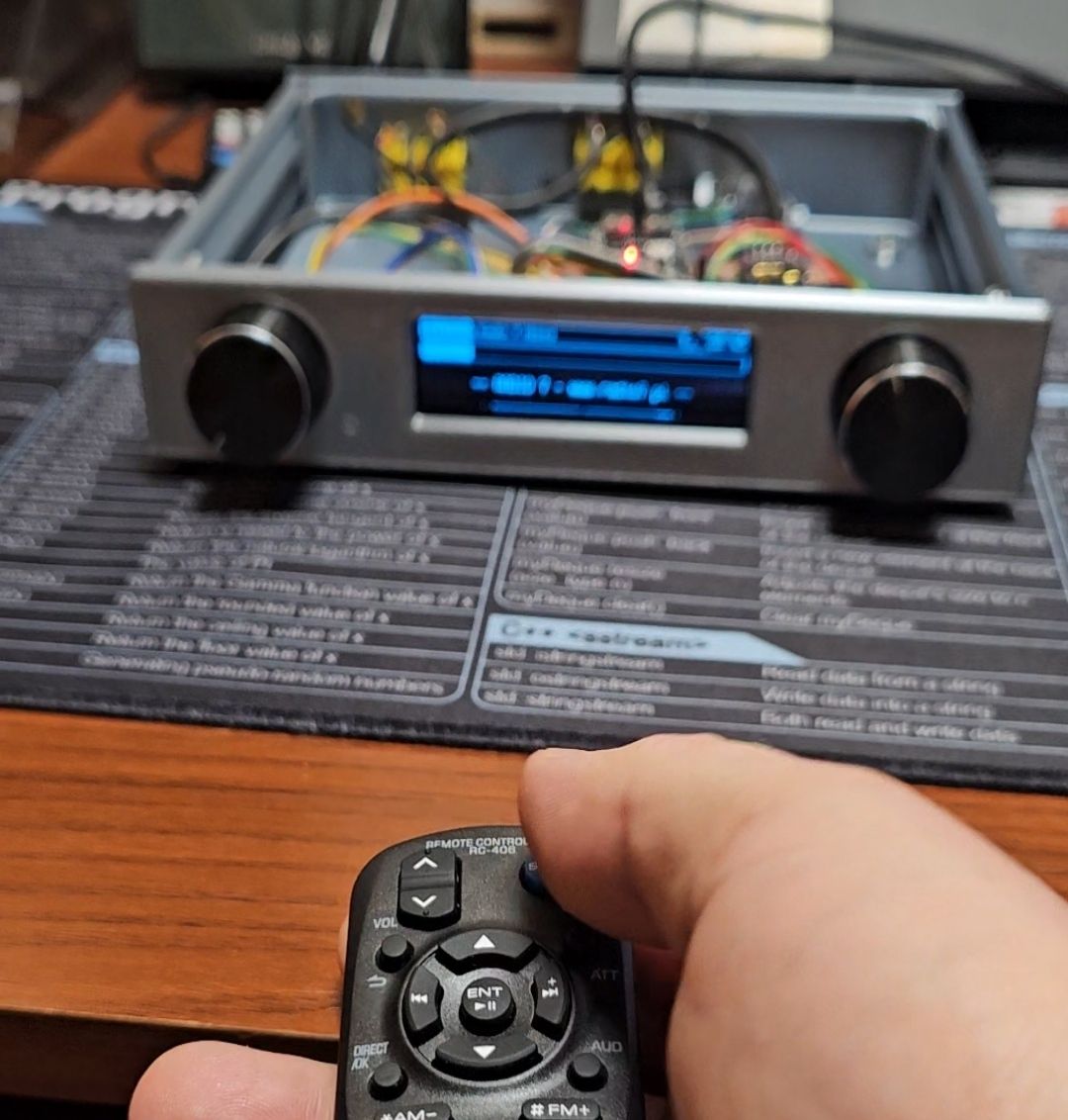

    Okay, but what do you use to turn the analyser over with what remote control button?
    I'm talking about this part
    Hand holding RC-406 remote pointing at audio device with display
    Greetings...

    >>21762372 AUD Download video now I have corrected the hole for the remote control detector

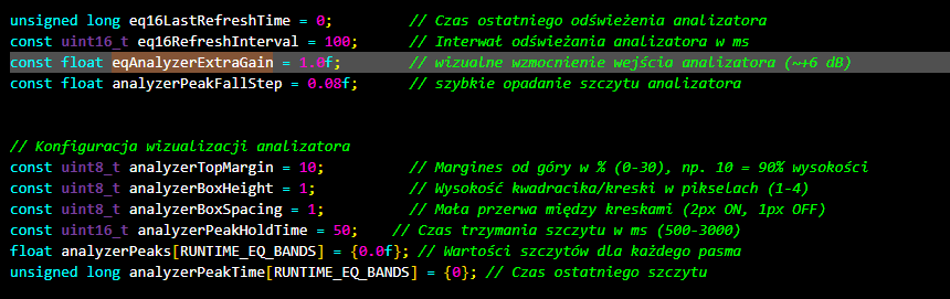

    Teraz analizator przy volume do 6 słabo działa  gdzie moge to poprawic w kodzie
    ChatGPT powiedział:
    Myślał przez 2m 5s
    To, co widzisz (że przy volume 0–6 analizator „słabo rusza”), jest do ustawienia w parametrach analizatora, nie w samym rysowaniu słupków.
    Masz trzy główne „gałki”:
    eqAnalyzerSensitivity – ogólna czułość
    AGC (eqAnalyzerAGC + ANALYZER_AGC_TARGET) – automatyczne wzmocnienie
    PreGain – czy analizator patrzy przed głośnością, czy po (czyli ma reagować na volume, czy nie)
    Pokażę Ci konkretnie, gdzie to ruszyć w Twoim kodzie.
    1. Najprostsze: podbij czułość analizatora
    W Twoim main.cpp masz taki fragment przy globalnych zmiennych (u Ciebie wygląda prawie 1:1 tak):

    Zrób to tak:
    Na początek zmień linijkę z sensitivity na większą, np.:
    float eqAnalyzerSensitivity = 0.7f;   // było DEFAULT_ANALYZER_SENSITIVITY (0.3f)
    albo nawet:
    float eqAnalyzerSensitivity = 1.0f;
    Im wyższa wartość, tym większe słupki przy tym samym sygnale.
    Domyślne DEFAULT_ANALYZER_SENSITIVITY to 0.3f, więc nic dziwnego, że przy cichszych kawałkach i małym volume wygląda to „leniwie”.
    To jest najprostsza korekta: jedna liczba, kompilacja, gotowe.
    2. Czy analizator ma reagować na volume? (PreGain)
    Teraz tak:
    Teraz masz:
    bool eqAnalyzerPreGain = true;
    To znaczy, że analizator robi FFT na sygnale przed głośnością – czyli nie obchodzi go czy masz volume=3 czy 15, słupki zależą tylko od tego, co leci z radia.
    Jeśli chcesz, żeby przy małym volume słupki też były mniejsze, a przy dużym volume większe (czyli żeby zachowywał się bardziej jak VU zależne od gałki głośności) – zmień na:
    bool eqAnalyzerPreGain = false;
    Wtedy przy volume 0–6 faktycznie będzie „mniejszy”, ale skoro Ty mówisz, że przy 0–6 słabo działa, to raczej chcesz odwrotność:
    – więcej czułości, ale nadal niezależnie od gałki volume → zostaw true, podbij sensitivity jak wyżej.
    3. Dodatkowe pokrętła (jak będzie Ci mało)
    W AudioRuntimeEQ_Evo.h masz jeszcze stałe:
    static const float DEFAULT_ANALYZER_SENSITIVITY = 0.3f;
    // ANALYZER_AGC_TARGET, ANALYZER_AGC_SPEED itd.
    Jeśli chcesz:
    mocniejsze „dopalenie” słabych sygnałów – możesz:
    podnieść DEFAULT_ANALYZER_SENSITIVITY (np. na 0.5–0.7),
    albo zostawić default, a w main.cpp i tak nadpisać eqAnalyzerSensitivity na większe (to, co pokazałem w pkt 1).
    bardziej agresywne AGC (szybsze dopasowanie, większe wzmocnienie) – w tym samym headerze znajdziesz ANALYZER_AGC_TARGET i ANALYZER_AGC_SPEED. Modyfikujesz:
    wyższy ANALYZER_AGC_TARGET → chce trzymać wyższy poziom słupków,
    mniejszy ANALYZER_AGC_SPEED → wolniej reaguje, większy → szybciej (ale może „pompować”).
    Na start naprawdę wystarczy:
    float eqAnalyzerSensitivity = 0.7f;   // albo 1.0f
    Co konkretnie zrób teraz
    W main_with_volume_analyzer_ok.cpp (lub aktualnym main.cpp) znajdź blok:
    float eqAnalyzerSensitivity = DEFAULT_ANALYZER_SENSITIVITY;
    bool  eqAnalyzerNormalize   = true;
    bool  eqAnalyzerAGC         = true;
    Podmień pierwszą linijkę na:
    float eqAnalyzerSensitivity = 0.7f;   // albo dla testu 1.0f

    Hi sofcik uploaded from the remote everything works, thanks. Just write how you can hide / skip the last view, because I only need one analyzer this first one is nice.
    Greetings ...

    Can a colleague provide a link from where he downloaded this version and if it is portals ?
    I am looking for the 2.1.1 portable version but on the Arduino website either there are no such old versions or I don't know how to search ?
    Greetings....

    Web server and WEB page
    Replaced ON/OFF selection for functions with practical "checkboxes", Corrected disabling the Mute flag when changing volume and added a Mute indicator on the web page

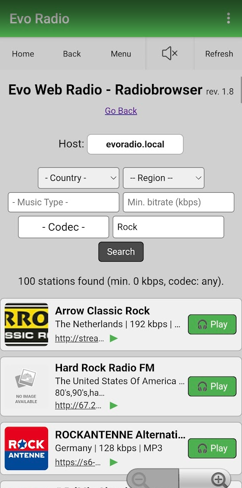

    I played around with creating an Android app for a while (in appInventor) and came up with this insanely simple but I think useful app for Android phones.
    In fact, it is a web browser that connects to http://evoradio.local/ and displays its contents. In addition, there are Home / Menu / Mute / Refresh buttons on the top bar. This allows us to control the radio by launching a simple application.
    INFO:
    There will soon be a new/modified version of the 3D printable case (easier to print) and a new front option.
    Additionally, I will try to introduce the promised update of the memory banks this weekend.
    Page (checkboxes)
    Screenshot of Evo Web Radio settings highlighting three OLED options
    Application
    EVO Web Radio interface in browser with navigation buttons and station list Evo Web Radio app interface showing station name, volume, and memory bank selection

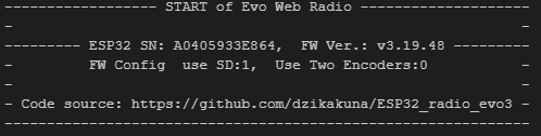

    ESP32 startup info with firmware v3.19.48 and SD/encoder configuration displayed

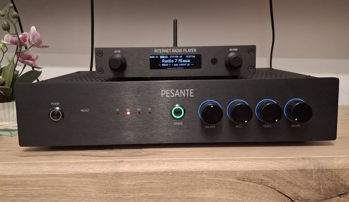

    @robgold works beautifully. I won't see the terminal because I'm doing the update via OTA. I'm creating a custom bin file because I need to swap the encoders on the chassis😀 in place. Also, I am commenting out two lines in the code so as not to display the "little watches" in the corner of the display.
    As for the knobs, they are ordinary aluminium knobs and there are blue rings glued into the chassis turned out of polymer(they are not illuminated).
    This is an amp I made about two years ago. As you can see it matches the Evo because the chassis from the same source🙂 .
