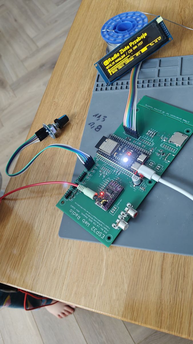

    I have assembled my first radio and it plays :D
    I still have to configure the remote control and create and configure the buttons on the keyboard.
    I have noticed that it is not displaying the kHZ information to me. Anyone have an idea what this could be due to? Could the lack of a sd card affect this?
    I will immediately ask about the buttons on the keyboard, what are the best resistor values for the ladder? Someone may have a ready-made version that could be plugged in and customised for themselves?

    >>21766730 So now I am looking at the project of my colleague @dawidkosciesz and the question occurs to me did you disable the RGB LED on the ESP board ?
    The LED is on the same PINs as the SD card maybe this causes a conflict. Second thing, Chinese readers often have strange pull-ups, different resistors. Check the reader's wiring diagram carefully.
    @dawidkosciesza the audio information is sent by the audio library. The question is what version of the library do you have ? Take a look at the terminal, you should see there the information as below. The important thing is if this is exactly what it says or if you have without (Hz) in brackets.

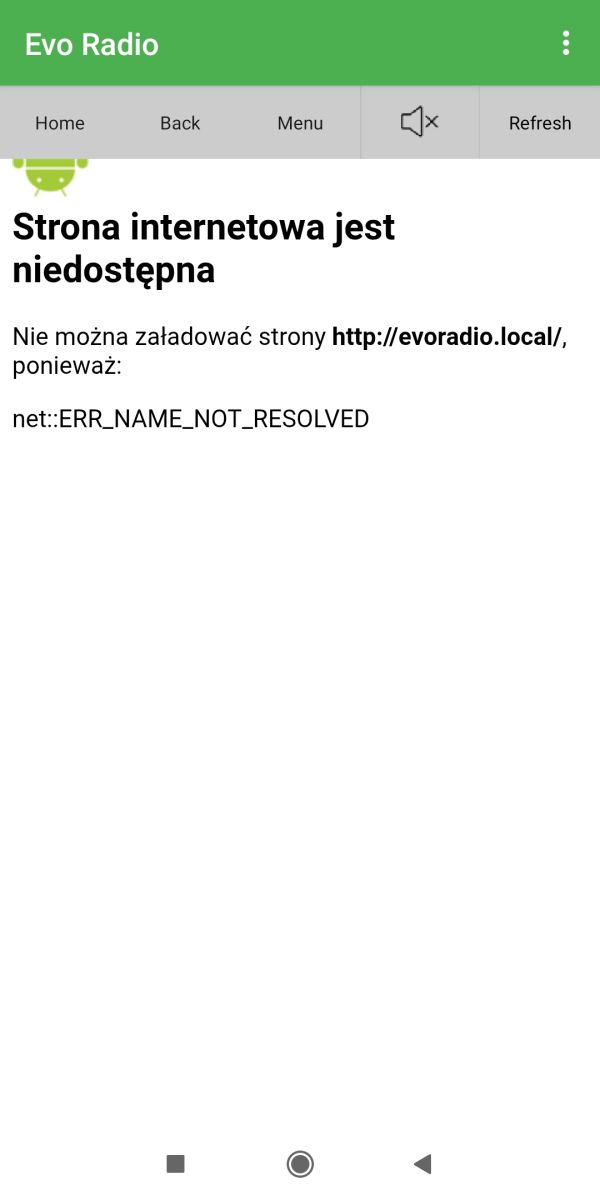

    Hello for me unfortunately this app does not work.
    I have from the phone the net shared for this reason also my browser did not work. Then kol Robgold corrected something and it worked. Maybe it is similar here.
    Evo Radio app error message: Website is unavailable

    >>21767262 Unfortunately. As the phone works as a rotuer it at the same time does not work wifi in the client session. This is already a limitation of the phone.

    >>21767332 And does the site work for you on the same phone under adrrs ip cxy evoradio.local ? Because if the latter and mdns works then the app should work too. Click the home button at the top when you open it.

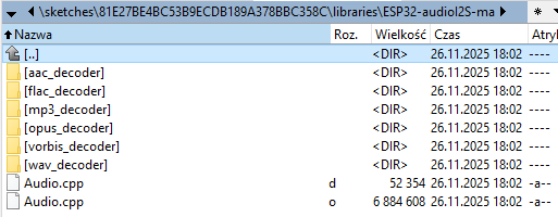

    >>21767379 Then you already have the answer, the firmware 3.19.xx looks up to the characters (Hz) and that is not there so you have 0.0Khz
    The library is on my GitHub but you can also download from the author: Link only from src directory not from official release.
    You copy the library here replacing the old files with these new ones:
    C:USERSAppDataLocalArduino15Arduino15AudioI2S-master src
    In addition, as I wrote you need to locate the sketch compilation file is somewhere here: C:USER NAMEAppDataLocalArduino sketches...............8BBC358Cthese numbers-letters will be different. Inside, delete the Audio library or preferably ALL after uploading the new library.
    Folder ESP32-audioI2S with decoder directories and two Audio.cpp files visible

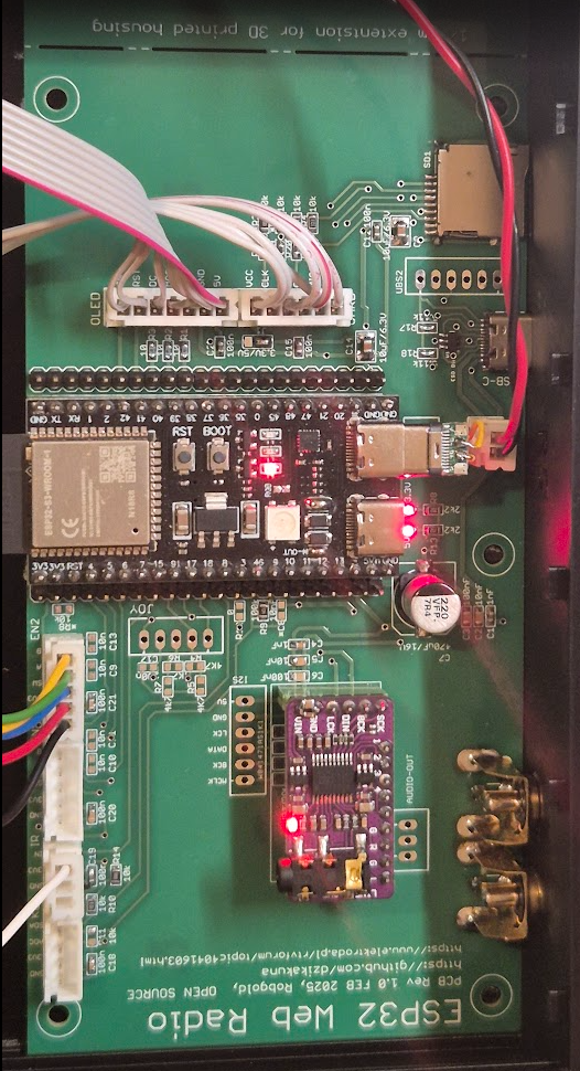

    >>21767466 For the external power switch in the case. The USB-C that is on the board is made so that it has ESD protection and such a let's say prosthesis that you buy a cheap Chinese USB-C plug on a mini PCB and as you connect to the Data+ and Data- connector you can power from this external socket but also have a preview of the UART port. You have pictures of the case on GitHub, the STL file for 3D printing are available on GitHub Link
    Take a peek at this photo. I need to do a radio "session" but there is never time.
    Top view of ESP32 Web Radio PCB with connected modules and wiring inside a case.
    For high bitrate FLAC and AAC files you must firstly have ESP32 Core no higher than 3.2.0 in the Arduino and then you swap the two files responsible for the WiFi bandwidth and FLAC works beautifully up to 1500kbps. Here are the files: Link

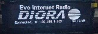

    @dawidkosciesza Logo for a colleague prepared:
    OLED display showing Diora logo, Evo Internet Radio and IP address.
    Hello, I share the internet from my phone as a hotspot and I have two devices connected, a radio and a computer from my computer and the website works beautifully under the IP which is displayed on the radio
    http://192.168.43.161/
    I have just such and how to call or check
    http://192.168.43.161/cxy evoradio.local
    Is this how it should be? When I paste it into the browser on my computer it looks like this and unfortunately it does not work
    http://192.168.43.161/cxy%20evoradio.local
    Browser page with a URL and “Not found” message displayed
    I would add that the site under this IP ie
    The site also works on a phone in a browser.
    Greetings ....

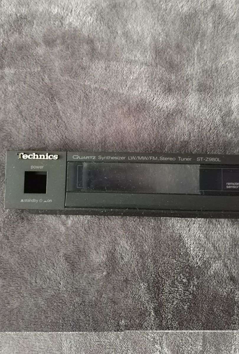

    Hello, I'm still a beginner. Could you please help me where and how I can change the boot logo?

    @gaborbalint919 What is the reason that you want to change the start logo ?

    I want to install it in this radio and I want it to say Technics ST-Z980L when it starts up.Front panel of Technics ST-Z980L tuner with power button and LCD screen
