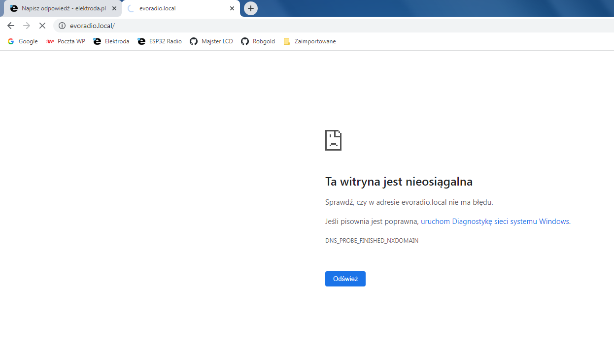

    dawidkosciesza wrote:
    And have you tried simply typing the address:
    http://evoradio.local
    Unfortunately it does not work by IP yes and by address no
    Browser error: This site can’t be reached – evoradio.local
    So the app won't work for me?
  • #1789 21770530
    robgold
    Posts: 698
    Help: 10
    Rate: 284
    >>21770472 Unfortunately phones in hotspot mode very often block /isolate the network and do not broadcast multicast so mDNS gets nothing. The app relies on the name from mDNS because it's a regular browser (trying to open http://evoradio.local) . Will test if something can be done with it e.g. local DNS as we are on a hotspot. At the moment it will not work.

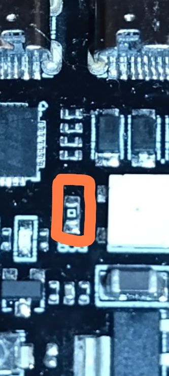

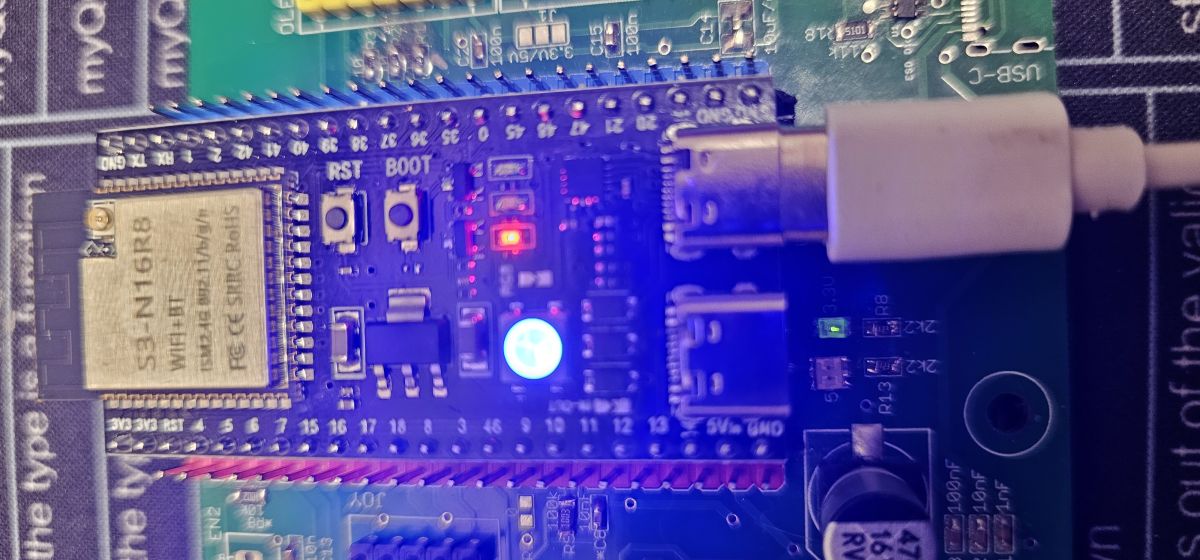

  • #1791 21770993
    gaborbalint919
    Level 4  
    Posts: 6
    Hi, I uploaded the latest evo 3.19.48 to the esp32. How can I disable the rgb led on the esp panel??
  • #1792 21771183
    DJCheester
    Posts: 2049
    Help: 75
    Rate: 949
    The best way is to solder out the 0 ohm resistor the one next to the 😁 diode
    This is what I did.
    Greetings...

    ESP32-S3 N16R8 module with illuminated LEDs and USB-C connector In the new circuits with ESP32S3 N16R8 there is a special jumper to cut and the problem is over .

  • #1796 21771509
    Jarosław 1808
    Posts: 129
    >>21770993 Electronic component on a PCB marked with orange frame
