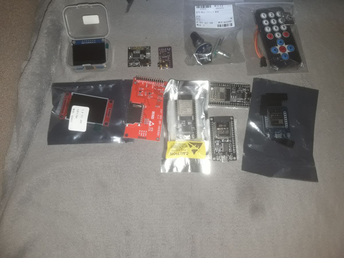

    Hi colleagues.
    Some time ago I was interested in the Yoradio project, I bought some modules, but I didn't manage to implement it and build a radio. Now I came across another internet radio project published on this forum. I have read everything from the beginning, from V1 to V3 version of this radio, but I am completely confused.
    I have these modules, displays..., I will see if they are suitable to build this radio. I didn't understand a few things...:
    - does the radio need a computer, a laptop, on for it to work? From which it downloads some more data?
    - how is it with searching, adding WIFI networks? I only need to search once and it is still stored in the ESP32 module.
    - is there any complete schematic of the radio where there are two encoders added / one to increase volume and the other to select banks and stations? /, a couple of buttons to store stations in memory and a menu button where there could be other menus without having to use the remote for basic options.
    -How is it with updating and searching for stations? Is it possible to search for Czech and Slovak stations there?
    Thanks for your reply

    >>21772492 Which version of the radio do you want to build ? We have three different versions of the radio discussed in this thread:
    - colleague Mastra's version XXL v2 the first one you see in the first posts
    - my version Evo v3
    These two are compatible in terms of schematics and connections, they support the OLED 256x64 SSD1322 display
    - version of my colleague Master XXL v3 with a colour display
    All are based on the ESP32-S3 module.

    As a colleague above described ESP you have a different colour display supposedly there is but I don't know on what controller and resolution. Here the foreman's project is on a 320x480 LCD. A remote control and encoder might be suitable.
    No computer connection is required, just a wifi signal around the house. The Robgold version, on the other hand, has a web control interface whether on a computer or smartphone.
    Regards...

    I have two colour displays: a 2.4" SPI24x320 and a second smaller 1.8" display. Both are on an ST7735 chip. For me, a project with just a Wi-Fi connection would be ideal, so which of these three versions could be used?
    Will I need to buy another ESP32 module? The ones I have are not suitable for this project? Can you give me a link to a suitable ESP32 module?,or perhaps a display if none of them are suitable for the project?
    Thanks.

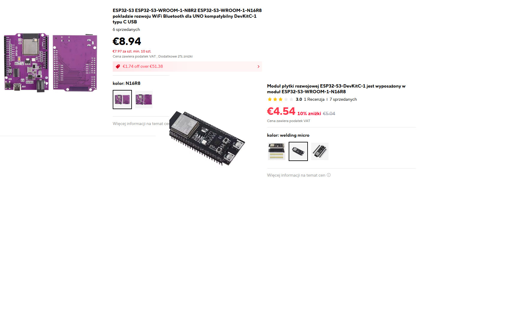

    Hello ESP32 with antenna socket
    https://pl.aliexpress.com/item/1005009212121307.html
    Plus an antenna such as in the link below or innA
    https://pl.aliexpress.com/item/1005003055160772.html
    Plus I see the D/A converter you have if it's a PCM5102A it could be.
    Plus a 3.12" OLED display if you go for Robgold's colleague's version (Recommended)
    https://pl.aliexpress.com/item/1005008615548045.html
    For Robgold's colleague's version this will suffice.
    If for a colleague's version of V3 then you need to buy an LCD
    https://pl.aliexpress.com/item/1005003033844928.html
    For this in the Major's project you need a memory card i.e. you need to purchase a memory card module like this.
    https://pl.aliexpress.com/item/1005005302035188.html
    If anything is unclear, please ask.
    Greetings....
    Added after 1 [minute]:
    The display what you have has too little resolution. For a DIY project it will not be good.
    Greetings...

    I will order the ESP32 module. What display will I need for a version that doesn't require a computer or mobile phone for control?
    Probably a project from the Major

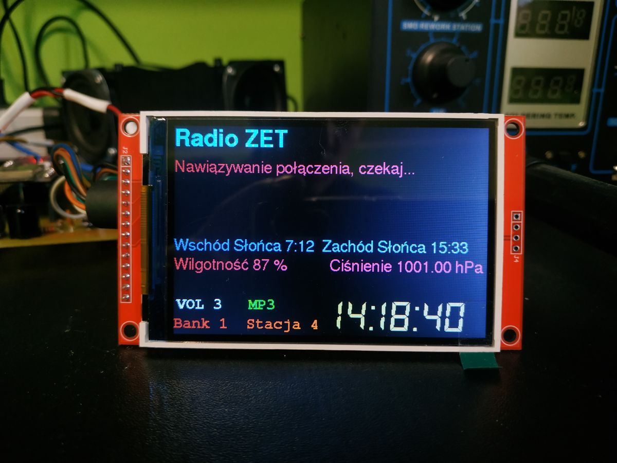

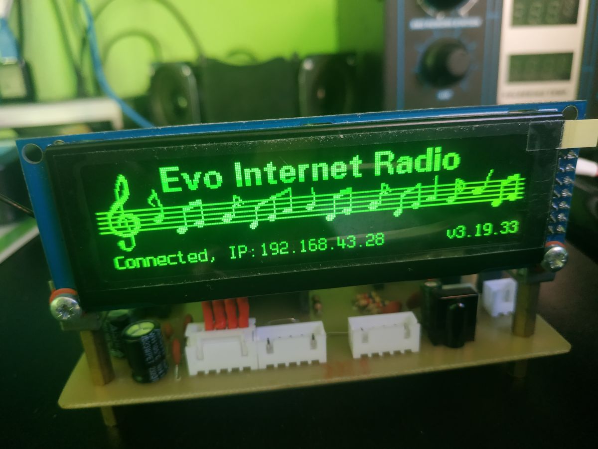

    Hi both radios do not require a computer (they are controlled by the NEC ir remote control) the only thing they require is a wifi signal and that is all.
    The Robgold project has additionally the possibility to control through the website but you don't have to use it. You can only use the remote control.
    Also, the difference is that Majstra downloads the banks from Github and you actually have his links, with Robgold you can add your own.
    Robgold's radio with OLED display looks like this.
    Robgold internet radio with OLED screen showing IP address and firmware version
    The Major's radio looks like this and additionally has music playback from an SD card
    Color LCD screen displaying internet radio interface with weather and time info
    At Robgold's there is only a radio.

    Order the N16R8 ESP32 S3 module. Greetings...

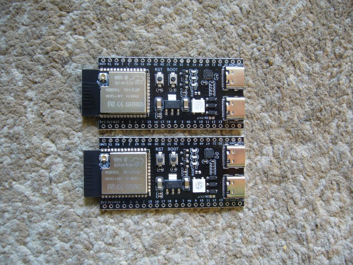

    As I wrote, the module does have an OTG socket, but it is not used in this project.
    Two Sparkle IoT XH-S3E modules with N16R8 WiFi+BT chips on carpet
    Such modules can be with or without an antenna socket. It is important that they are N16R8.
    Greetings....

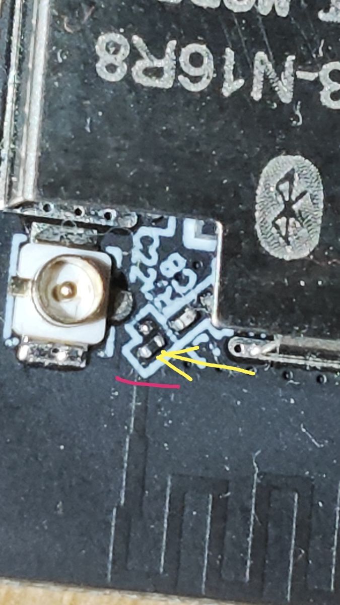

    amrowek wrote:
    You have to do the grease yourself to short out.
    By default there is a jumper for the PCB antenna. It needs to be removed( I think)
    The components there are terribly small....

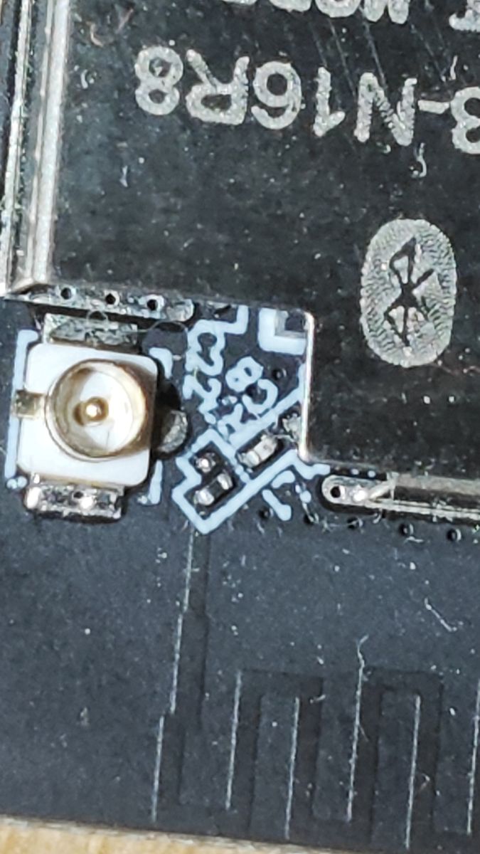

  • #1820 21773053
    DJCheester
    Level 28  
    Posts: 2089
    Help: 75
    Rate: 958
    Yes, there is a jumper for the PCB antenna, it needs to be repositioned or removed and the marked area needs to be shorted with e.g. tin.
    Regards...

    dawidkosciesza
    Posts: 54
    Rate: 14
    Right, there is a jumper. Good to know because I'm planning to make an external antenna. I would be annoyed that it doesn't work.
    Now the question is, if I give the tin dot too big and connect the two antennas, will it affect anything?
    Close-up of an antenna connector on a PCB with visible solder bridge
  • #1822 21773114
    DJCheester
    Level 28  
    Posts: 2089
    Help: 75
    Rate: 958
    It could be worse because antennas are nasty beasts and literally everything matters there. This can 99% result in poorer coverage. Better to get it right.
    Regards...

    amrowek
    Posts: 244
    Rate: 10
    Is it still necessary to scrape something? Which one, I've heard of a jumper but not of .... scraping something. I did as in this picture.

    #1827 21773156
    efi222
    Level 22  
    Posts: 779
    Help: 12
    Rate: 1219
    amrowek wrote:
    Is there still a dot to be erased? Which one is it, I knew about the jumper but not about .... scraping something
    The arrow shows a jumper which needs to be removed or moved to adjacent pads.
    You can knock out this jumper and cut the path IN place of the red line. And pour tin over these three pads above. These are such small points that I can't even grasp it under a magnifying glass :) Close-up of a PCB showing a jumper and a trace marked for cutting.

    >>21773156 And are you sure it is a jumper ? After all, there could be a resistor there, a coil some kind of antenna matching circuit. Let's not exaggerate the size of a normal 0402 or 0201 component :)
