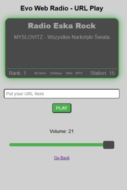

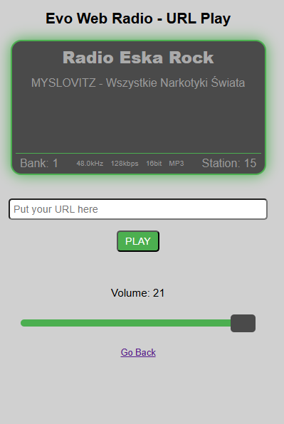

    i have uploaded on GitHub the new soft 3.19.52, what's new ?
    PLAY FROM URL
    There is now a new PLAY URL button in the menu, which allows you to open a page where you can test any stream from the Internet on the radio after entering an external link. I am not hiding the fact that this is how I test various interesting stations added by other colleagues creating Internet radios.
    Evo Web Radio interface with URL input and volume slider

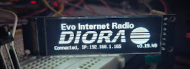

    Start logo
    I have added options to add your own logo instead of notes. The program itself checks if you have your own logo on the SD card or in the SPIFFS memory, if so it will be displayed instead of the notes. How does this work? You need to create a logo in XBM format (e.g. using the free Gimp) with a resolution of 256x64px as a black and white 1-bit image. Save such a file under the name logo.xbm on your card or in SPIFFS memory and that's it. Just remember that above the logo, after 1 second, the text "Evo Internet Radio" will appear, so that someone who sees the radio at your place can reach the source of this radio and in the bottom line there will be information about the connection to WiFi and the IP and software version.
    OLED display showing Evo Internet Radio and DIORA logo

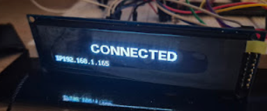

    WIFI MANAGER
    I have improved the mode of connecting to WiFi a bit. From now on, if you connect correctly, a large CONNECTED message will appear on the display for a moment, the IP number and the radio will reset itself.
    OLED display showing CONNECTED and IP address 192.168.1.165

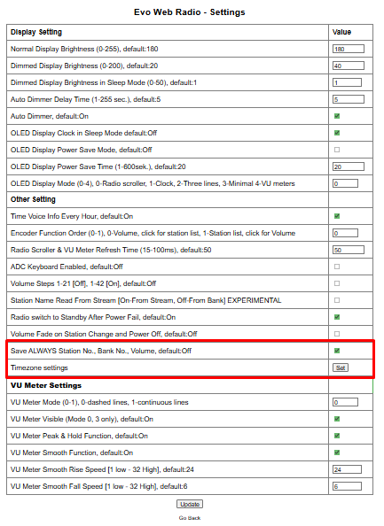

    CONFIGURATION
    Two new options have appeared in the settings.
    The first:
    "Save ALWAYS Station No., Bank No., Volume" its deactivation will cause the radio to save the value of volume, last station and bank to memory only when "powerOFF" is switched off. This is to prevent excessive memory usage especially SPIFFS.

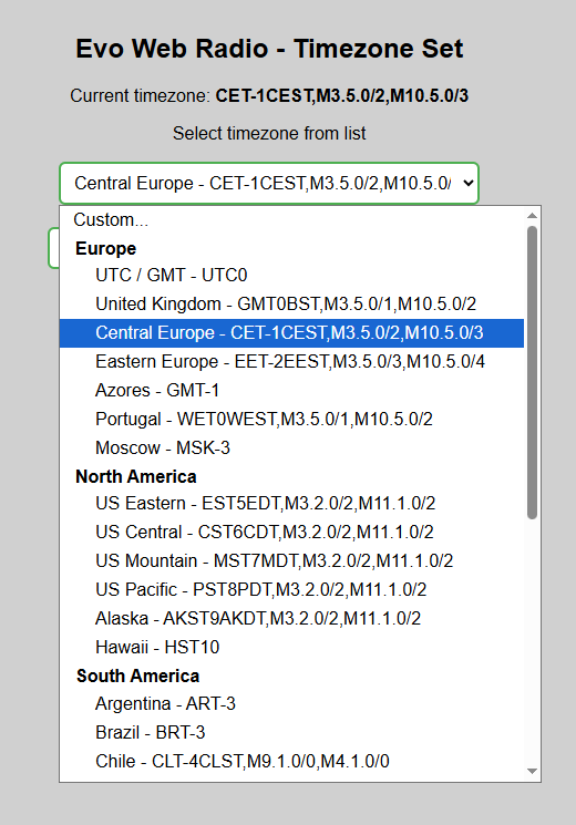

    Second option:
    There is an option to set yourself your timezone, it is stored in the timezone.txt file, in the case of Poland you don't have to do anything, the radio in the absence of detecting this file will create it itself the first time and store our timezone there. This is a nod to colleagues outside of our time zone so that they can change this in the configuration.
    Evo Web Radio settings page with highlighted save station and volume option
    Timezone settings menu with dropdown list in Evo Web Radio interface

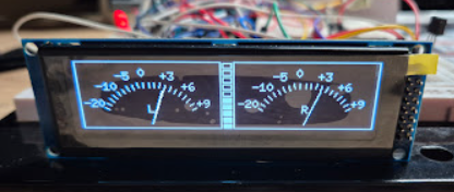

    VU-indicator - mode 4
    In mode 4 (analogue drive indicators) when you press the DIRECT/OK button on the remote control, 10 rectangles will appear between the indicators, each indicating 1 second of audio buffer fill. In other words, this is a quick overview of how much data a given Icecast station/server allows to buffer. This is calculated in a simple way the buffer content in kb is divided by (BITRATE / 8). The result of course depends on the correct bitrate of the station. Those which have a fixed (frequency (44.1) * channels(2) * resolution(16) i.e. 1 411 200kbps) will show an incorrect buffer value.
    OLED display showing analog VU meters with L and R needle indicators and scale
    VU METER - mode 0
    I've added a mapping to VUmeterMode0 to eliminate clipping but I have a feeling this is a problem with the mp3 decoder, which outputs a uint16_t variable and sometimes gets overflow, so when split into two 8 bit values one may have a mismatched value in a given frame loop.

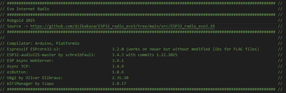

    SKETCH
    From now on in the sketch itself at the top under the header I will include information about the libraries used for compilation
    Project info and library list for Evo Internet Radio software.

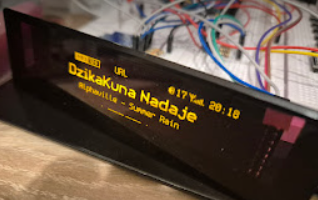

    TALKS
    As I've already written, I sometimes "peep" at others to see what they're creating because it's always inspiring, and on the website of my friend JCS I found an interesting program called AirMusic for Android phones. It is an application that allows you to make your phone into an Icecast server and e.g. stream any audio you play on your phone to your radio: YT, Spotify, mp3, microphone. Useful e.g. when testing spectrum analyser.
    Internet radio display showing station name and song title
    I have placed the HTML code for both PlayURL and Timezone in the INO code. It's not the happiest solution, it's easier to edit and keep it as html on the SD card but on the other hand for someone new one file to compile gives basically a finished solution.
    I am attaching two example logo files. They are not on GitHub and are included here as a reference on how to create such a logo and not as part of the Evo radio.

    >>21773883 super changes, this project is developing at a dizzying pace. I'm testing and from comments, I noticed that there are streams that work for example on a computer in the browser, on other audio librariesI2S also (yoradio), and here not. This problem was already present in previous versions of the software, but I did not report the problem.
    For example, Radio Kwidzyn (but there are also several other stations):
    https://s3.slotex.pl/shoutcast/7308/stream?sid=1
    The second thing I have noticed is the pointer VU - mode 4 - there are no vertical rectangles with me.
    I uploaded the .bin for myself via OTA, I did not test uploading from sketch

    @Lechuuu address https://s3.slotex.pl/shoutcast/7308/stream?sid=1 has a redirect in the library to https://s3.slotex.pl:7308/stream/1/?sid=1 I don't know why the radio, despite seeing the new link correctly, doesn't open it but closes it with the message stream title: HTTP/1.1 404 Not Found but when you type in the new one it plays correctly - Radio Kwidzyn.
    I opened a thread at Wolle's (author of the audio library) why the redirect didn't work correctly despite the correct link.
    In Mode 4 you have to press DIRECT/OK (the button assigned to "rcCmdDirect") to enable the buffer preview. Normally the buffer information will not be displayed to you. It is only there if you request it.

    robgold wrote:
    In Mode 4, you must press the DIRECT/OK button (the button assigned to "rcCmdDirect") to enable the buffer preview. Normally the buffer information will not be displayed to you. It is only on user request.
    Well I scored a gaff - yes I read the posts, it actually works.

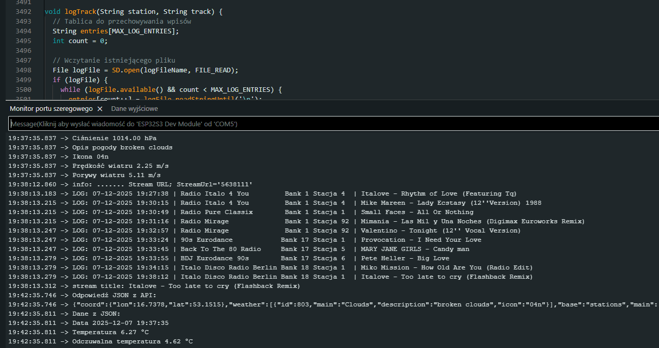

    From the cycle of what was played..., someone on the forum earlier suggested the idea of logging events so I sat down to the topic to make an event.txt file on the SD card where the data of the current station and the material played is stored with an assigned time stamp. The lines won't be saved indefinitely but in a limited range, for now I've given 10 entries to start with, the oldest ones fly out and the new ones at the end of the list. When I polish the code a bit with descriptions, I will upload it to my github profile, it will be on me at version v3.
    Later I will add a call of this log to the radio screen using another new remote control button "Search" with the option to scroll with the up and down arrows.
    And this is how it looks on the serial:
    Screenshot of ESP32 serial monitor with logs of radio tracks and weather data

    With me now, no logo is displayed.

    @hevet a did you win a memory file with the logo ?
  • #1850 21774301
    hevet
    Posts: 347
    Rate: 47
    I haven't uploaded, but you wrote that if I want mine you have to upload to memory, otherwise it's default.

    @robgold then I have a problem, the logo only displays when I upload it to memory, otherwise black screen at the start.
  • SPIFFS can report empty files as valid
    #1858 21775007
    robgold
    Posts: 726
    Help: 10
    Rate: 290
    >>21774502 @hevet
    please find ino this function and replace it. Apparently the SPIFFS memory can return "true" even if the file has a length of 0. You should have created traps. Somehow I missed that with the SPIFFS memory.
    Code: C / C++
  • #1859 21775024
    hevet
    Posts: 347
    Rate: 47
    @robgold is fine, the logo is back :) .
