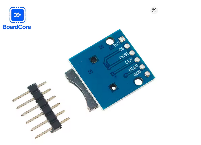

    kula350 wrote:
    Hello and greetings. Can such a card reader be used? It has slightly different markings. It already has resistors on it. SD card reader module with labeled SPI pins and a separate 6-pin header
    This reader
    https://pl.aliexpress.com/item/1005005302035188.html
    I think it's the same one you showed only you can't see the underside .
    Greetings ...

    kula350 wrote:
    Everything is on the diagram
    And on the back on the module PCB just connect correctly, the module is powered from 3.3V not 5V you need to watch out for this.
    Greetings...

    @kula350 I use such a reader on a test contact with the radio and it works. Even stable and there were no problems with it. I was supposed to put together a radio on my board for various tests but you know...shoeless cobbler etc.... ;)

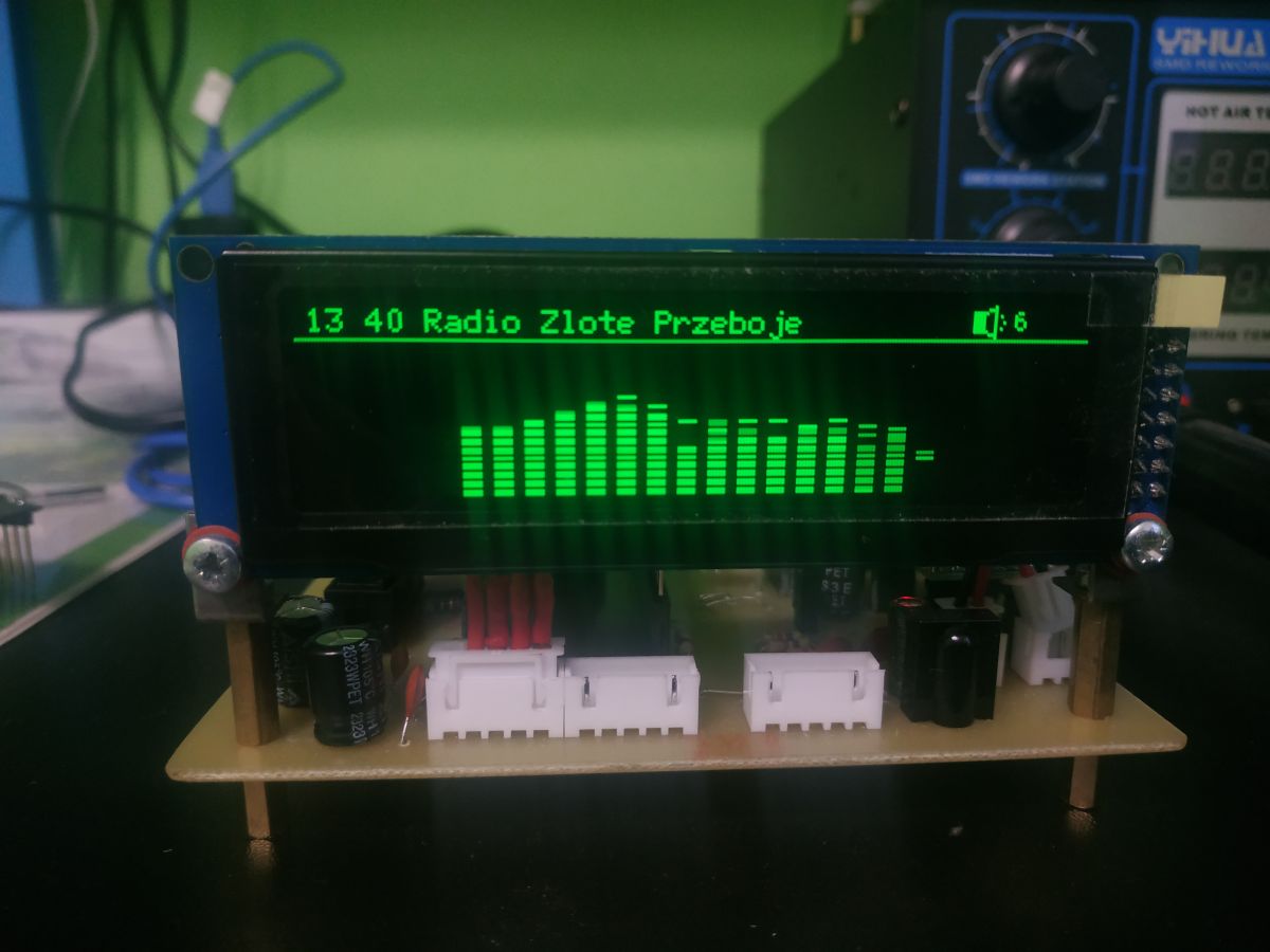

    Ejcon works but the strange thing is that for me at the beginning when it starts up a mute comes in automatically. This is not the case with Robgold. Are you connected to the encoder? Could you unplug it for the test ?
    Instead of encoder I have 10k resistors connected to 3v3
    Under the 3 signal pins of the encoder.
    This second analyser is a bit thin
    LCD screen showing a radio station name and animated sound bar visualization
    Added after 1 [minute]:

    >>21775823 Yes I have the Encoder plugged in

    DJCheester
    Level 28  
    Posts: 2089
    Help: 75
    Rate: 958
    And you can see what's on the encoder board because it sort of presses the button automatically which is MUTE. I only have a 10k resistor to 3v3 maybe still give a capacitor to ground, I will check that tomorrow. Other than that ok.
    Greetings ...
    Added after 7 [minutes]:
    And can you do a test without the encoder plugged in ?
  • #1879 21776215

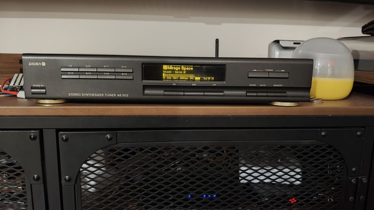

  • #1881 21776354
    dawidkosciesza
    Posts: 54
    Rate: 14
    Successfully completed project :)
    Let me show off the result 😁Diora AS 502 tuner with updated display on a wooden shelf
    The display looks much better in person, the tinted factory glass does the job. Unfortunately the photos with the phone don't convey the effect.
  • #1882 21776360
    ejcon
    Posts: 301
    Rate: 68
    >>21776196 I don't have any RC bare plugged in encoder I made pcb 1.0 .pass-through version.I have to finish the smd pcb and I will see how the software works.
    >>21776354 Congrats looks great

    #1883 21776400
    robgold
    Posts: 726
    Help: 10
    Rate: 290
    @dawidkosciesza It came out great. Envy it. I've had my Sony ST-120 decoupled and so poor it's been waiting for over a year. It was actually under it that I implemented the ADC keyboard. I am glad that you will be testing this solution. You cut out a large inscription on the display and overwrote the software versions yourself hm.... maybe that is an option for the logo version too. I have to think about it :)
    Did you use the resistor values from @DJCheester or did you recalculate your own ?
    PS. Post on the FB group yoRadio PL with a note that it's not yoRadio core.

    ejcon wrote:
    I don't have any RCs bare plugged in
    So not a module of this type ?
    https://sklep.msalamon.pl/produkt/enkoder-impulsator-obrotowy
    When I plugged it in it was ok, when I didn't plug it in it was catching the station list and changing it from time to time with Robgold's software, I added as on this encoder three resistors to the power supply and the problem disappeared, it works fine with Robgold's software, what's interesting when I replace the ESP on the same PCB and upload the software from you, the mute comes in like on the video below. There is a connector under the screen on the left side there these components are added.
    All in all, I have no logical explanation as to why Robgold's is ok after adding resistors and yours on the same PCB and also resistors is mute after switching on.
    Interestingly when I press the mute button on the remote after switching on, the voice comes back and the indicator and as long as it plays nothing happens anymore.
    A strange case....
    David the radio beautiful congratulations, and me as well as kol Robgold the subject is slow going also I have been doing my Schneider for about 9 months now but it is always something and there are more important subjects and it lies like that.
    But the PCB is done. Now it's the launch that's left and that's probably the hardest stage for me.
    Best regards...

    #1889 21776712
    dawidkosciesza
    Posts: 54
    Rate: 14
    >>21776400
    I found that I didn't need the software version itself on the display at startup, I had to move around a bit and shorten those "spaces" that are the data for the save cleanup and it came out nice ;)
    I used my own values because I was doing the ladder in a slightly different way to my colleague @DJCheester. I didn't connect resistors in series, just the right value for a particular button (it was easier by design). Well, and I had 17 keys to make. I assisted with ChatemGPT calculations, but noticed after assembly that there could be a little more variation in ADC values between keys. The most important thing was that it worked after configuration 😁 The old keys do their job too 😏
    I'll try to upload something to this group in my spare time 🤪
