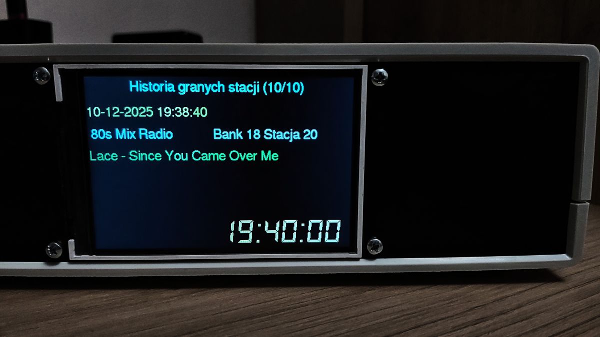

    #1899 21777236
    MAJSTER XXL
    Posts: 2064
    Help: 164
    Rate: 429

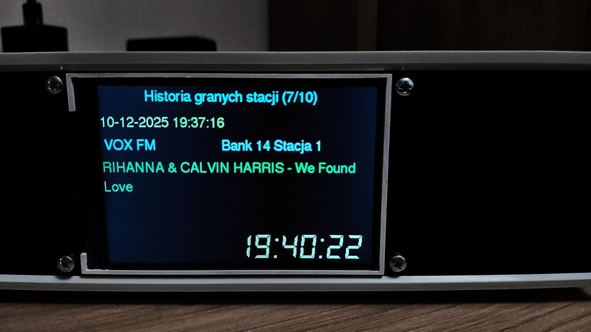

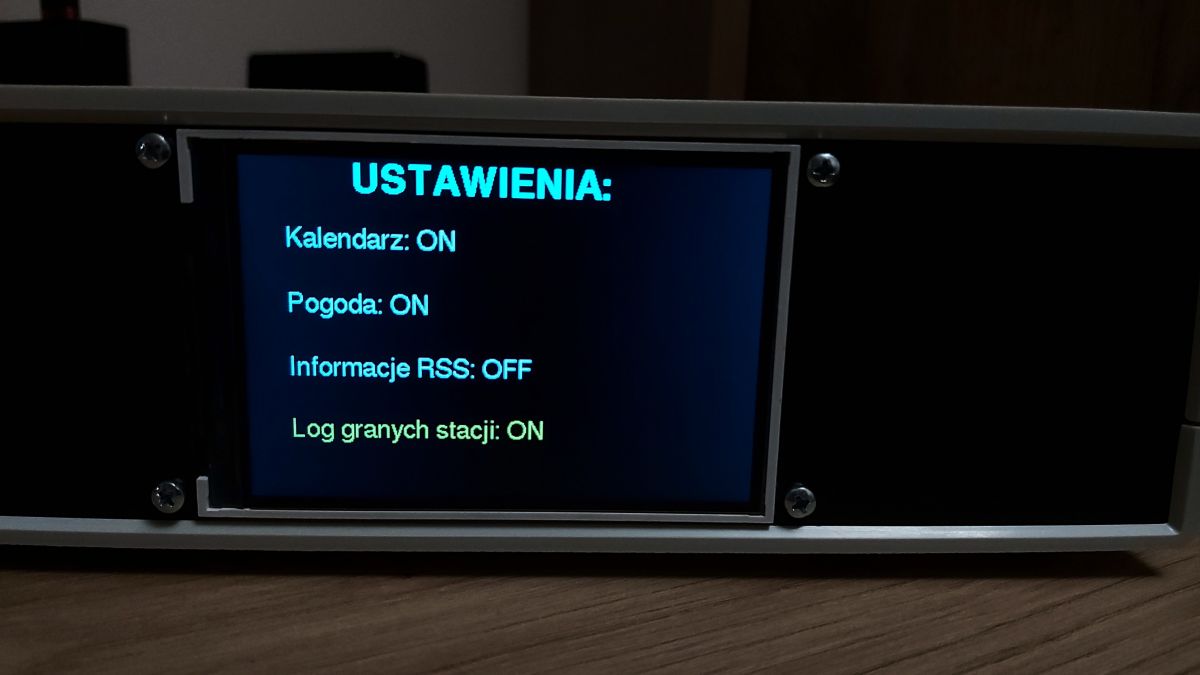

    I've added the option to enable or disable logging of played stations in the settings, a new button on the remote starts the entry into log display mode from the last played station, up/down arrows scroll through the logs, exit logs with the same button.
    Below is a view of this functionality, changes have been recommended on the repo:
    https://github.com/sarunia/ESP32_internet_radio_v3/tree/main
    Radio display showing played station history and current time
    Internet radio display showing station playback history and current time
    ESP32 display showing settings: Calendar ON, Weather ON, RSS OFF, Station log ON

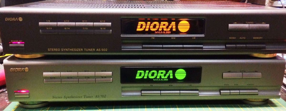

    Recently I bought at 1.15zł for a ready-made board with PCF on board to control the LCD display , which can be easily used without modifications to read the keyboard. Of course, PCF is not the happiest solution
    There are also dedicated circuits for matrix keyboards supporting definitely more buttons, but they are actually more expensive :-)
    As for ADC drift ... well what are you surprised , ESP quite heats up , the more that it has something to do . but also for this there are ways after all . maybe you read this keyboard too restrictively :-) maybe it is worth to allow a large spread and larger ranges and tolerances ??? moreover it is always worth to read such a keyboard a minimum of 2 times before we undertake decoding . and besides , I do not know how many bits of ADC you are using because if too many is also not good :-)
    p.s. These Diodors are running on PCFs
    Two Diora stereo tuners with illuminated LCD displays and rows of buttons.

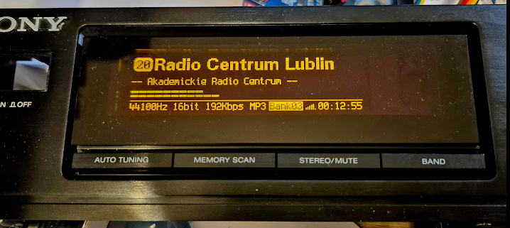

    The ADC is read a few times, the resolution is 11 bits as I remember. I haven't fully tested it yet because my poor Sony is lying around waiting for the conversion to be completed. I have printed out all the mounts, adapters but no time to put it together.
    Sony radio display shows Radio Centrum Lublin station and MP3 sound parameters
    Gee , wouldn't a VFD look nicer on a Sonik ?? or a white OLED though ???
    As for the ADC and the keyboard - 9 bits quietly passes the test for me, it works flawlessly very low ( even trace ) loads ESP itself when reading.
    In the SONY DAR1000 as I designed it (which was from today's perspective a mistake to make the ADC keyboard in this tuner) I use 3 inputs ADC and 15 buttons hang on each :-) in total a rich 45 buttons :-) Today I would do it completely different and I would use a dedicated circuit for such an extensive keyboard, but in 2021 I didn't know about it yet :-( TCA8418 , read about it maybe it will be useful for you in future projects. cool is .
    Yes the ESS9018 plays nicer ( to my old ear ) but at my place it runs on 24 bits because the chinese did not bring out on their boards i2c for configuration , and maybe it is better :-)

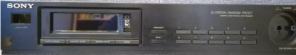

    I would very much like a VFD but a graphic one. I even have an Itron from a 2x20 cash register, sure it looks great but the limitation to 2 lines of text with such a radio is unfortunately always a compromise of what you display with the rest you can see it in your videos either VU or stream title or watch. I've already matched the Sony frame to the OLED, if you'd like to print files let me know.
    I have to order a DAC ES for myself for testing.

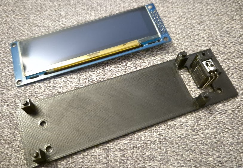

    Front of Sony tuner with a graphic OLED screen replacing the original display
    Graphic VFD display and 3D-printed black enclosure on fabric surface
