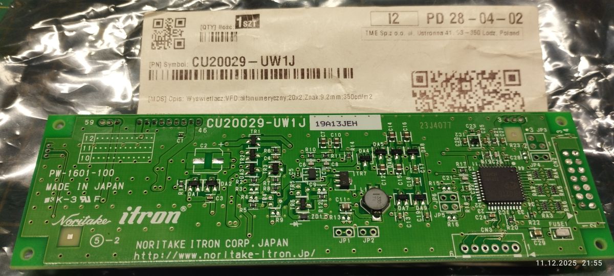

    I've already put a few of these on the Sonya ...Green VFD PCB Noritake CU20029-UW1J with electronic components and label
    They are not cheap either ... But they look sensational .

    What do you get out of the lamp itself? for this you need a controller which will take care of the control and it is not likely to be easy :-)
    Voltages are not a problem ...
    here you have a similar lamp with driver :-) but also the price is different
    https://pl.aliexpress.com/item/1005008996053458.html?
  • Clarifies the lamp is only a COG display, not a finished module
    #1925 21778404
    simw
    Posts: 758
    Help: 94
    Rate: 288
    Bhpjean wrote:
    What do you get out of the lamp itself ??
    Like the lamp itself, after all this COG is :) SPI 3-wire control, libraries available for Arduino
    It is known that this is not a finished product, but the control is less than 50 zł/piece with PCB production
    It is known that you need to solder, but who does not know how to solder :)
    No, this is a completely different "lamp".
    Here it is with a driver, actually with a set of voltages ready to connect a microcontroller:
    https://pl.aliexpress.com/item/1005008341537543.html
    Edit, to be accurate, this auction is unfortunately rubbish, it's still just the "COG lamp" itself.

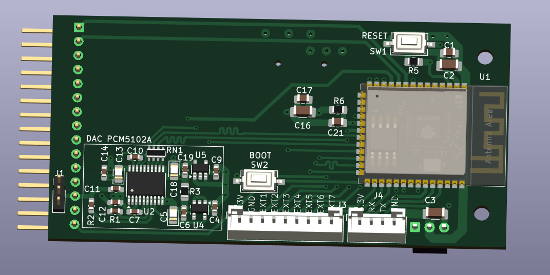

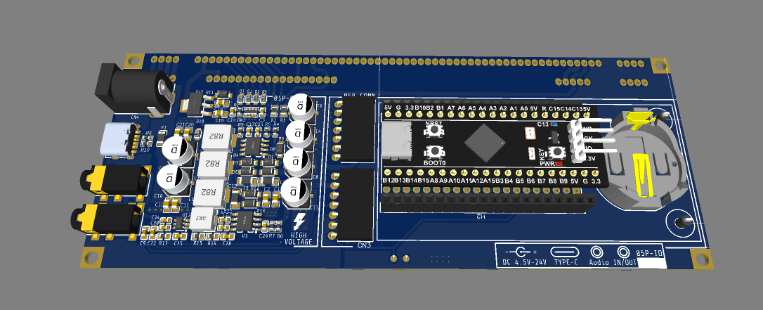

    #1928 21778423
    simw
    Posts: 758
    Help: 94
    Rate: 288
    robgold wrote:
    Then maybe you'll join us here permanently and we'll work something out together with this VFD
    A bit like between a vodka and a snack :) but here it's unlikely anything more needs to be done, details coming soon :)
    Code: C / C++
    Rendered PCB with USB-C, audio jacks, and STM32 microcontroller module
    PCB render with ESP32, DAC PCM5102A, connectors and buttons
  • #1929 21778430
    robgold
    Posts: 726
    Help: 10
    Rate: 290
    >>21778423 Is this your project ?
  • #1930 21778435
    simw
    Posts: 758
    Help: 94
    Rate: 288
    robgold wrote:
    This is your design
    The base board for the VFD is a development of a design by the Chinese who sell these VFDs - EEI Technology ELEC Studio. The design is available on EasyEDA, while the hardware with ESP32 and PCM for the controller is mine.
    I will try to put it all together soon to describe, with details.
  • #1931 21778440
    robgold
    Posts: 726
    Help: 10
    Rate: 290
    >>21778435 Looks very interesting choc with this impedance matching of the paths to PCM is a bit of an exaggeration. Looking forward to it, unless you have already managed to run something on that VFD. What I'm curious about is how these inverters work and won't they be heard in the audio ? OLEDs both 2.08 and 3.12 can be heard unfortunately.
  • Suggesting a display template for flexible layouts
    #1932 21778447
    simw
    Posts: 758
    Help: 94
    Rate: 288
    robgold wrote:
    impedance matching of paths to PCM
    I won't deny :) These were just trials with KiCad in drawing differential paths.
    Did it work, yes I already have it working with version 18 of the player.
    In further attempts, I was only hampered by the constant modification of the softwords to fit those missing pixels.
    I am of the opinion that some kind of structure would be useful, a template that would describe the xy position of specific data on the display, so that the display could be easily modified for different displays. This admittedly breaks the current design, as I understand it, but for the future I'm all for it. I've even approached this a couple of times, but unfortunately the structure of the project has held me back a lot in order to grasp it and put it together meaningfully.
