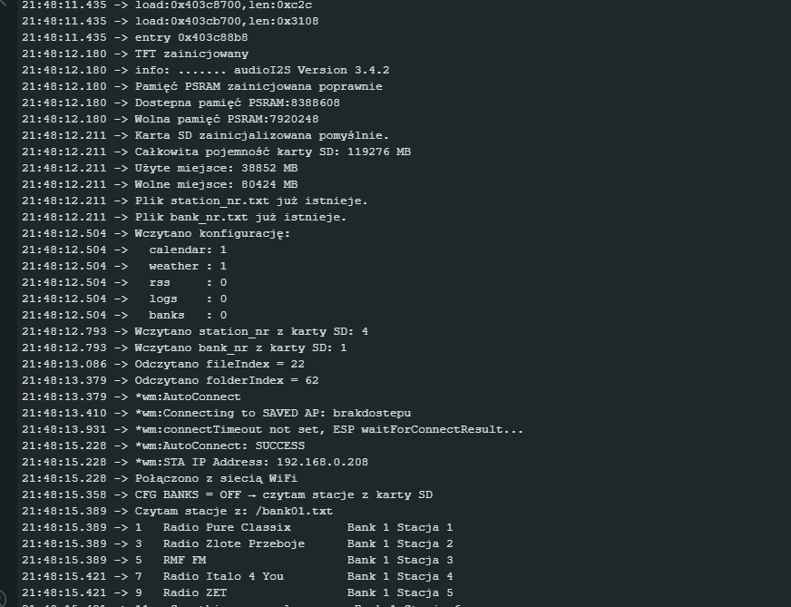

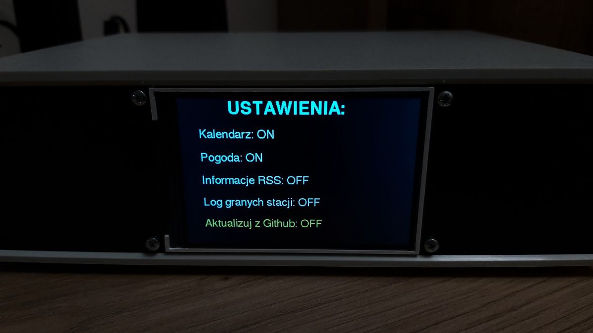

    This was a quick action, made up a new setting in the menu to enable station updates from github, if the setting is on OFF, stations when switching banks will be read from the stored on the SD card.
    Device screen showing settings, Update from Github option set to OFF
    Microcontroller boot log with memory info and Wi-Fi connection messages
  • Menu setting to toggle GitHub station updates

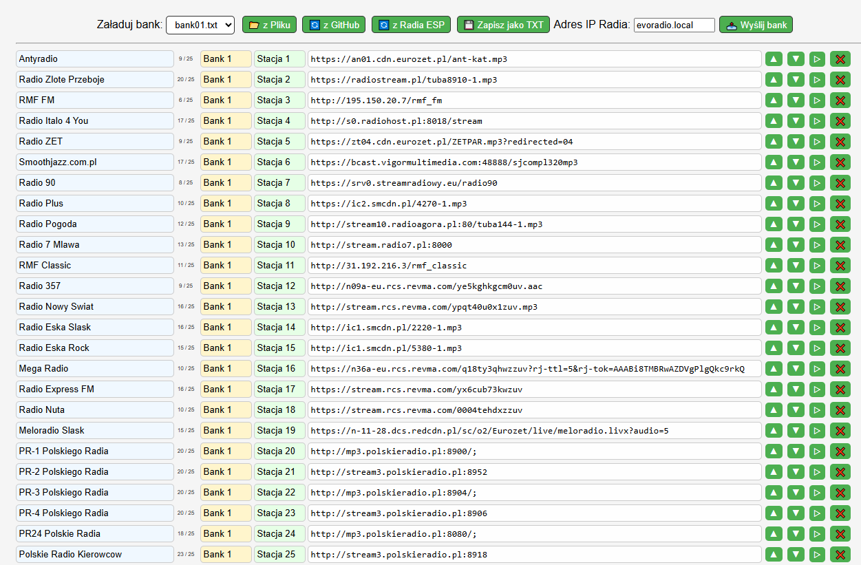

    MAJSTER XXL wrote:
    This was a quick action, made up a new setting in the menu to enable station updates from github, if the setting is OFF, then stations when switching banks will be read from those stored on the SD card.

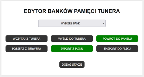

    Have you thought about something like this ?
    https://jeansoft.zapto.org/edytor/edytor_demo.html
    Screenshot of tuner memory bank editor interface with function buttons

    Added after 26 [minutes]:
    >>21781249
    I have something like this in Evo and I have the impression that I am the only person as an author who uses it. However, the most convenient thing is to have something on the PC that allows you to edit the banks as much as you want (I have an automated format in Excel with macros in VB and export to GitHub) and then upload them to the radio remotely (although the Editor also gives you this possibility).
    I think I have to borrow the separator idea from you and use the " | " character instead of a fixed number of spaces.
    Radio station list editor interface with station names, URLs, and action buttons
  • Use pipe-separated bank fields for easier editing

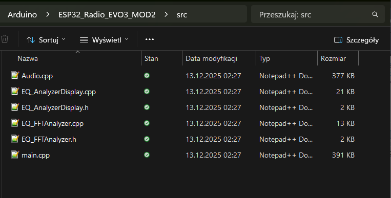

  • #1964 21782603
    ejcon
    Posts: 301
    Rate: 68
    Same as the original
  • Arduino build errors from mismatched Audio library API
    #1965 21782615

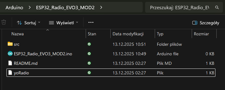

    simw
    Posts: 758
    Help: 94
    Rate: 288
    Hmm, the 3.19.53 soft compiles correctly for me from Robgold, but yours gives errors like the one below.
    I compile both softwares under Arduino 2.3.6, on Robgold's git there is also a version under Platformio, which also compiles correctly.
    Code: C / C++
  • #1966 21782621
    ejcon
    Posts: 301
    Rate: 68
    Sorry but I'm doing it with io platform and visual code

    #1967 21782625
    simw
    Posts: 758
    Help: 94
    Rate: 288
    ejcon wrote:
    You have after all a ready-made file to upload the fimware
    It doesn't work with my display, because it's a different display :)
    ejcon wrote:
    Sorry but I am doing this platform io and visual code
    I compiled a version of Robgold prepared under Platformio, so I assumed it would work here too. :)
    I also compiled YoRadio, which has the same file structure as under Platformio (main.cpp etc)
    The project structure looks like the pictures, but maybe I've overcompiled the theme and without installing Platformio it won't work.
    Screenshot of the ESP32_Radio_EVO3_MOD2 Arduino project folder with four items
    Screenshot of project source folder with .cpp and .h files in Windows system
  • #1968 21782628
    ejcon
    Posts: 301
    Rate: 68
    Enter gitchuba second repository
  • Header files in root still leave EVO3_MOD2 errors

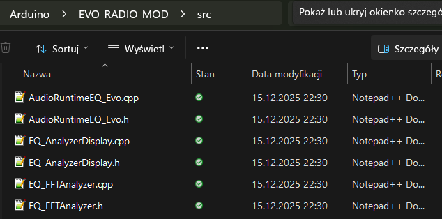

    simw
    Posts: 758
    Help: 94
    Rate: 288
    I tried compiling this:
    https://github.com/Mario2054/EVO-RADIO-MOD
    This time it worked, this is the structure of the Arduino project directory
    Arduino EVO-RADIO-MOD project folder view with source files and folders
    Screenshot of the “src” folder in the EVO-RADIO-MOD Arduino project with .cpp and .h files
    As you can see the header files are in the root directory, I did the same for the https://github.com/Mario2054/EVO3_MOD2 project but still the same errors are there
  • #1970 21782662

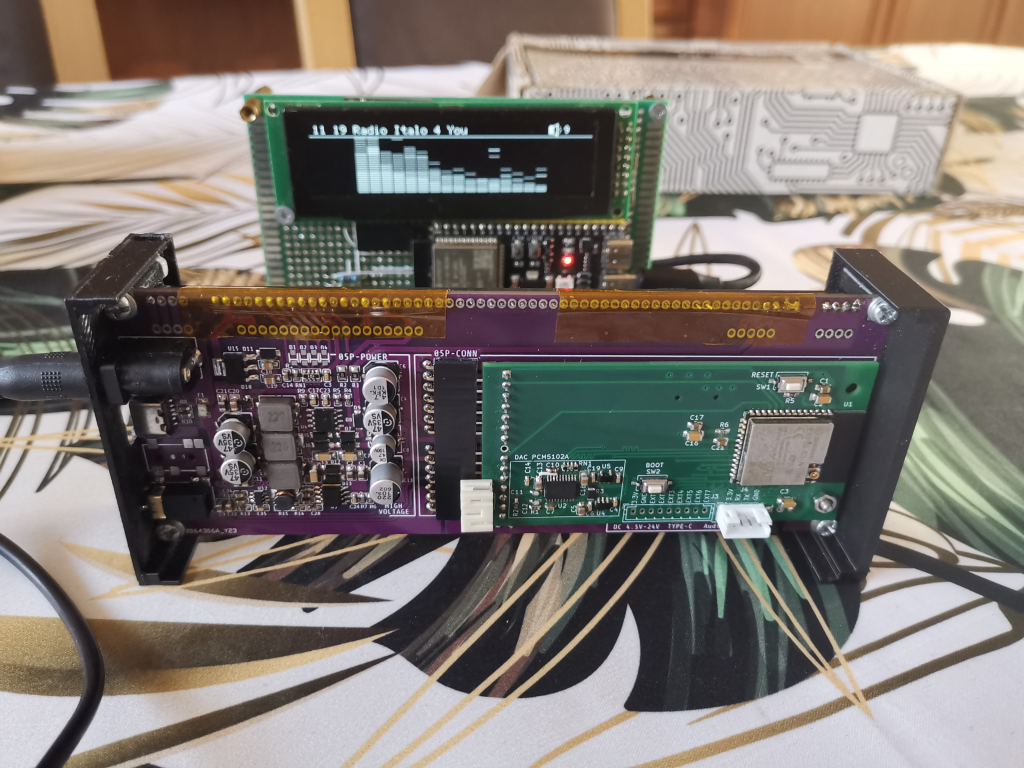

    robgold wrote:
    For the moment I think we have as follows:
    Well there goes the "first" version with a VFD display and it's quite large, 6.1 inches :)
    - Radio Evo v3 with VFD253x63 display
    Evo v3 radio module with large VFD display and visible electronic components

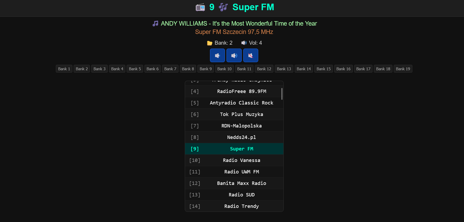

  • #1973 21783682
    hevet
    Posts: 347
    Rate: 47
    I'll brag a bit about this too, web-based operation, minimalist perhaps, but sufficient.
    Minimalist web radio player interface with Super FM station selected

  • #1975 21783732
    robgold
    Posts: 726
    Help: 10
    Rate: 290
    >>21783682 So which version do you have at home that you didn't have www support ?

    hevet wrote:
    Web service, maybe minimalist,
    As for me very nice and chic, at the same time modern :)

  • #1979 21783771
    hevet
    Posts: 347
    Rate: 47
    I have the web server in a separate file and it is impossible to swap it 1:1, I have changed a lot of functions. I went through a bit of trouble to find out why the remote control works ok, but the web server often causes the screen to go white when changing stations or banks.
    @robgold A, ok it's the server for my version on ili9488, and you thought it was for SSD1322 :) .
