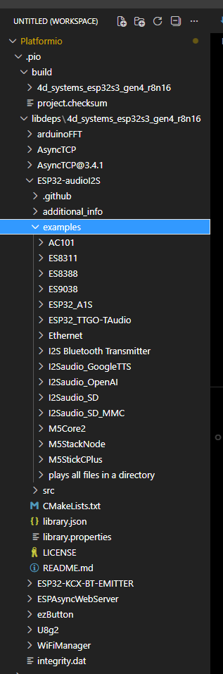

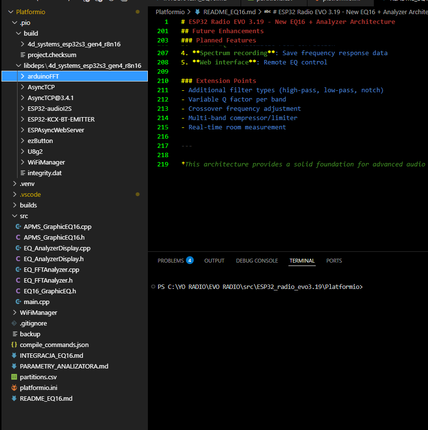

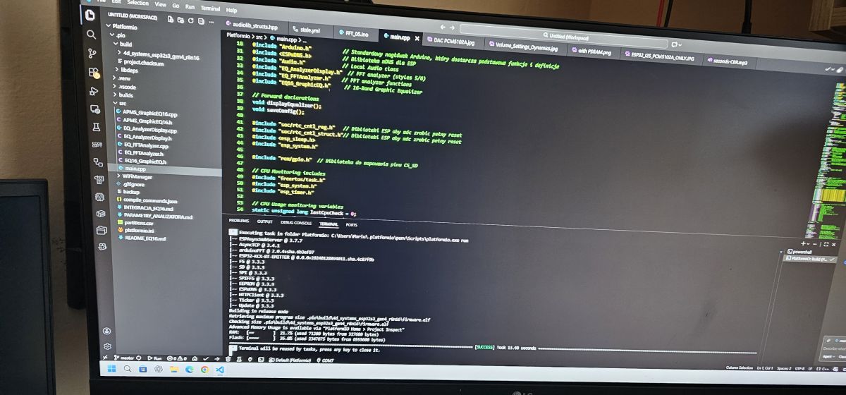

    Completely redesigned analyser and Equalizer 16 applied
    ESP-ADF shows a better way
    The best solution for the ESP32-S3:
    IIR biquad
    fixed-point Q31
    16 bands
    ±16 dB
    Check how FLAC and AAC work I look forward to your suggestions.

    Screenshot of an ESP32 project with EQ16 analyzer and PlatformIO interface
    Project tree in PlatformIO showing ESP32-S3 audio library examples

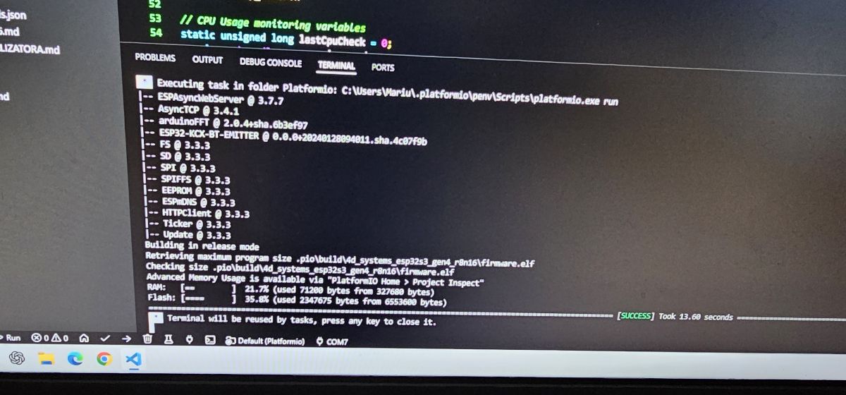

  • Missing ASYNCWEBSERVER_REGEX and setGraphicEQ16 method
    #1982 21785247
  • Missing setGraphicEQ16 and enableGraphicEQ16 methods
    #1983 21785261

    kula350 wrote:
    Compilation error: 'class Audio' has no member named 'setGraphicEQ16'
    I have the same
    Code: C / C++
  • API mismatch with current Audio library
    #1984 21785356

    I can't compile any version either.
    I am now focusing on the V2 version and I get this message all the time:
    C:C:³³³³³³³³: no matching function for call to 'Audio::getBitRate(bool)'
    2482 | bitrateString = audio.getBitRate(true);
    c:c:uint32_t Audio::getBitRate()'
    138 | uint32_t getBitRate();
    C:\Users\Sekcja\Documents\radio\V2\ESP32_radio_player_v2-main\ESP32_radio_v2\ESP32_radio_v2.ino:3479:15: error: 'class AudioBuffer' has no member named 'changeMaxBlockSize'; did you mean 'getMaxBlockSize'?
    3479 | audioBuffer.changeMaxBlockSize(16384); // method call on audioBuffer object // is default 1600 for mp3 and aac, set 16384 for FLAC
    | getMaxBlockSize
    Found multiple libraries in "HTTPClient.h"
    Used: C:³³³³AppData³³³ LocalArduino15³³³ packages³³³hardware³³³ 3.3.3³³³ libraries³³HTTPClient
    Unused: C:UsersAppDataLocalArduino15librariesHTTPClient
    exit status 1
    Compilation error: no matching function for call to 'Audio::getBitRate(bool)'
    What can I do with this to get it to compile properly?

    >>21785356 Writing v2 you compile an old version of the Major, my ?

    ejcon
    Posts: 301
    Rate: 68
    I will send you a video of how it works now;
    Code editor showing main.cpp with C++ code and build success message in terminal Terminal showing PlatformIO build output with SUCCESS message

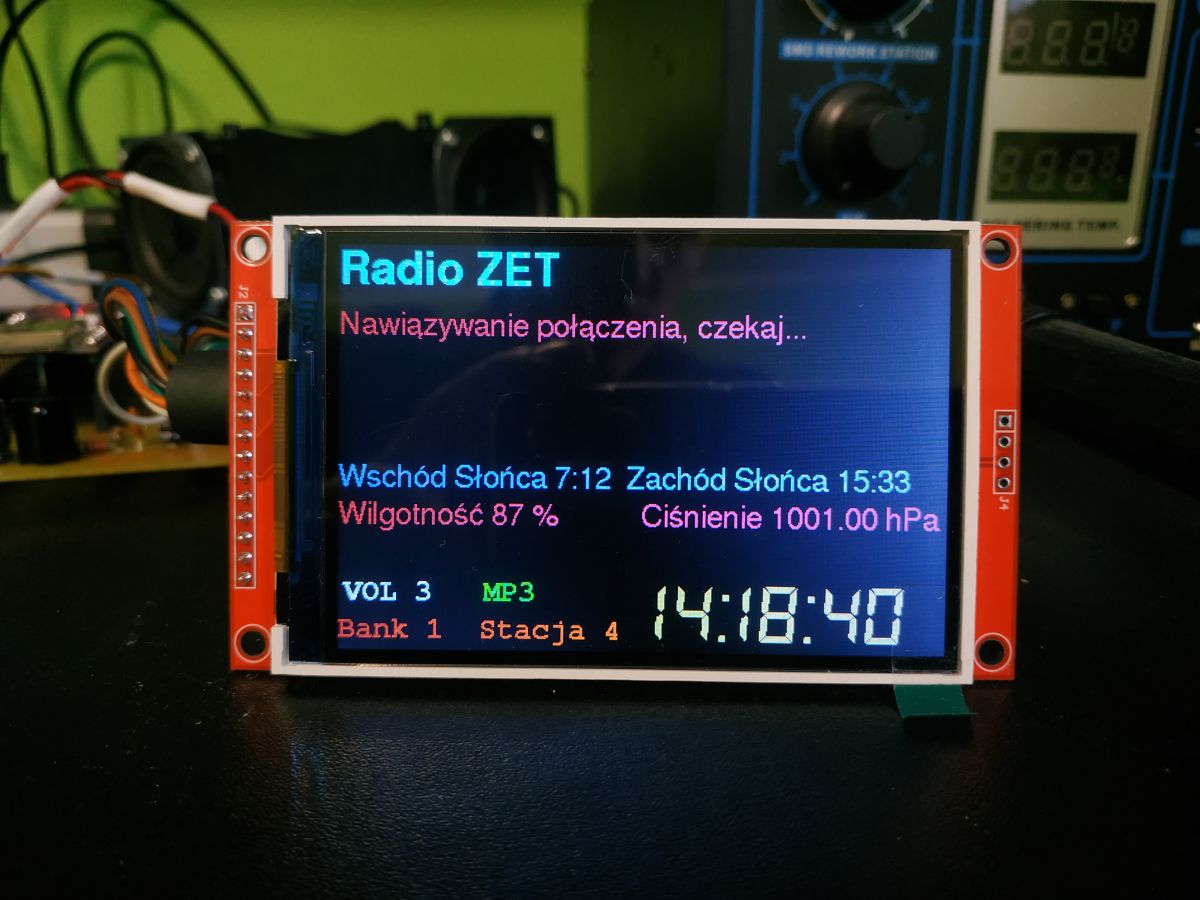

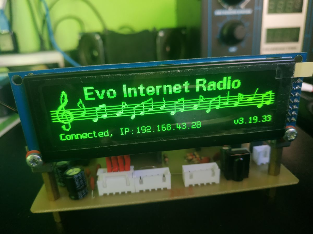

  • V2 is outdated; use current V3 or OLED version
    #1996 21785669
    DJCheester
    Level 28  
    Posts: 2089
    Help: 75
    Rate: 958
    terminux wrote:
    robgold wrote:
    >>21785356 By writing v2 you are compiling an old version of the Major, my ?
    I download the v2 version from the link on the first page which is probably the Majatra version.
    This is a very outdated version, the author himself no longer supports it, he now has V3 with a colour LCD like this.
    Color LCD showing weather and radio info in an electronics workshop background
    And Robgold's version on a mono OLED display such a version.
    Close-up of Evo Internet Radio device with a green monochrome LCD display.
    Virtually everything but the ESP has changed since the V2 version.
    Greetings ...

    >>21785650 To compile such an old version you must (preferably under Platformio) create a project into which you download all the old libraries from that time including ESP core and Audio. Otherwise nothing will work. The audio library is in constant development and a few things have changed in it (just how the stream information is passed on) so it won't work with the latest libraries.

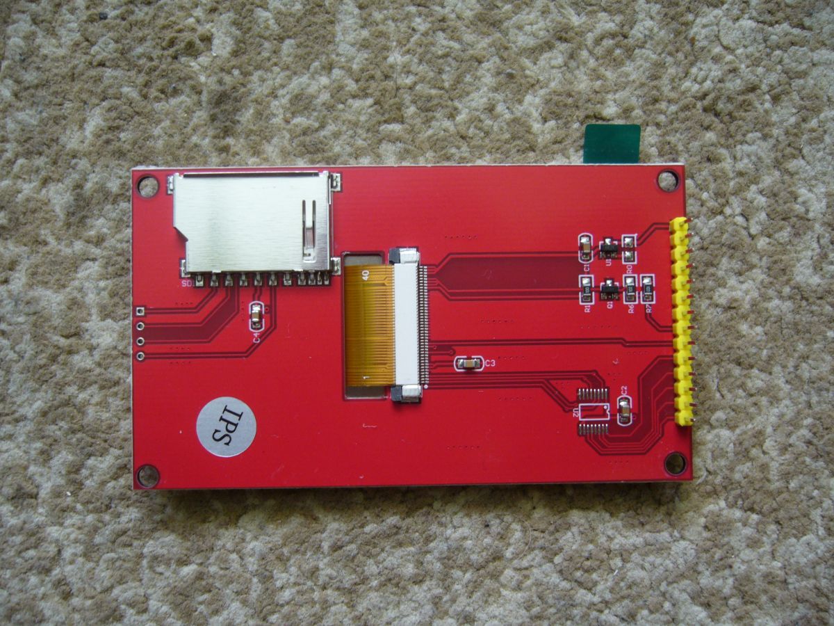

    There is a 0 Ohm resistor above the diode you need to remove it, on some PCBs from ESP it is signed as RGB
    Greetings ...
  • #2004 21785977
    slaslo
    Posts: 185
    Help: 24
    Rate: 56
    In terms of the RGB diode, there are also sometimes jumpers brazenly soldered, and it also happened that the pads were connected by a micro-path and you have to use a scalpel and make a cut.

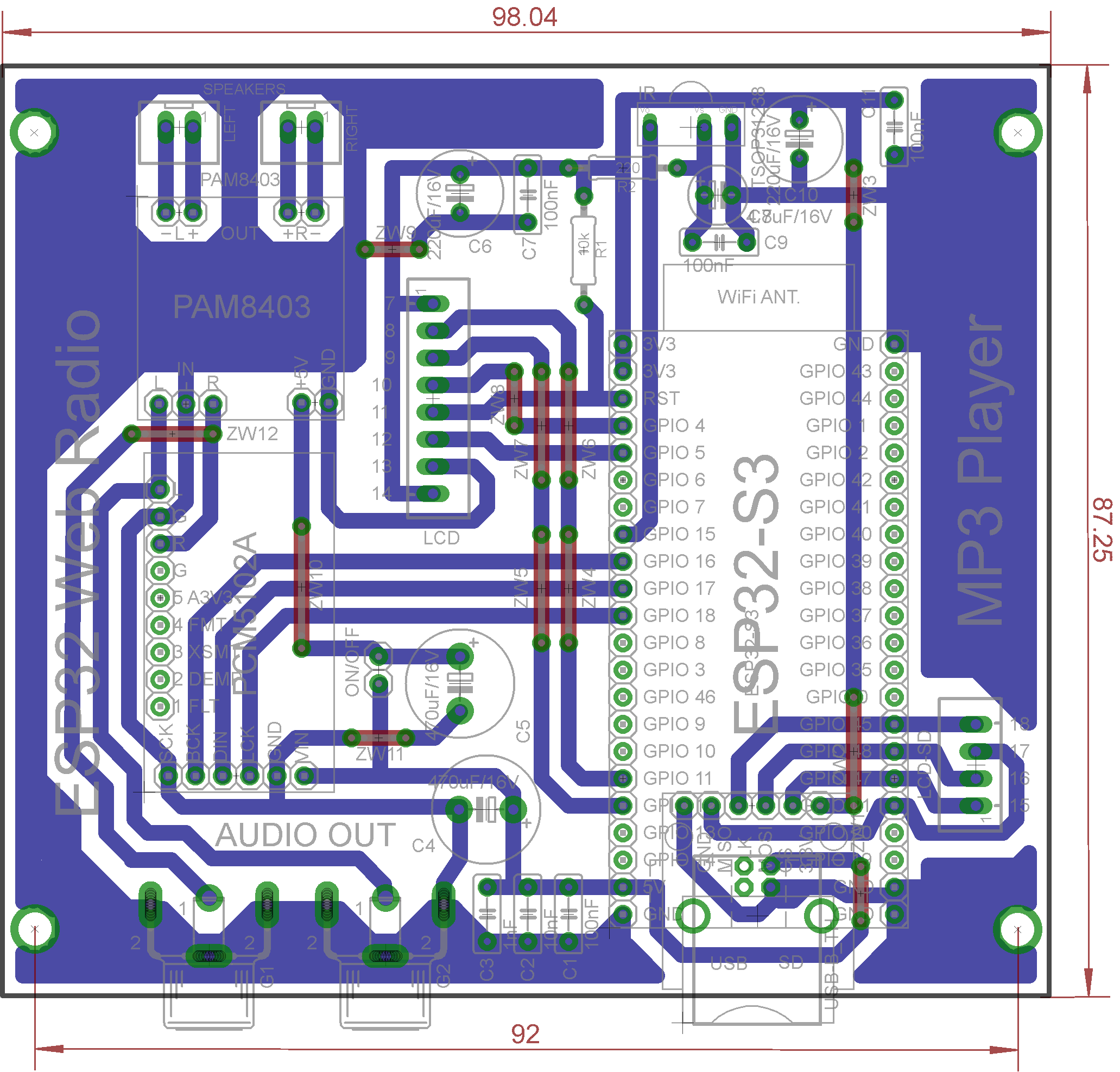

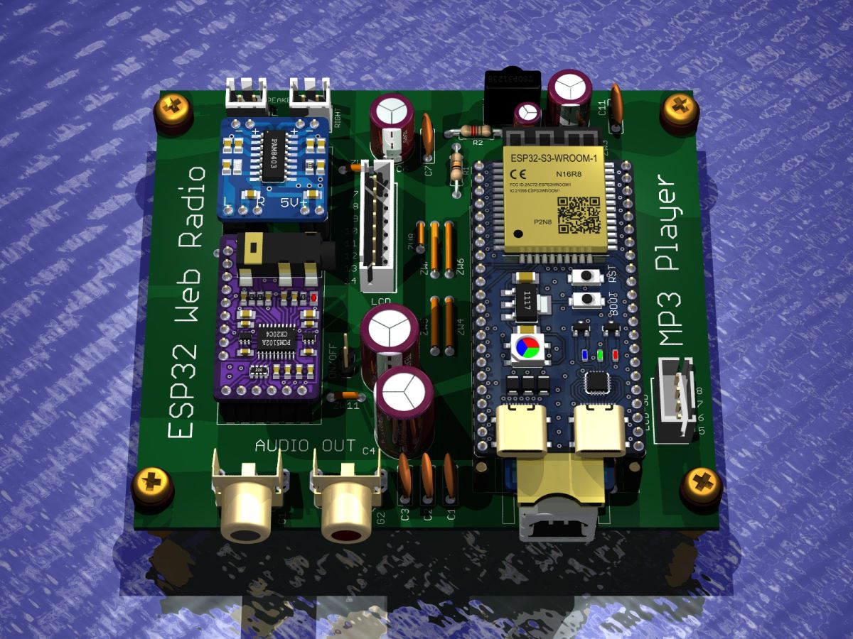

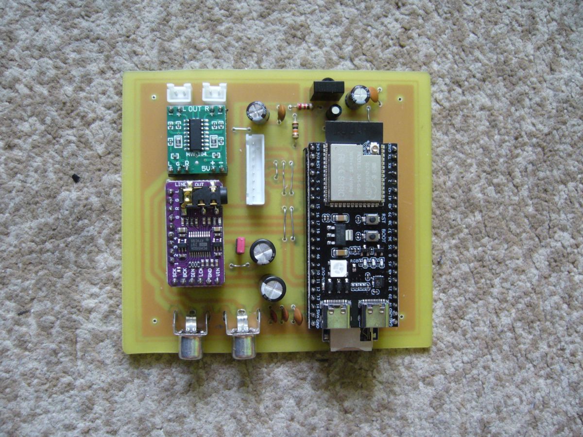

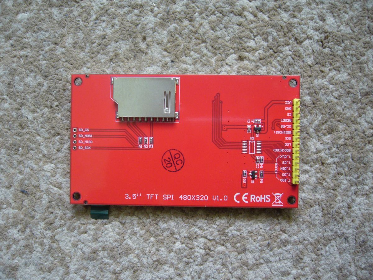

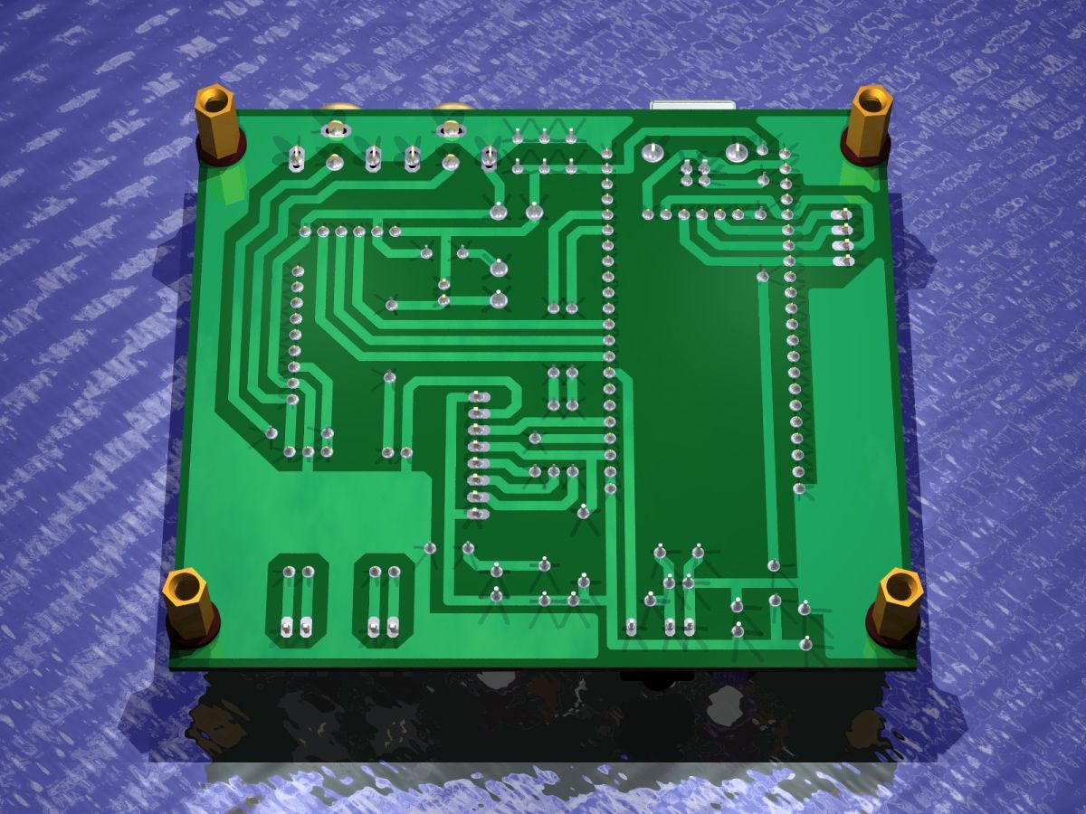

    Hello, as I am getting enquiries about a PCB for a Majster v3 radio with colour LCD.
    I am posting the project files, pdf file for thermal transfer, and gerber files for china production.
    I have in mind this project and this soft
    https://github.com/sarunia/ESP32_internet_radio_v3
    The pins on the PCB coincide with the declarations in the script.
    Green ESP32 PCB with labels for LCD, ESP32-S3, amplifier, and audio output modules
    Bottom side of green PCB showing traces and mounting holes for components.
    Board prepared for ready-to-use goldpin modules
    PCB with ESP32 module, PAM8403 amplifier and RCA audio output connectors
    Bottom view of green PCB showing traces, pinholes, and four metal standoffs in corners

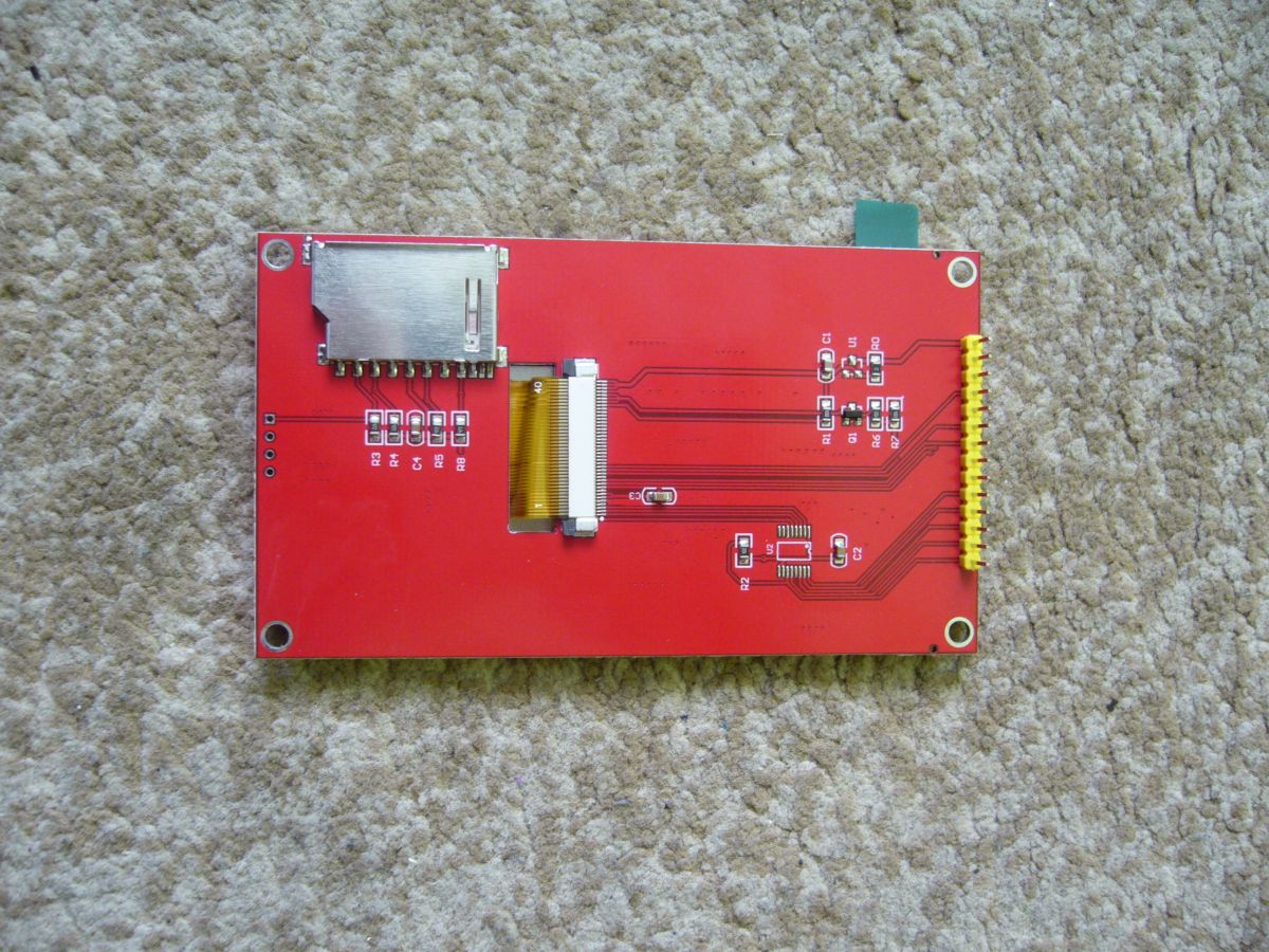

    Brief description of the JST connectors or LCD with pin descriptions under a dedicated LCD - 3.5 inch and 4 inch of this type works.
    Red LCD module with SD card slot, FPC connector, and yellow pin header
    3.5-inch color LCD screen on red PCB with labeled signal pins
    The second JST connector called LCD SD is used to use the SD card module mounted on the display. Simply connect.
    There are different versions of the display - the one shown at the top has no resistors at the SD card pins so will work fine.
    Red 3.5'' TFT SPI board with SD slot and pin header on a carpet background
    Red LCD display module with SD card reader lying on a carpet
    In the case of those at the top, the resistors at the SD card slot must be removed for the reader to work. Depends on the type of display, need to compare.
    Gerber loads correctly on the JLCPCB website, I didn't order these boards, the design checked works for me - I prototyped using thermal transfer.

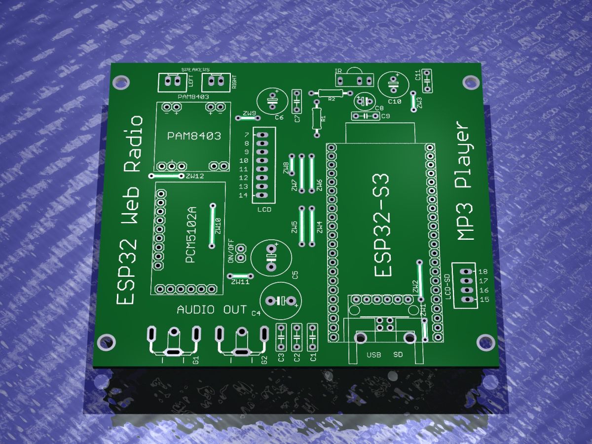

    Assembled PCB with ESP32, PAM8403 amplifier module, and RCA connectors

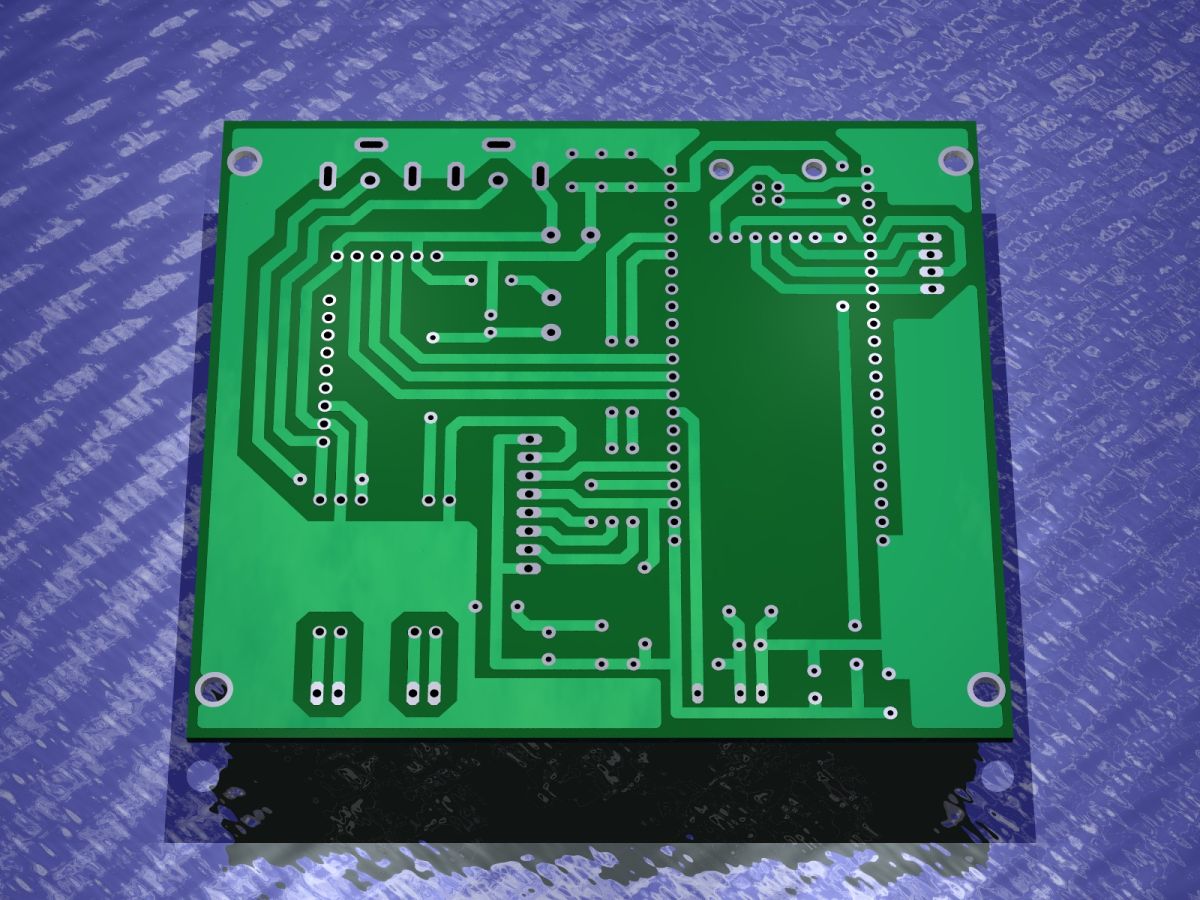

    For the thermal transfer, it is necessary to make the jumpers marked in the view below.
    Projection view of ESP32 PCB with traced paths and labeled pin headers.
    When ordered from china, the jumpers are made on the outer layer.
    In the project I used a cheap PAM8403 stereo amplifier, it can be unassembled and receive the signal directly from the chinch sockets, however if someone would like to make a radio for themselves, e.g. for the kitchen, such an amplifier will be enough to drive two small speakers.
    The uSD card module is designed under the ESP module, it is best to buy a module with unsoldered pins, in the standard they give a length of 12mm - I suggest to buy a longer one, i.e. 18mm available at auctions, then the ESP module will be higher above the board and the uSD card module beautifully fits under the ESP module.
    And the issue of the antenna - some people wrote that the antenna should be designed differently, however, in my case, such solutions work and the radios play, if someone will be strongly disturbed by this on sale ESP32 S3 modules with an antenna socket - you can buy such a module and the antenna for this and either glue further on the antenna board or using the socket to expose outside the antenna screwed under the SMA socket.
    So much for design issues.
    Regards

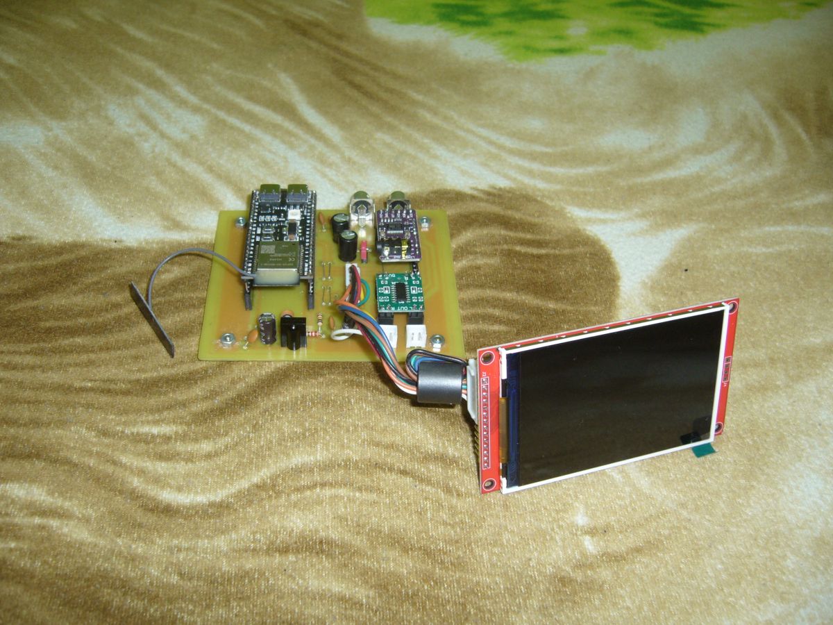

    Well the finished looks like this ;)
    Prototype board with ESP32 module and connected TFT display
    Color display shows weather data, radio info, and a digital clock.
    Greetings ....
