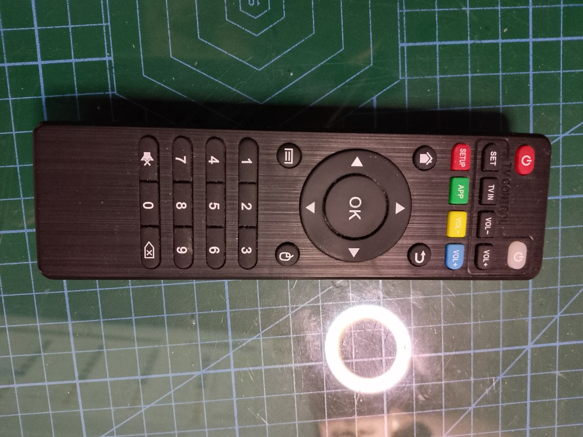

    kula350 wrote:
    The pilot codes are in a separate file in the "data" folder called "IRcodes.h". Customise there to suit your needs. I had a different remote control
    And that's something I'll look into tomorrow but in the main sketch you also have the arrows stuck in and ok on the rigid, why such a treatment ?
    Greetings...
  • #2433 21856061
  • #2434 21856067
    DJCheester
    Posts: 2049
    Help: 75
    Rate: 949
    kula350 wrote:
    I don't know. It's easier for me to tinker with codes. I think it's just that
    And ok everyone combines as it is easier for them 😀
    Question how did you change the image in the h file ?
    Greetings....

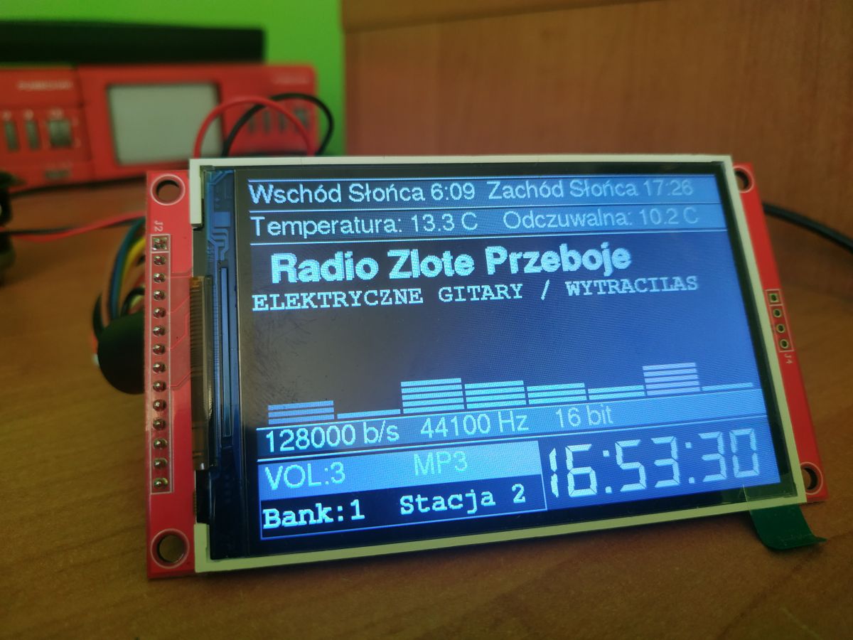

    Kula350 with what do you change these views (what button) I have assigned these buttons what Majster had as my own I can control select MP3/Radio and I can not do these views ???
    And second question I have very pale colours ??
    Greetings ...

    krzychokup
    Posts: 35
    Thanks . As for the colours try changing the display pin from the base code ESP32_radio_v3_ILI9488_canvas.
    Added after 17 [minutes]:
    You may have a display with the colours reversed. The topic existed in an earlier post ->
    tft_command(0x21);
    Jeset is a colour inversion, I added in line 869 after:
    // Image direction and orientation (MADCTL)
    tft_command(0x36);
    tft_data(0xE8); // screen orientation (rotation, reflection)

    DJCheester
    Posts: 2049
    Help: 75
    Rate: 949
    Colours and orientation are good only pale what you wrote is for IPS I have TN

    DJCheester
    Posts: 2049
    Help: 75
    Rate: 949
    I did the codes, the colours well it looks much better in the pictures than it does on me and which screen do you have TN or IPS ,?

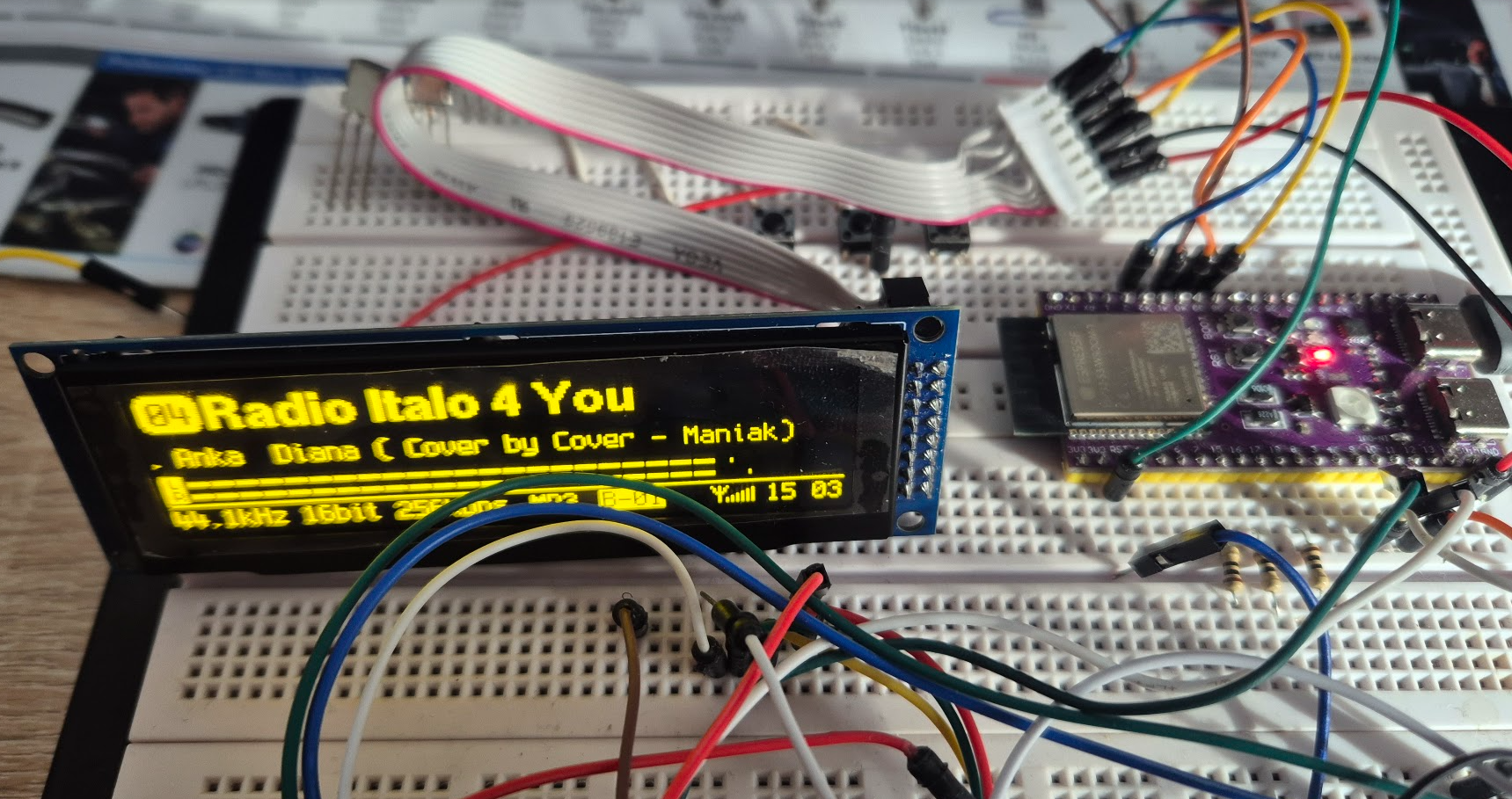

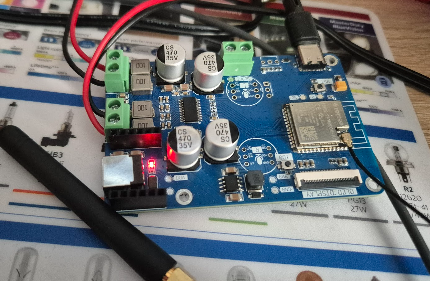

    Such a curiosity for you. Two pictures...someone will say, what does this Robgold show, a picture of the Evo and still from a contact board but not really. The radio is "fired up" on the Sonocotty ESP32Lauder board (I think that's the name of this version with ESP32S3 and TAS5805 - just a ready-made one with a TAS amplifier) while the other board is nothing but "Remote OLED Evo Radio".
    Breadboard prototype with an ESP32 board and a yellow display showing the station “Radio Italo 4 You”. Blue PCB with an ESP32 module, capacitors and terminal blocks, connected via USB cable.
    This simple system was born out of the need to take a quick screenshot of the radio display for subsequent version descriptions here on Elektroda and so I thought to myself since it already works what if I wanted to have such an additional control panel for the Evo but not based on a browser and phone...a crazy idea was born in my head and the realisation came :)
    Of course, everything can be read faster using data from a dedicated WebSocket or over UDP but here I have the maximum simplification of simply dumping all the display content onto ASyncWeb and receiving on a second ESP, throwing the buffer there on the ESP "as it came" then onto SPI and the display.
    This is what a simple web page looks like allowing you to record videos, take a PNG snapshot.
    Screenshot of “SSD1322 Live Monitor” showing Radio Italo 4 You station and track information.
    Video recorded using a script on www:
    Tested on 2Mbps FLAC, with simultaneous OLED buffer reception on PC and in parallel on ESP - works stably.
    I'm throwing in as a curiosity about how humans sometimes create things that are completely bizarre <br/span>;)
