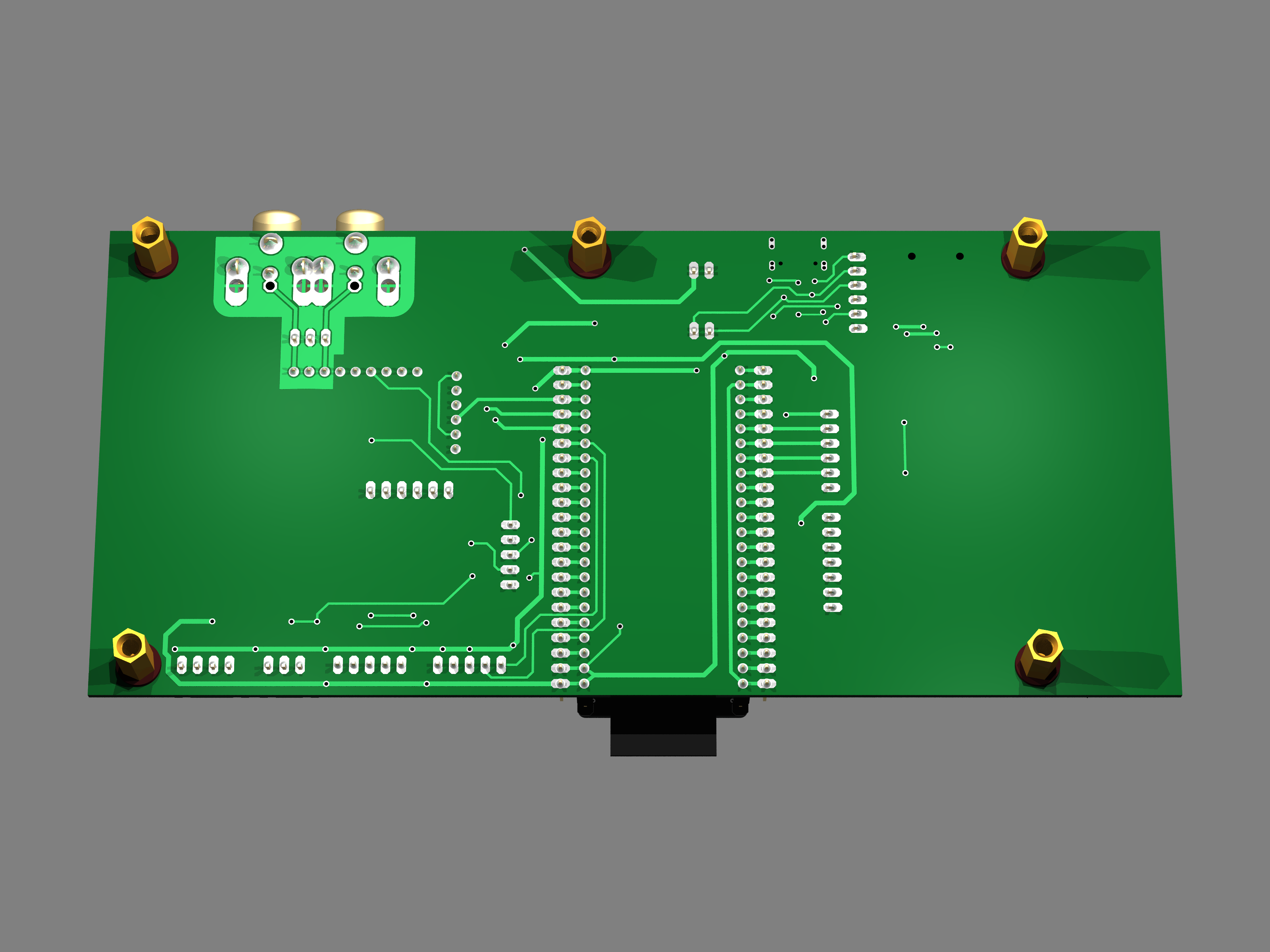

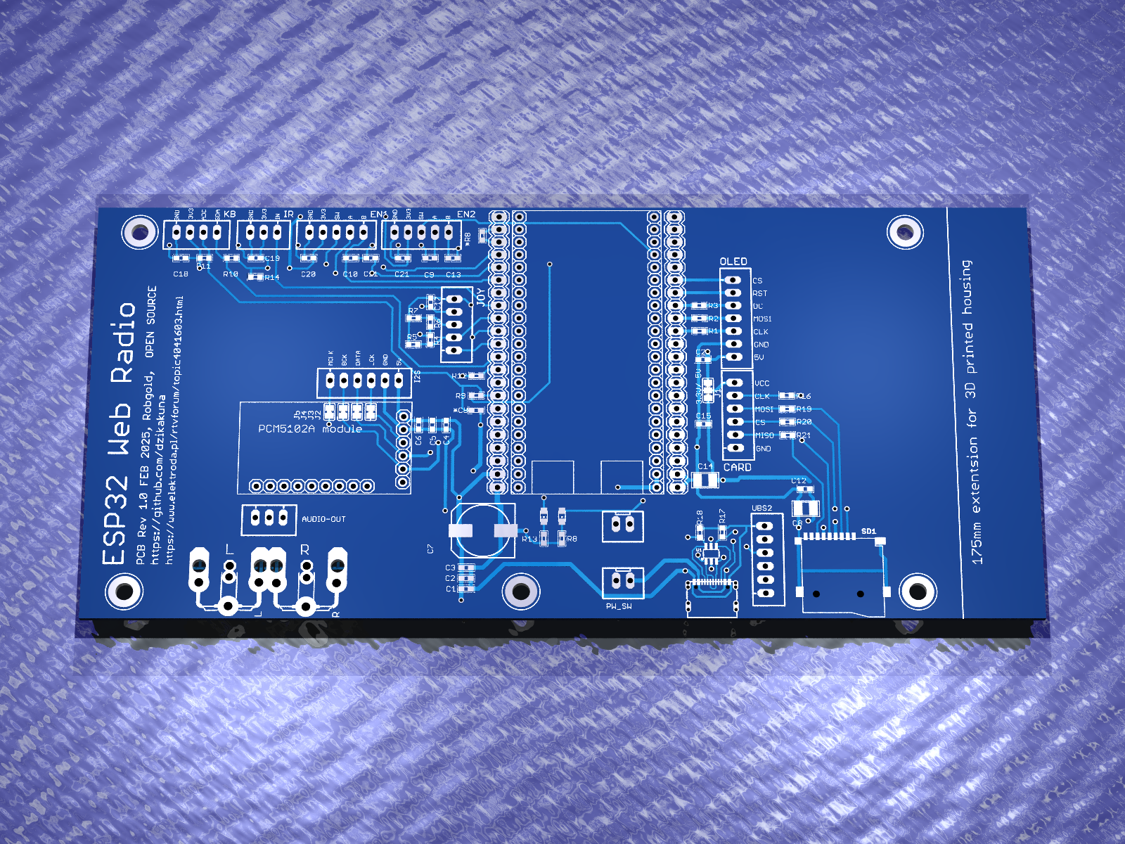

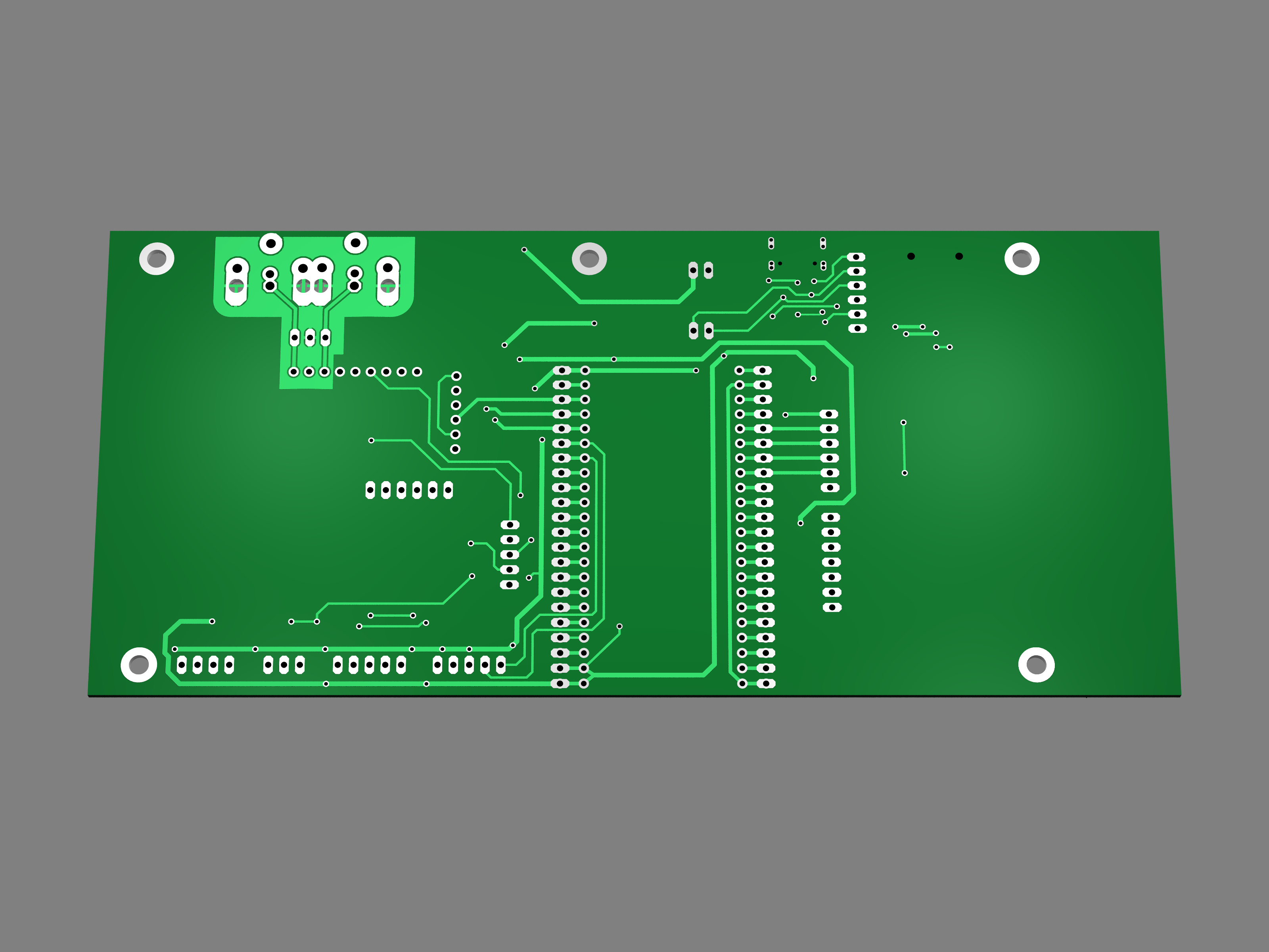

    I agree, but that excess PCB is due to the slot in the printed (175mm) or aluminium case (160mm). It's not my extravagance, but a deliberate procedure. Otherwise you will save on PCBs, but you will have to foresee a bonded mount with a snap pin, like in the old PC for motherboards.
    The voltage selection jumper for the cards has flown in, but I'm not completely convinced. Those off-the-shelf SD modules are moderately suitable for ESP. They have pull-up resistors on almost every line, on top of that converting the signal to 5 V to then go back to a 3.3 V interface. As for the converter, I don't really see where to plug in that MCLK pin. It would have to be instead of the JOY, but this @wirbud would have to confirm that using GPIO16, 17 or 18 is possible.
    Fragment of a printed circuit board design with visible traces and pin labels. .

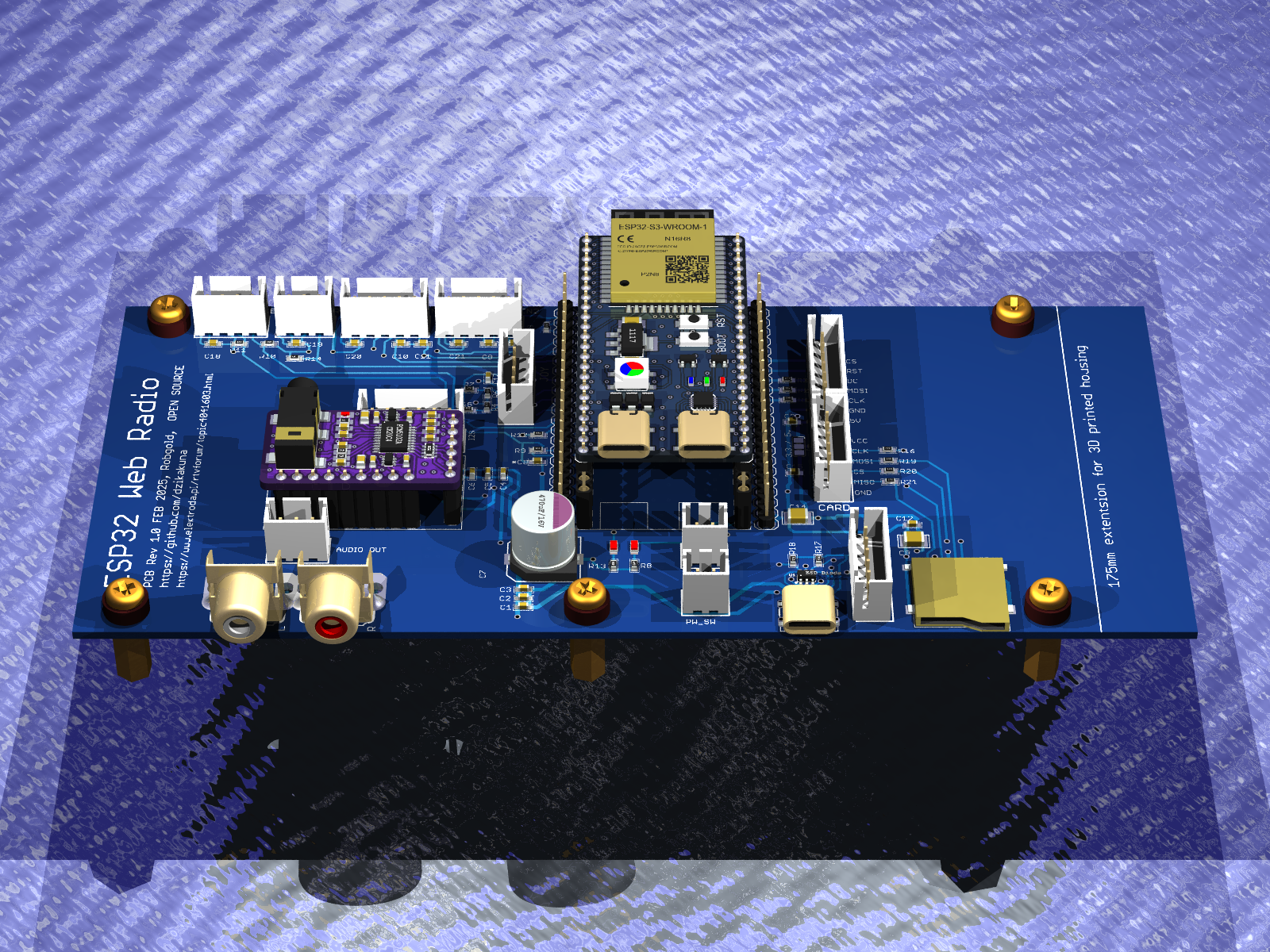

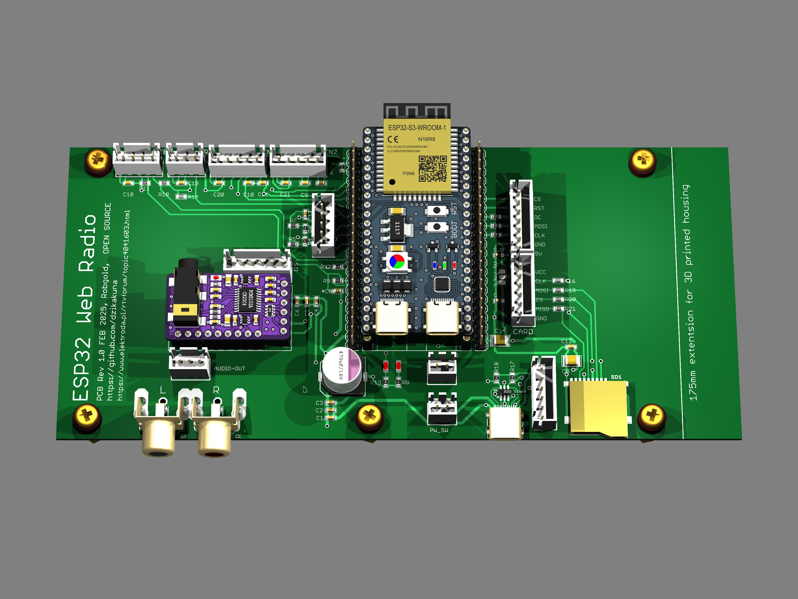

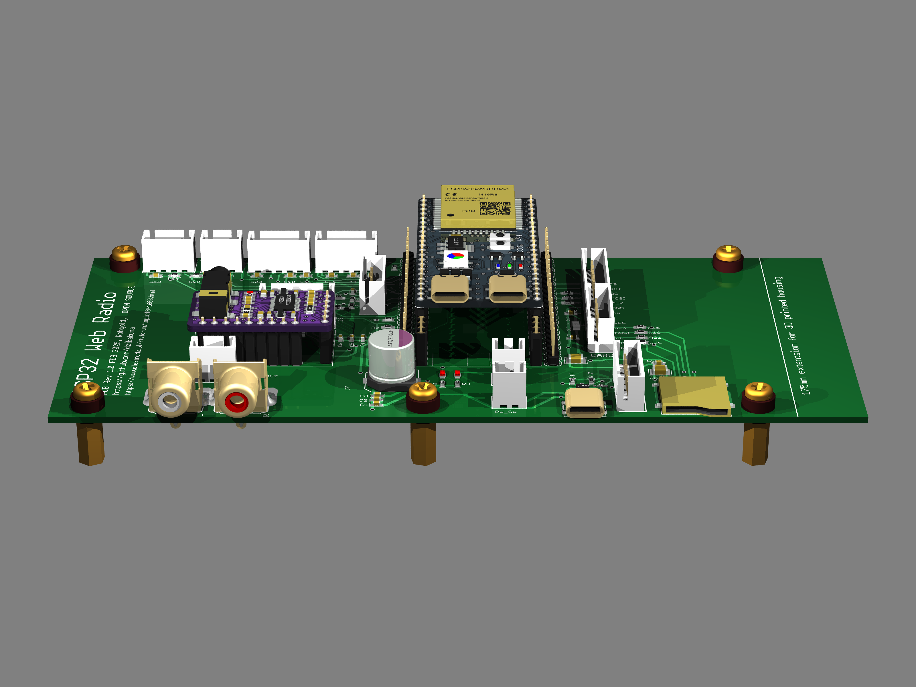

    Hi robgold if you want send the brd file I will make a render so you can see what's what on the PCB ;)
    Added after 3 [hours] 26 [minutes]:
    PCB board ;) by colleague robgold ;) .
    Render of an ESP32 Web Radio PCB with various components and connectors. .
    Render quickly - sockets you can see a colleague used different than I have 3D models but the general view is ;)
    Regards ...

    DJCheester wrote:
    Render on quick - sockets you can see a colleague used other than I have 3D models but the general idea is

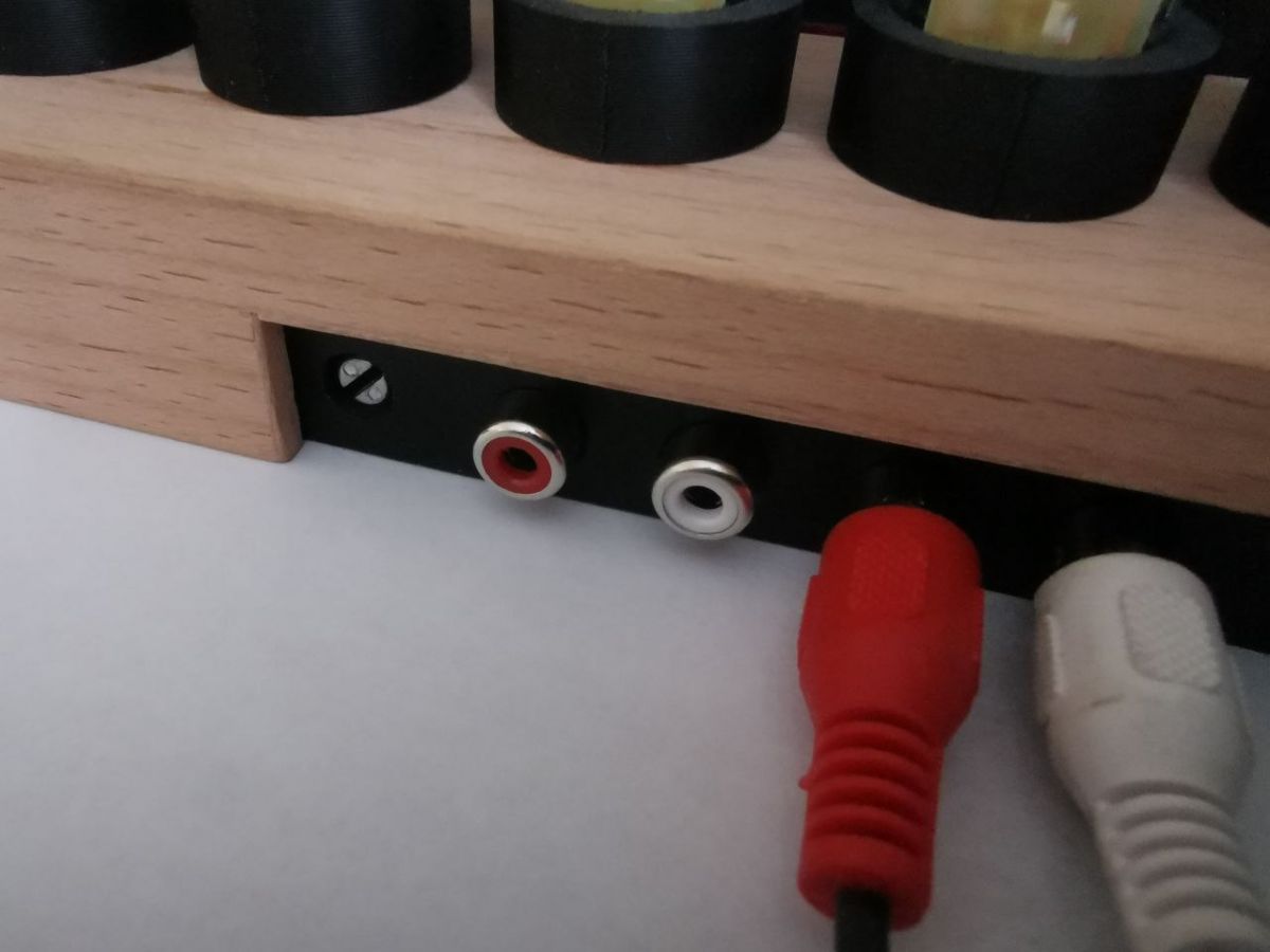

    The RCA sockets should be as close to the edge of the board as possible. I mounted them in another project. The rear wall of the case at this point should be as thin as possible. With a tin case there is no problem, but with plastic cases or 3D prints it is worth paying attention to this. I gave 1mm and it is ok.
    Below is an example of the undo on a veneered 3D print with a 4mm wall
    Close-up of RCA jacks mounted on a wooden enclosure with connected cables.

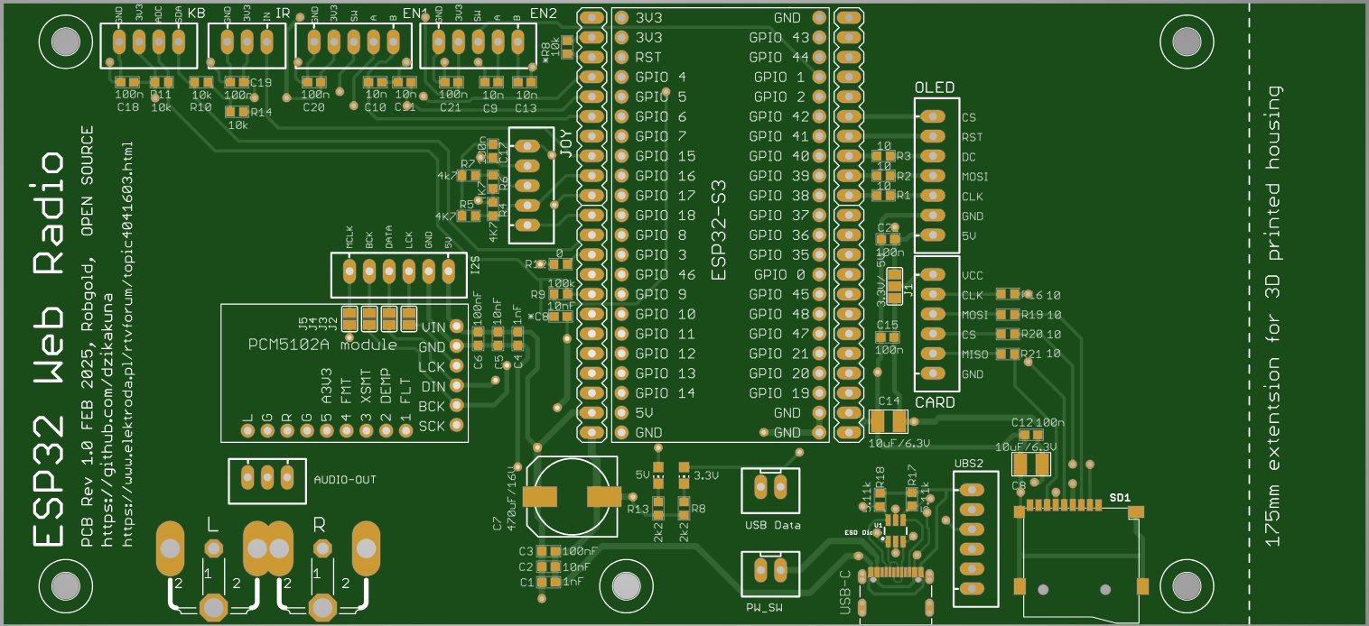

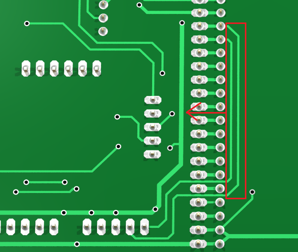

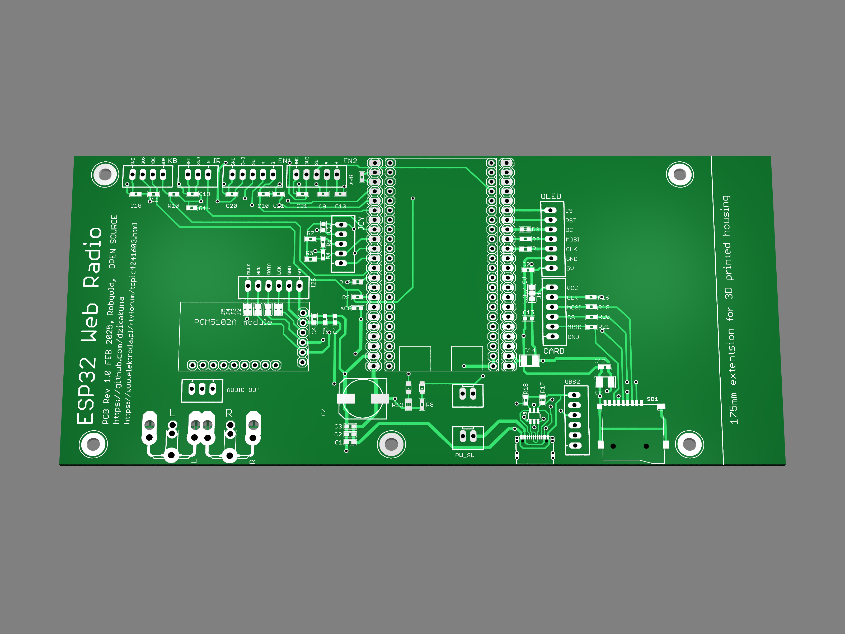

    @DJCheester , I've uploaded the PCB and schematic files to GitHub, cos on this visualisation the USBC slot has gone awry and the SD card slot is 180st reversed. Also correct that big electrolyte, on the visualisation it has reverse polarity. If you can, make a visualisation of the new board.
    @efi222 in case of RCA sockets it is enough to make a bigger hole in the case and the socket itself can even be flush with the case surface. That's how they did it in older equipment. Especially with sockets like the one in the project mounted directly to the PCB it is not possible otherwise. They are very short.
    Remember that this is actually a simple breakout/test board and not a target PCB. I'm just fed up with the contactor board starting to have a life of its own.
    ESP32 Web Radio PCB design with highlighted components. .

    Yes I know I saw the imperfections, just used different libraries than me will improve tomorrow as for the uSD slot do you have that close to the leg on it physically have that slot ?
    I was sent to work today and there was no time to get these details right.
    Also check the footprints from Chinch because they must have elongated pads and mine fit perfectly on the connectors and the ones on the schematic are probably too long, you would have to make a printout and check.
    Regards...

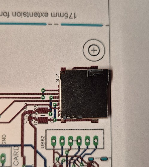

    @DJCheester Yes, I have such SD card sockets even a whole packet for PLN3 from Ali :) This is a standard microSD socket with spring latch. The chinch sockets are tested. The diameter of the hole is important and the PAD itself is how you like it. It is easier on production to make round holes than to mill for a tin. Here is a PDF for these sockets Link I have still fine-tuned them a bit. I generally try to use my libraries and draw myself the components because then there are surprises when the PCB arrives.
    MicroSD slot mounted on a printed circuit board layout. .

    See before you send this socket to china
    https://allegro.pl/oferta/gniazdo-rca-cinch-do-druku-katowe-zolte-10605418327

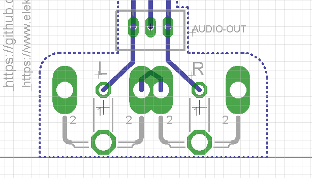

    Because there you have to have longitudinal pads and this your library under Chinch will probably not fit because I made my PCB from mine and when I inserted it on your PCB the pads did not match. Unless you use other Chinch e.g. the ones with plastic ?
    If something happens, I will improve mine tomorrow and I can send it to you.

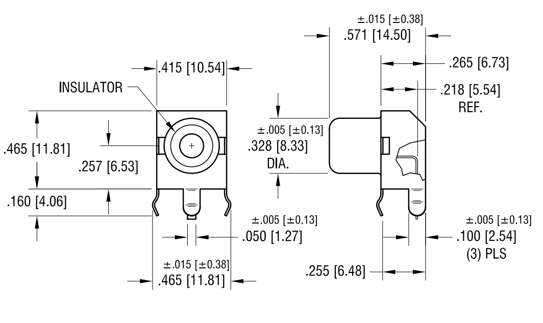

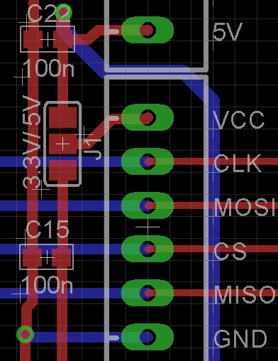

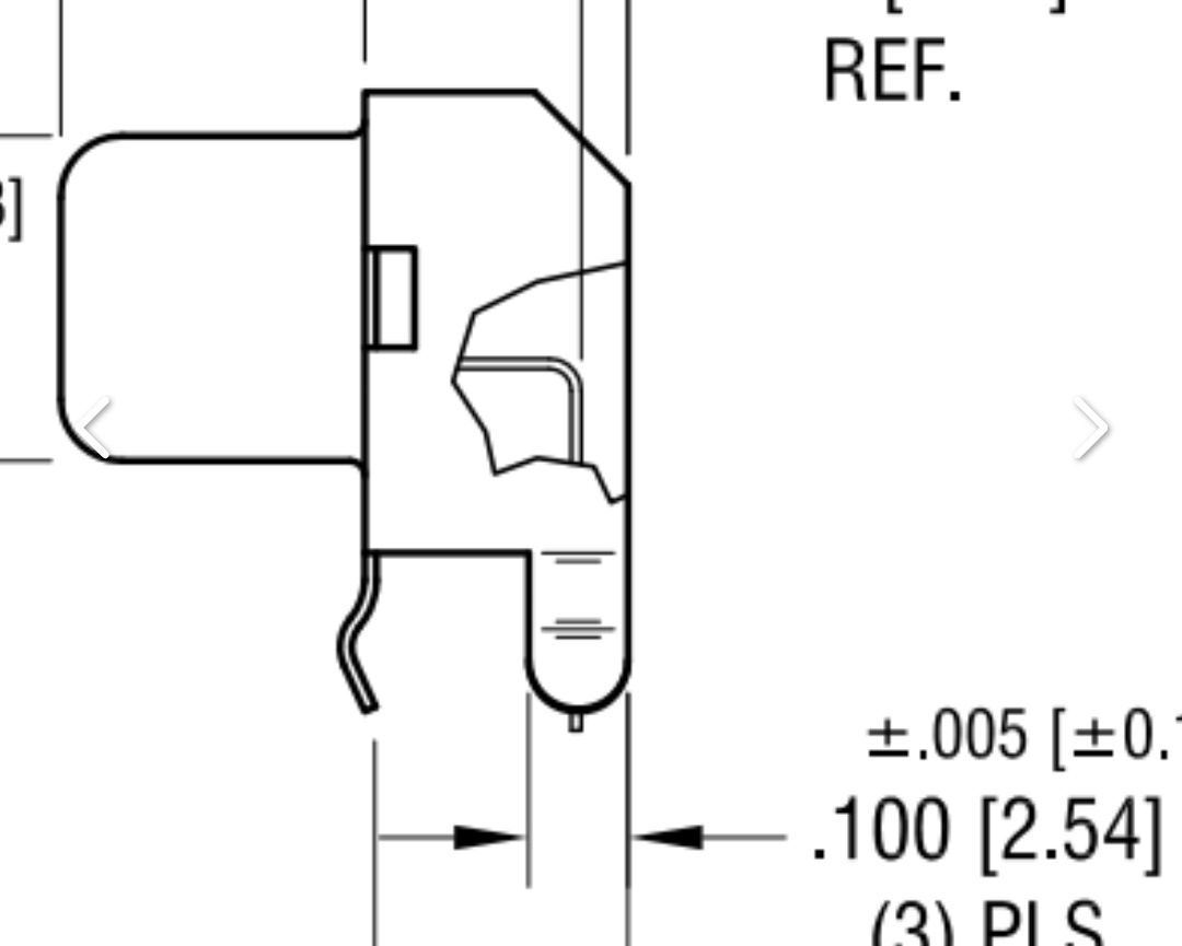

    The pads for these plates can also be round, the important thing is that the diameter matches. I have corrected some distances in the library.
    Electronic circuit layout with hexagonal and oval pads, with a 5.08 measurement between them. .
    Technical drawing with dimensions of an electronic component, indicating length, width, and diameter. .

    Side pad is 2.54 better to give oblong holes
    Technical drawing of a detail with dimensions. .
    Greetings...

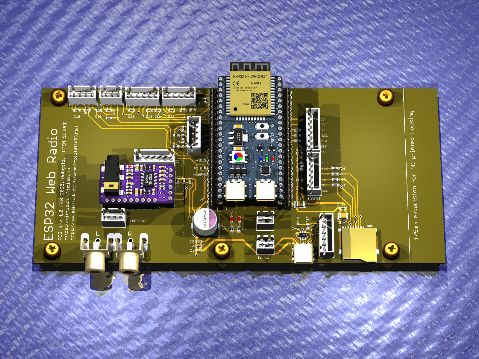

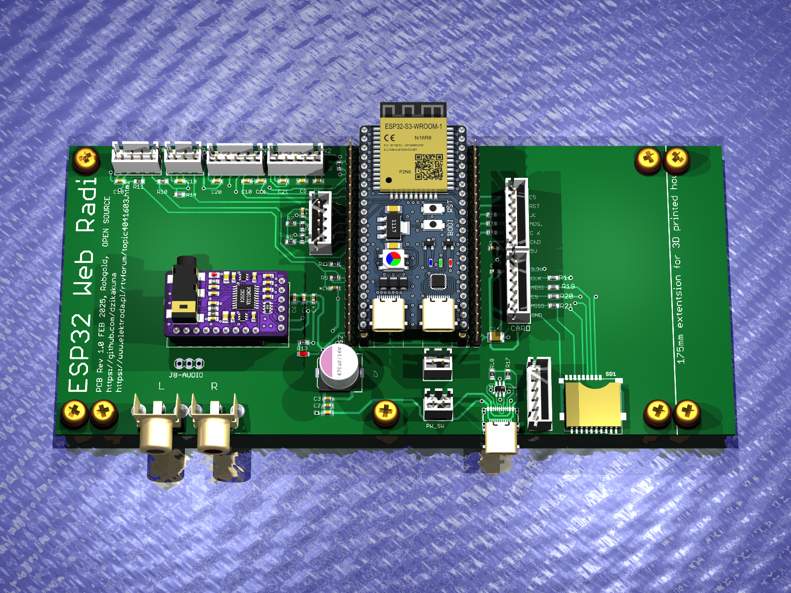

    Here is the render ;)
    Render of a board with an ESP32 module, chinch sockets, and various electronic components. .
    Render of ESP32 Web Radio board with added chinch sockets and shifted pads.
    Rendered PCB of ESP32 Web Radio with adjusted chinch socket pads. .
    PCB render with traces and holes for chinch sockets. .
    I applied my chinch sockets to this board you can see how the pads from the sockets are offset. I have corrected the rest.
    Greetings ...

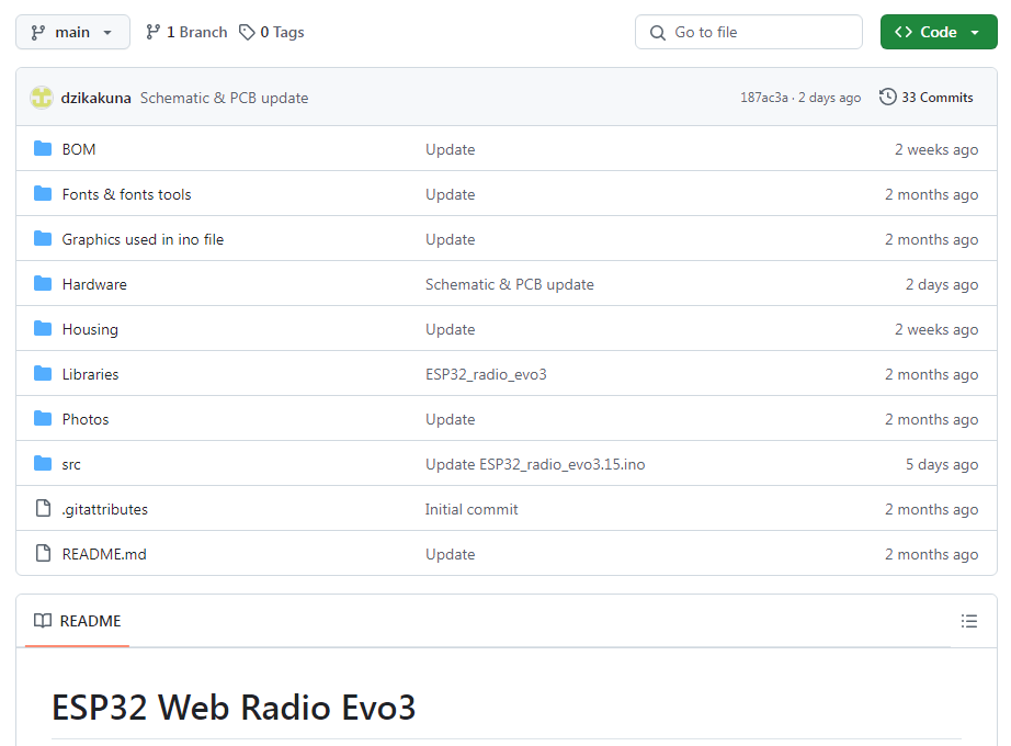

    Robgold I don't see an update - last modified 2 days ago
    Screenshot of a GitHub repository with the ESP32 Web Radio Evo3 project. .
    Greetings ...

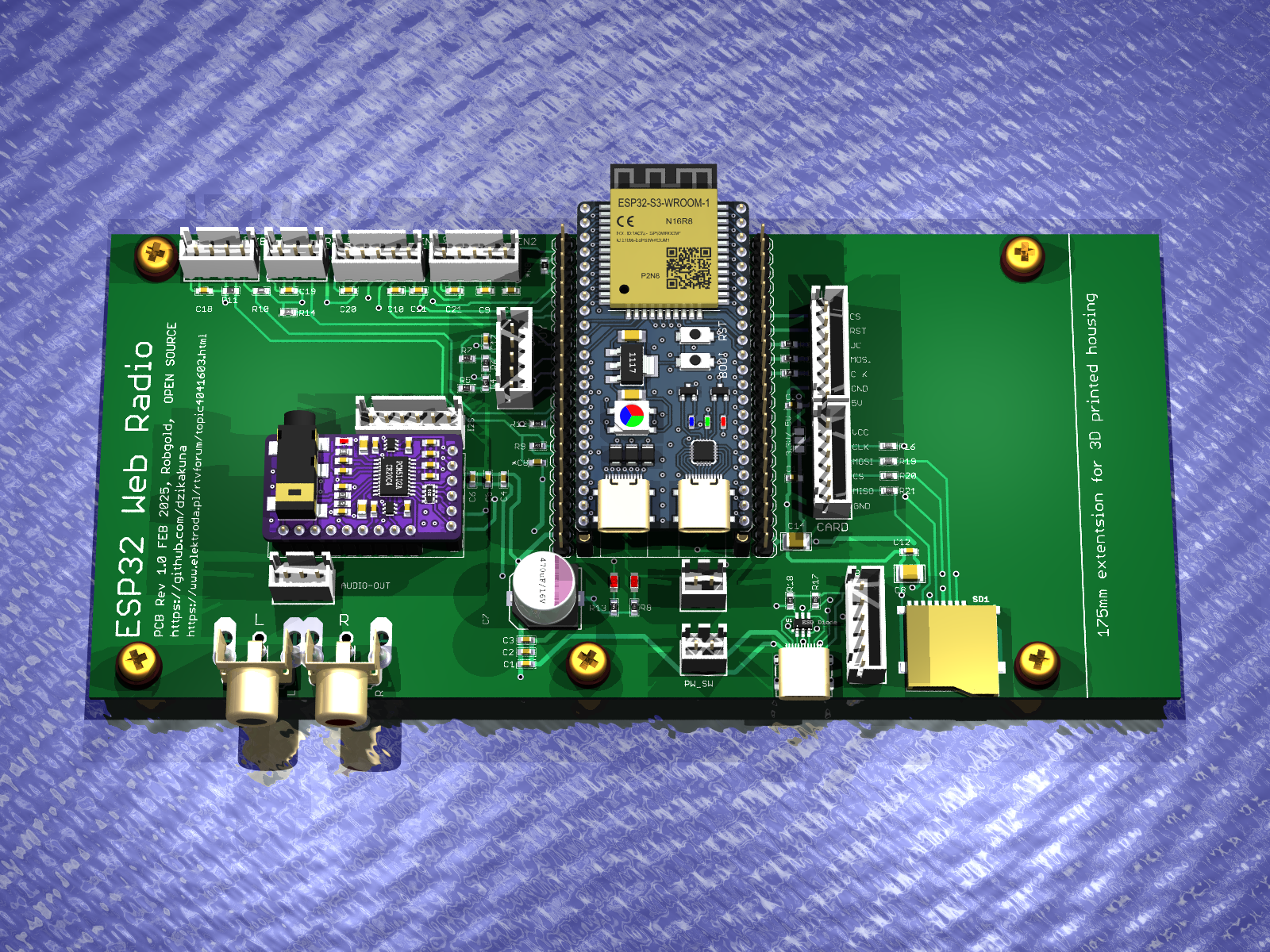

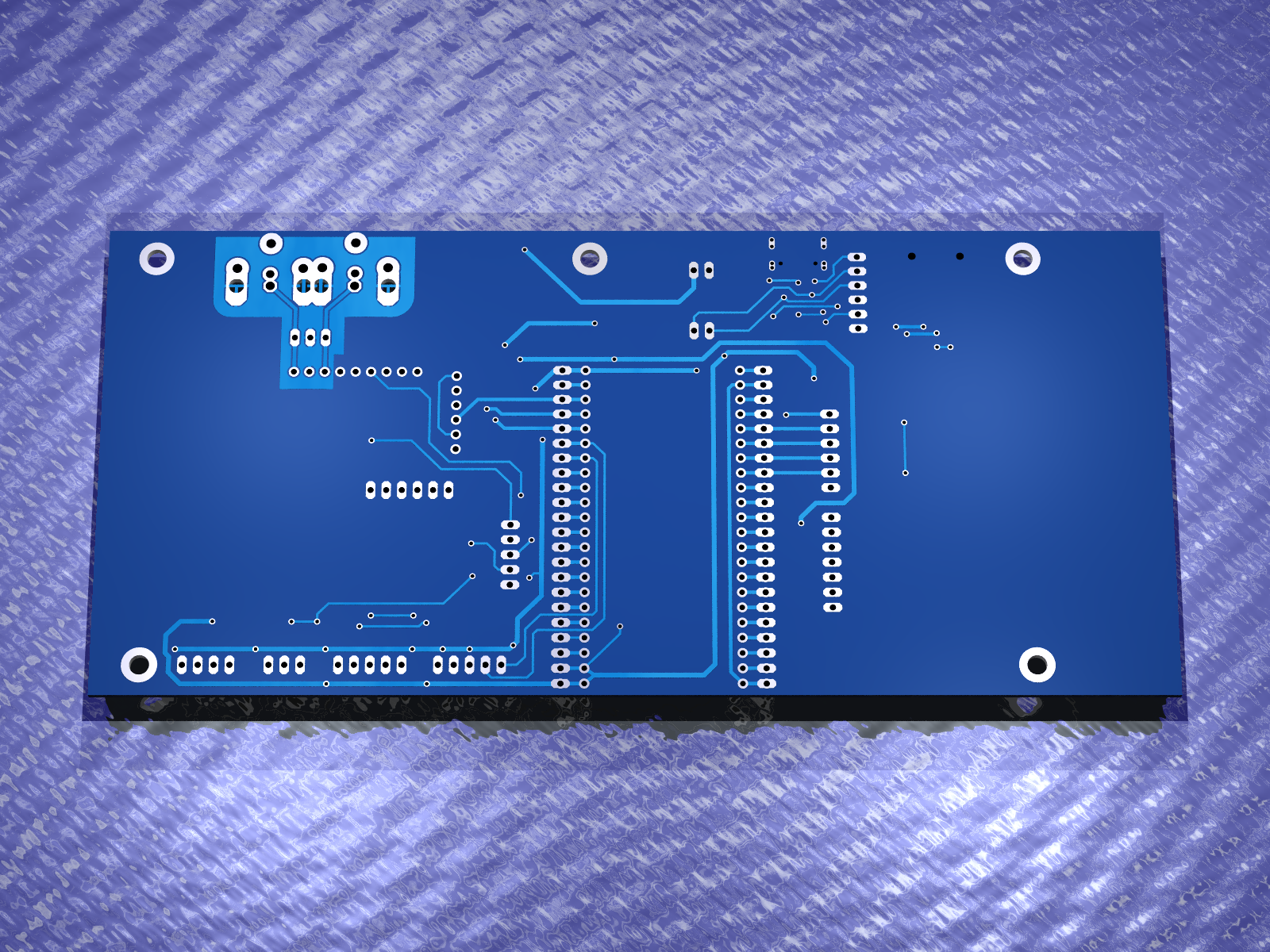

    New (old) renders
    Render of an ESP32 Web Radio board with various modules and components on a green background. .
    Render of a green printed circuit board (PCB) on a gray background. .
    Render of a PCB with various components on a gray background. .
    Rendered ESP32 Web Radio PCB on a gray background. .
    Green printed circuit board with connections on a gray background. .
    PCB colour and background (grey), in Hi-Res resolution
    Regards ...

    Hi - robgold you provided a link and I am using it but there files are from two days ago and when I open the BRD there are old versions of the chinch sockets.
    PCB schematic with audio-out connection and chinch sockets. .
    If this is what you ordered then these metal chinch sockets will not fit

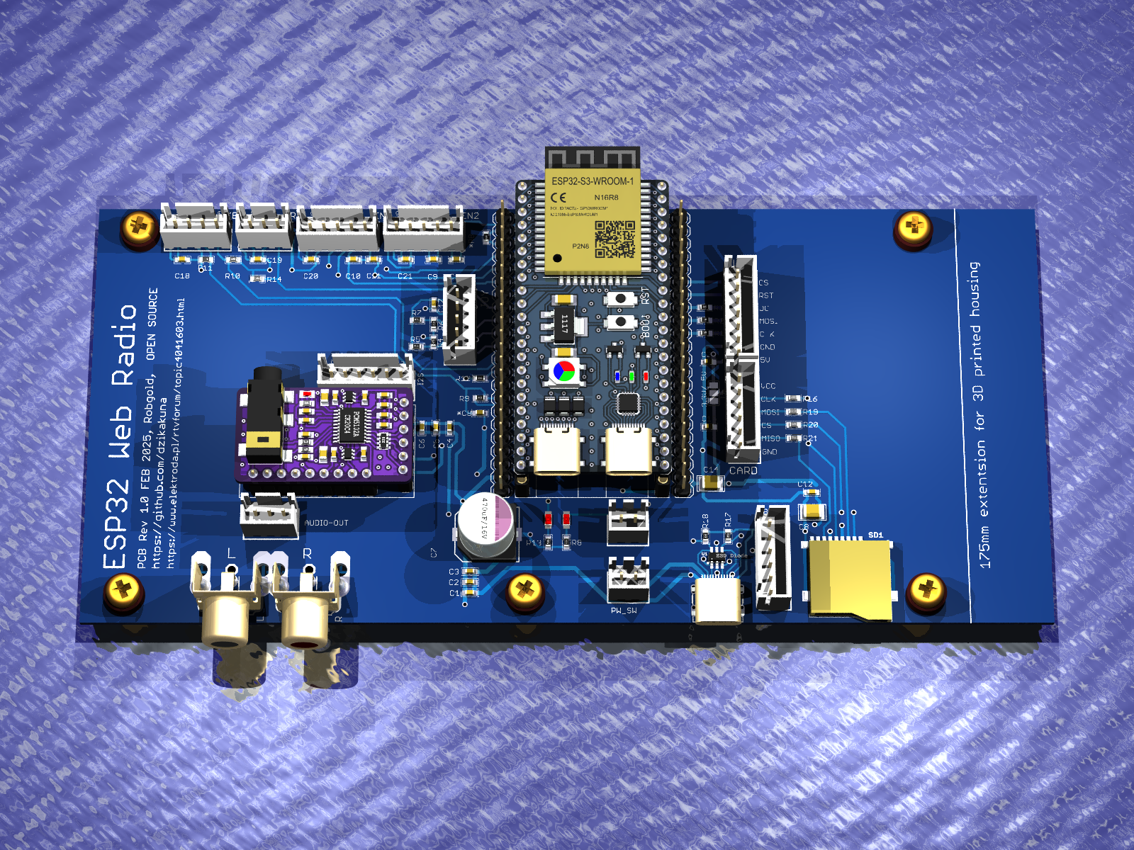

    Examples of PCB colours
    Green PCB with components for ESP32 Web Radio. .
    ESP32 Web Radio PCB with electronic components on a blue background. .
    PCB with an ESP32 module on a metallic surface. .
    Close-up of an ESP32 Web Radio PCB with various components and connectors. .

    @robgold I wouldn't push with those paths between the pads from the ESP32, you can safely switch outside the module and it will be more aesthetically pleasing and safe, you can even do without crossing those paths.
    Close-up of a green PCB with marked traces and solder points. .

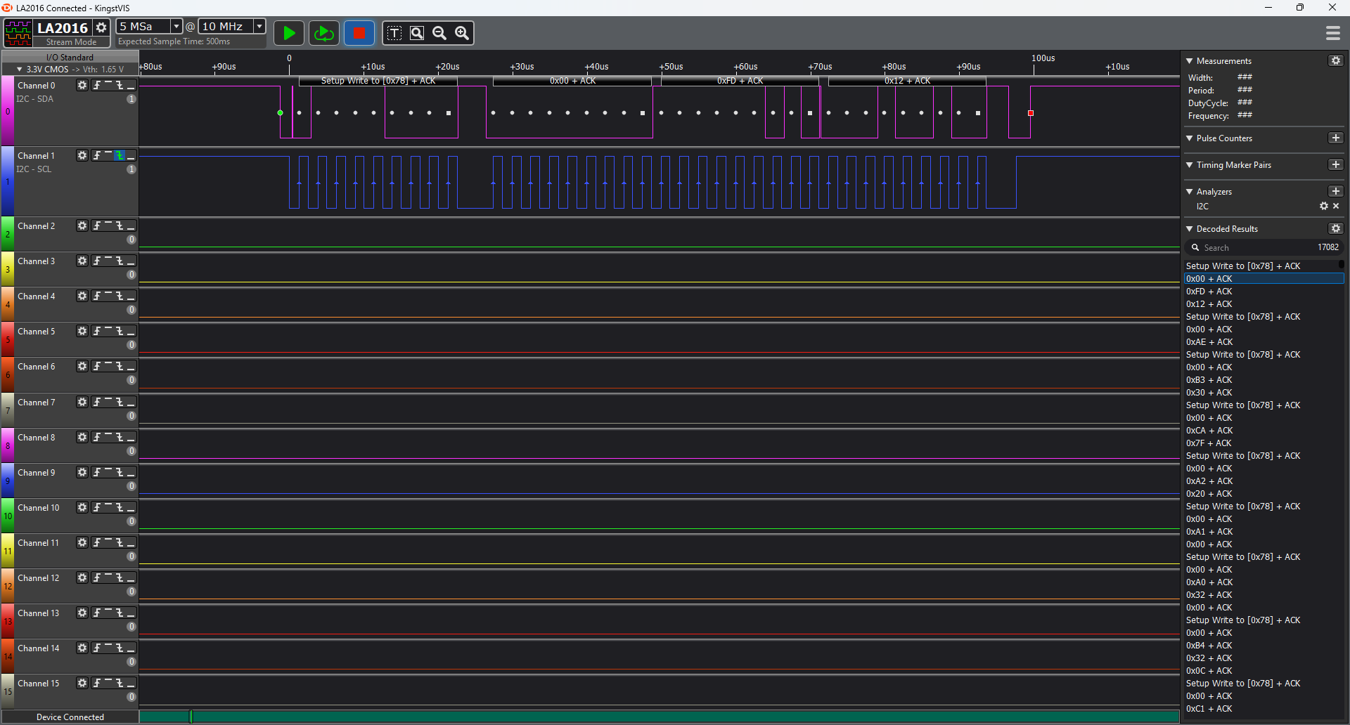

    In general I have a request to anyone who can help with figuring out the proper init and control of my new OLED display with the SSD1363 driver via the I2C bus, nice 256x128pix screen, but it looks like there are some babes in the library from this SSD1363.
    I have exactly the same problem as in this link, identical static noise on the screen:
    https://github.com/olikraus/u8g2/issues/2298
    My analyser shows communication, but in my opinion something is misaligned here:
    Logic analyzer application window showing I2C signals for OLED operation. .
