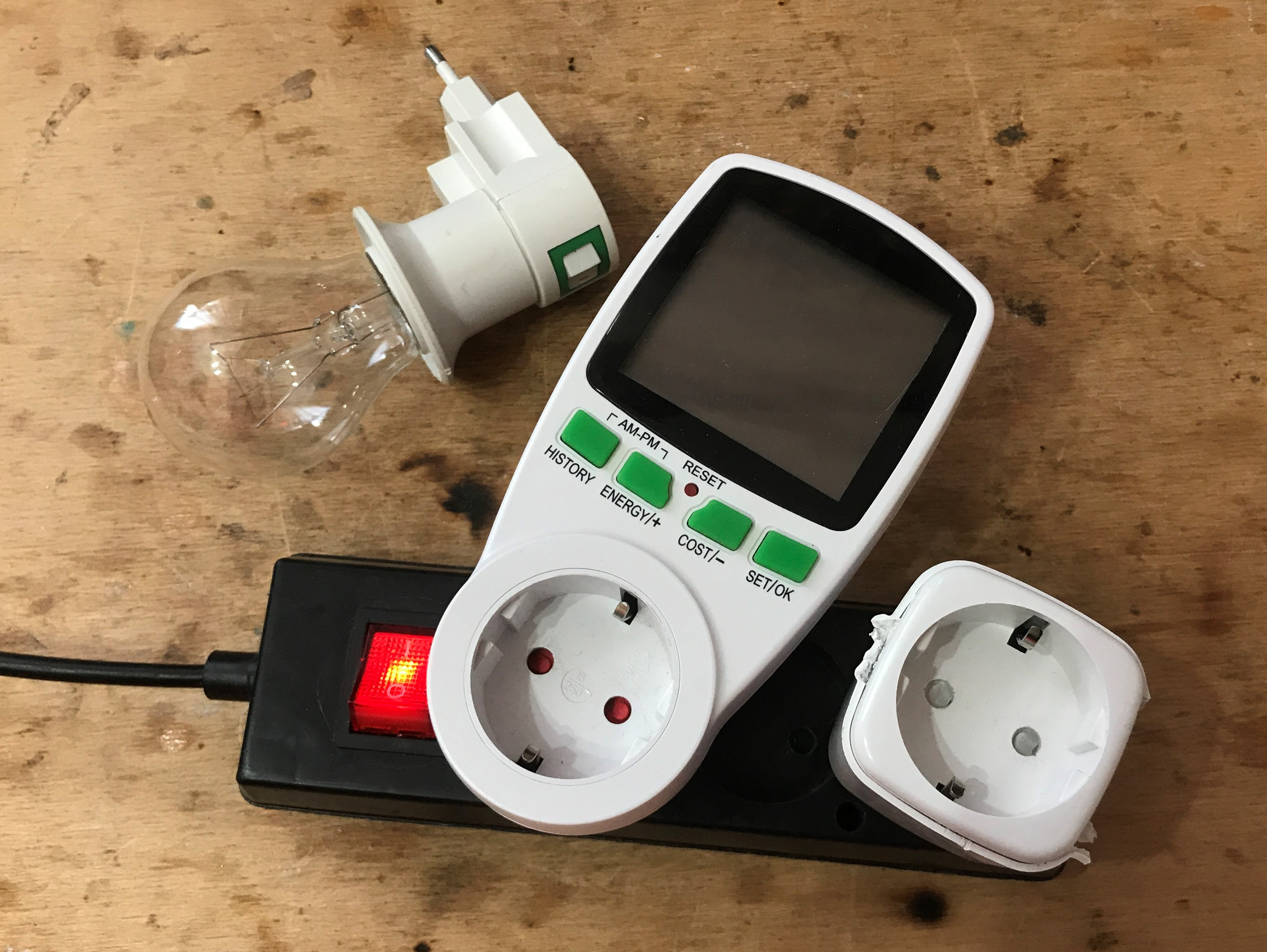

Measurements with no load, before calibration:
That voltage value is way too high! This is not acceptable. We need to calibrate.
The measurements of 60W bulb without calibration:
Again, those are wrong.
So, let's calibrate. Take a reliable power meter and measure how much in reality current and power the bulb consumes. Also write down the voltage in the socket. You will need that values later.
Now, move the plug to the OpenBeken socket and enable it (OpenBeken must be measuring the very same bulb when you do the calibration, the bulb must be on!).
Now, in the command line, type commends: VoltageSet [correntVoltageVal], CurrentSet [correntCurrentVal] i PowerSet [correntPowerVal], and write down the system replies (the correct calibration constants for your very device)
System replies:
So, write down that VREF = 15987.125000
PREF = -683.023987
IREF = 272302.687500
Refresh the page:
You can also recheck with resistor load:
Resistive load is good for doing double-check because you can easily calculate power for that (the cos phi is 1 while for inductive/capacitive load it is not).
2023 UPDATE - THOSE VALUES ARE NOW AUTOMATICALLY SAVED, NO AUTOEXEC.CFG NEEDED. Just use VotlageSet, etc, and it will be remembered by device, saved in flash, kept after reboot.

Quick 3-step power-calibration (BL0942)
  1. Plug a 60 W incandescent bulb.
  2. In Web‐App → Tools enter real 230 V, 0.26 A, 60 W.
  3. Click “Calibrate”. OBK stores constants and restarts driver [Elektroda, Wimmi, post #20957896]
