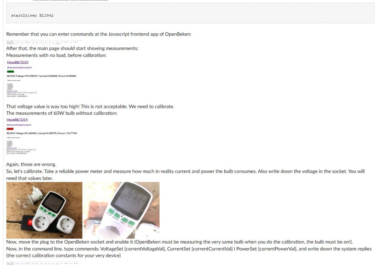

    I have a similar socket as described here https://www.elektroda.com/rtvforum/topic3887748-150.html#20585167
    and I flashed it successfully but my current and power values are jumping around all over the place. Watts goes from 15 to 3255 and back. also sometimes it switches off itself even when HA shows it on.
    I did not set it up exactly as described in the first post here but instead used the flasher option to write OBK config, aso webapp now has calibration utility so everything should be OK .
    What do I miss here?

    Hello @minusync , can you post here your Tuya config?
    https://www.youtube.com/watch?v=WunlqIMAdgw
    Also, please post your OBK JSON template from the Web App.
    Futhermore, did you calibrate your device correctly with some load like 60W bulb?
    https://www.youtube.com/watch?v=WunlqIMAdgwAlso, please post your OBK JSON template from the Web App.
    I have already converted it to OB so the only thing I can give is a backup bin file.
    I think the only difference in my pin setup is a button in pin10, if I remember correctly in your setup button was 11
    Also, I did try to calibrate with 15w bulb but even with completely wrong calibration, it should simply give me consistently wrong readings not jumping all around.

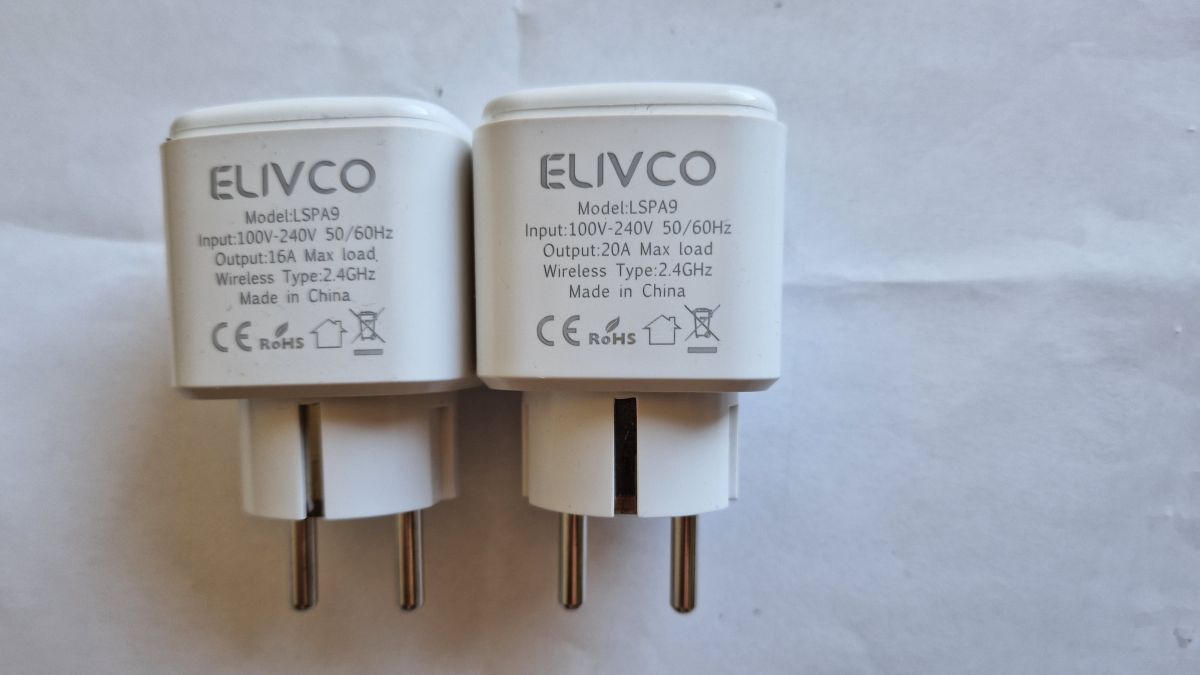

    Bought some cheap sockets from AliExpress Elivco store (in March 2023), with the intention to cut from the cloud.
    These 2 are 16A/20A LSPA9.
    Tuya LSPA9 smart socket - teardown, OpenBeken flashing guide for CB2S, BL0942
    They have firmware V1.1.8, and so BK7231N chip. Flashed with cloudcutter. Config is same for both:

    Just noticed, not all the above sockets as two leds, these have two, red for wifi, blue for ON, when both are on looks nice magenta color.

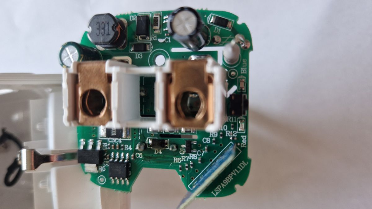

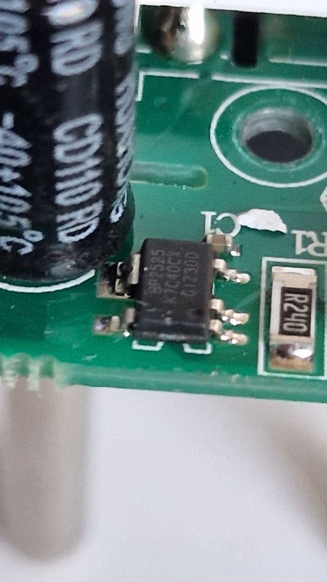

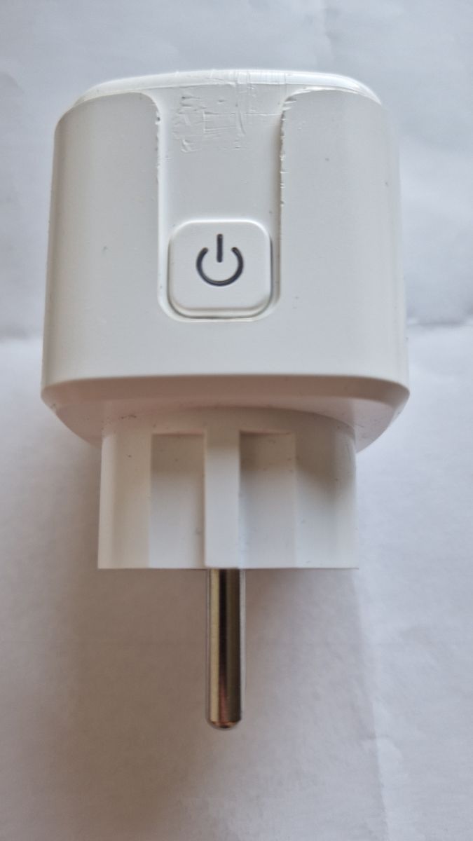

    Here is teardown of historical LSPA9 socket, which I bought in 2021 with hope to flash with tuya-convert. But was not able too.
    It has no markings on the case:
    Front panel view of a smart electrical plug with a power button.
    Pcb is mostly the same, it actually has LSPA9 marking, but lacks MOV compared to the modern ones.
    Close-up of the PCB of an electrical device with the marking LSPA9BPV1.1DL.

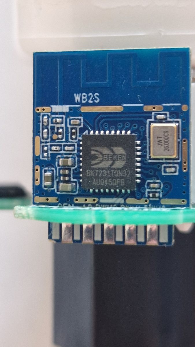

    Show is run by BK7231T this time:
    Close-up of a PCB module with WB2S marking and Beken BK7231T chip.
    It contains the usual BP2525 power supply chip, which runs on 5V for relay
    Close-up of electronic components on a PCB, including a chip labeled BP2525.

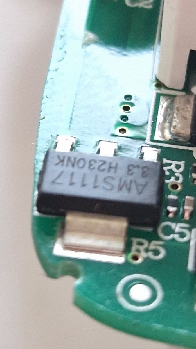

    So it needs 3.3V regulator for the chip
    Close-up of a component labeled AMS1117 3.3 H230NK on a circuit board.

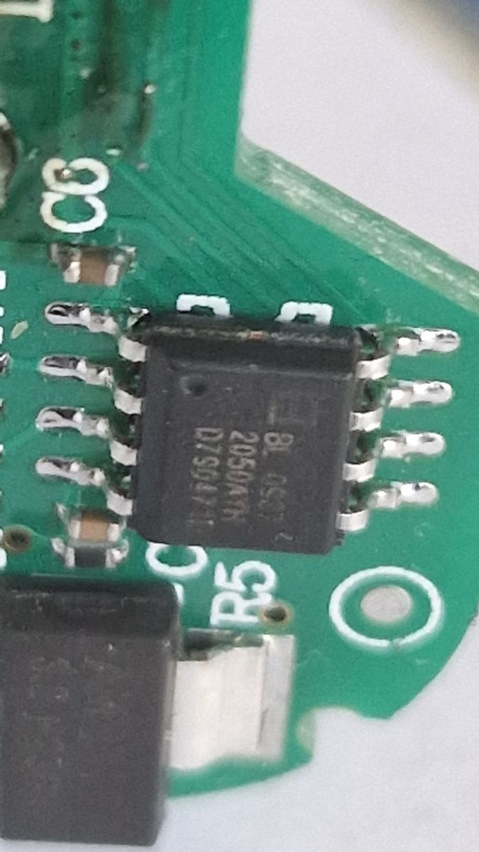

    And faintly marked BL0937 for power monitoring
    Close-up of a circuit board with a BL0937 chip on a green background.

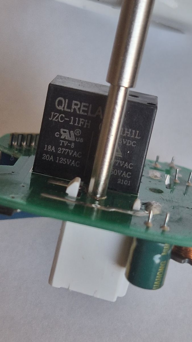

    Relay is 5V
    Close-up of a PCB with a relay marked QLRELAY JZC-11FH.
    I wonder why they did not use 3 volt relay and 3.3V BP2525, would save one component.
    It has tuya V1.0.3 firmware, I did not try to flash it.

    As indicated in the first post, you need to calibrate according to a stable load and a meter that you trust.
    The author of the topic used a 60 watt lamp.

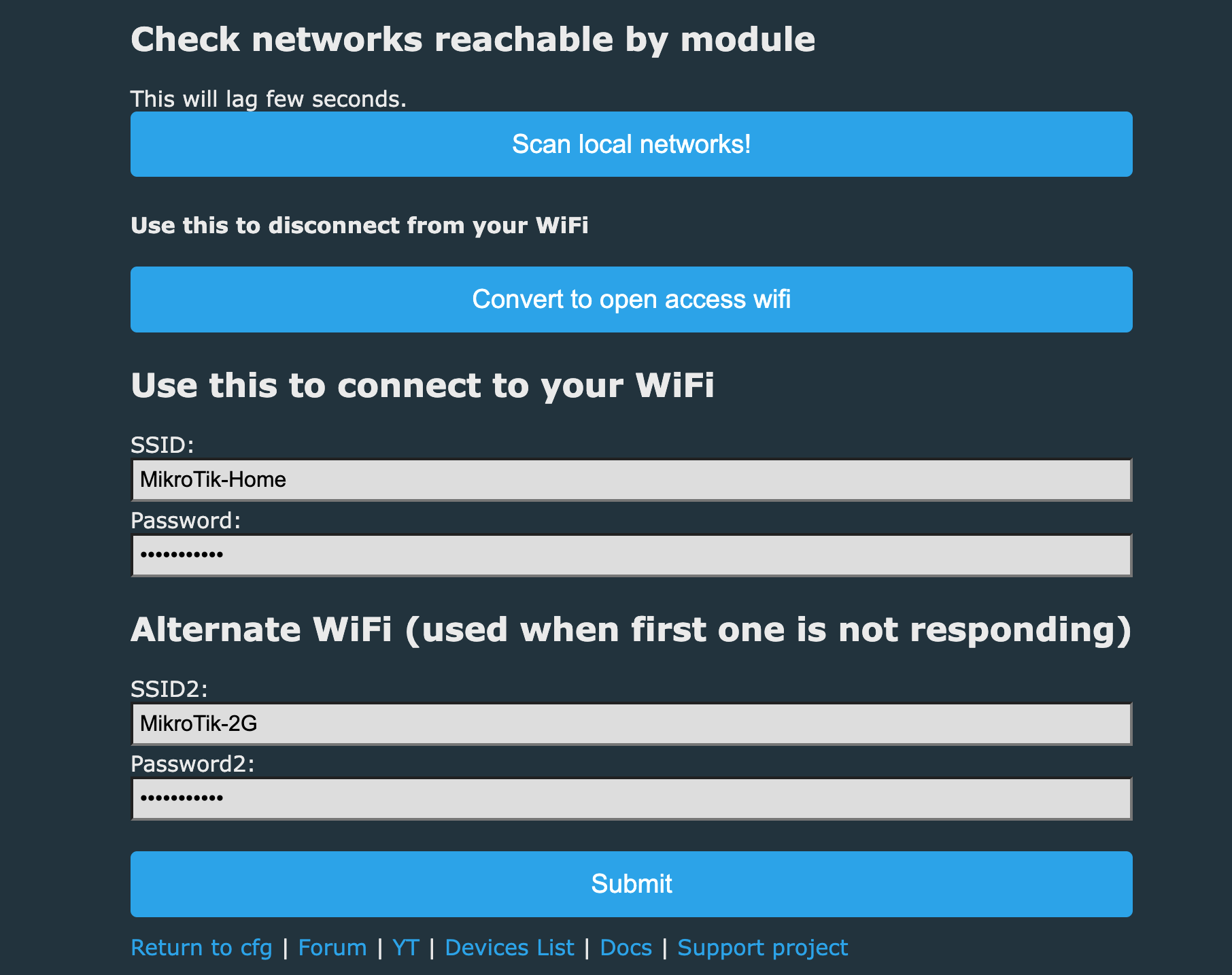

    rakalexei
    Posts: 21
    @p.kaczmarek2 Good day, I faced the issue with switching between wifi ssid.
    User interface for managing Wi-Fi connections with two SSID fields and buttons.
    I did some tests. It can successfully connect to each wifi ssid, but only when it's a first ssid. So basically it never switched to a second ssid if the first one failed.
    P.S. I'm on version 1.17.262
  • #207 20754561
    Posts: 14677
    Help: 656
    Rate: 12703
    To the best of my knowledge this feature is currently a stub, we have a GUI but it's missing the implementation. I may find time soon to finish it.
